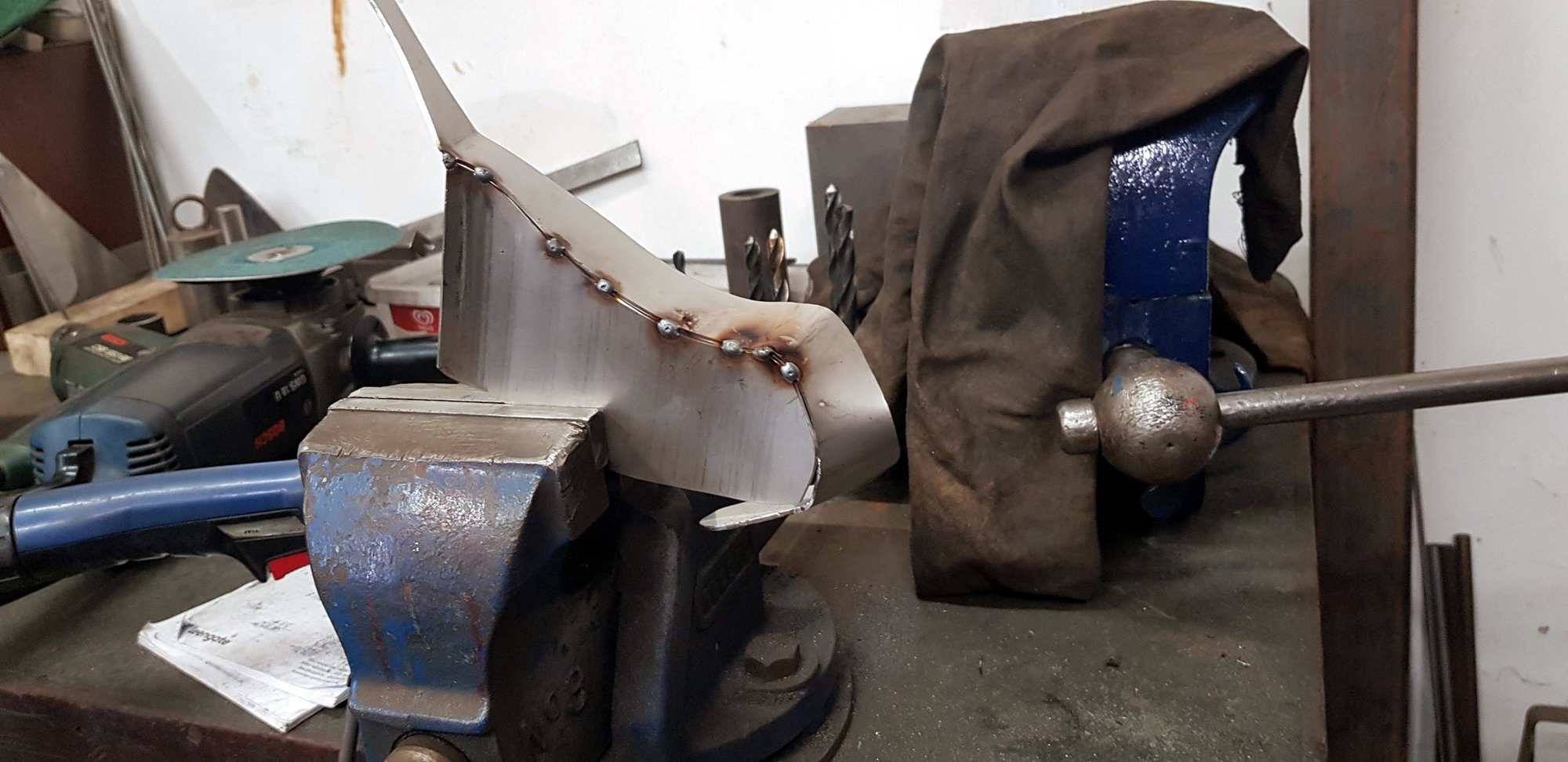

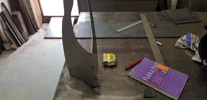

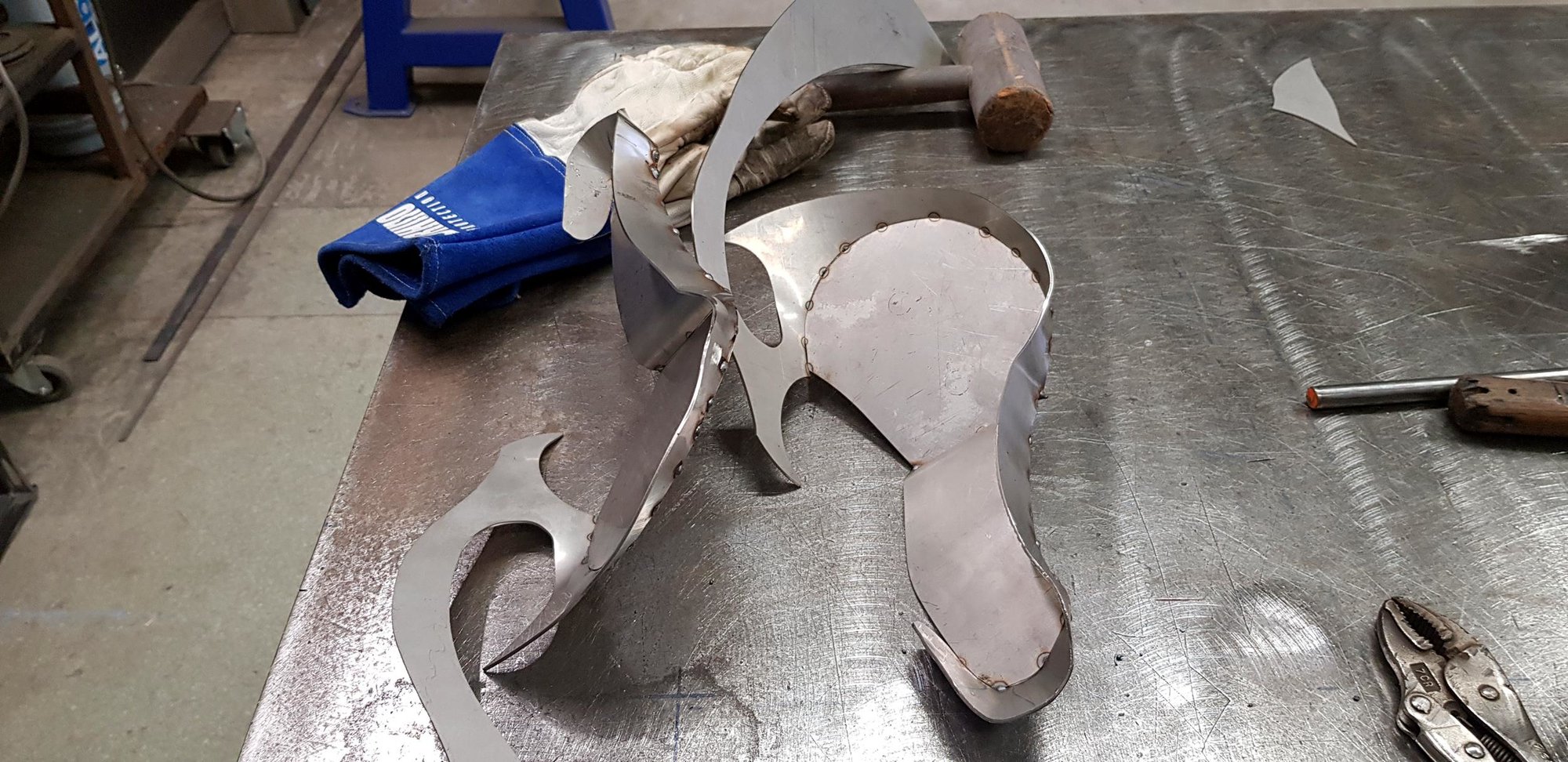

Well, as @Chillitt correctly identified, I have a set of cutouts of the Delisle Horses Head. It has cost me, including the .dxf files, all in: £80 to have everything I need to get started with the build in 1.5mm stainless. We have a very good Laser profiling place just up the road and it took just a week from sending them the files to getting a call saying the bits were ready.
I was building the Financial Controller "something" and when someone said there was a sculpture by a chap by the name of De Lisle, well for obvious reasons (to me) I was intrigued, I know of a Godfrey De Lisle and I would suspect a relationship somewhere in the family, I will ask.

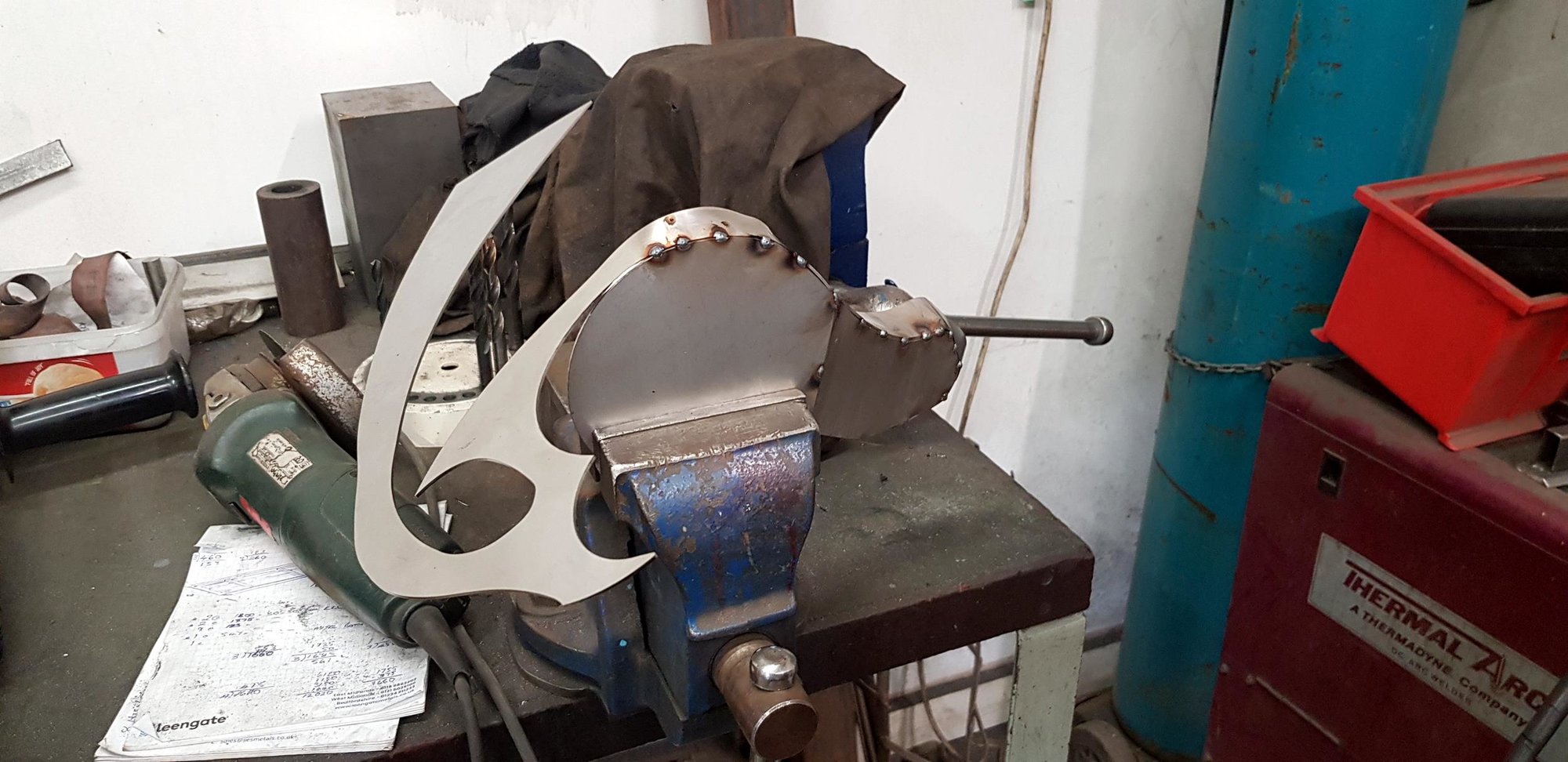

Anyhow, I have been staring at the bits for a week or so and just decided to make a start, I took the bits off over to my pals place as I knew I would need a bit of help and I was right. There are two build video's on youtube, one by Delisle himself and another, it is not immediately obvious from either video how this all goes together and I would suggest that some of the details are rather lacking, but this is not something Mission Critical and the phrase "Artistic License" springs to mind, I have an Angle Grinder so where's the problem, right? :-)
Purists look away now, I tacked it up with mild steel wire, I will tig the seams later and dig the MS out:

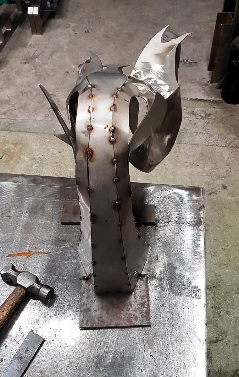

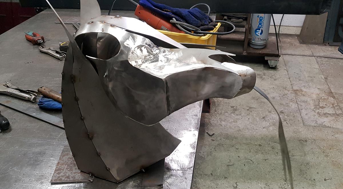

I am a little bit further on than this but not by much and I will get some seams tigged up next then try putting the two bits together. One thing to note, the bits are slightly different to those shown in the Delisle video, especially around the nose so that was a bit of a puzzle.
