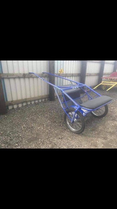

I said that but regardless he wants me to build oneTBH, a practice cart like this is cheap enough S/H on the bay. Don't see how you would make it any cheaper. First one I came across: https://www.ebay.co.uk/itm/Pony-Hor...694789?hash=item3fc9b00185:g:lC0AAOSwIYtdVGhM
That's a trotter cart in the photo.
Normally used by the types that race up and down the local bypass for cash stakes.
Budget for some brakes on it.
Also, put some uprisers on the front of the draw legs so if the harness snaps the front dont drop and dig into the road and flip it over.
If it's for a actuall friend rather than just for cash make a couple of break points in the rails so you (the emergency services) can take it apart with only an adjustable spanner when it's all twisted up in a ditch by the side of a busy road.
