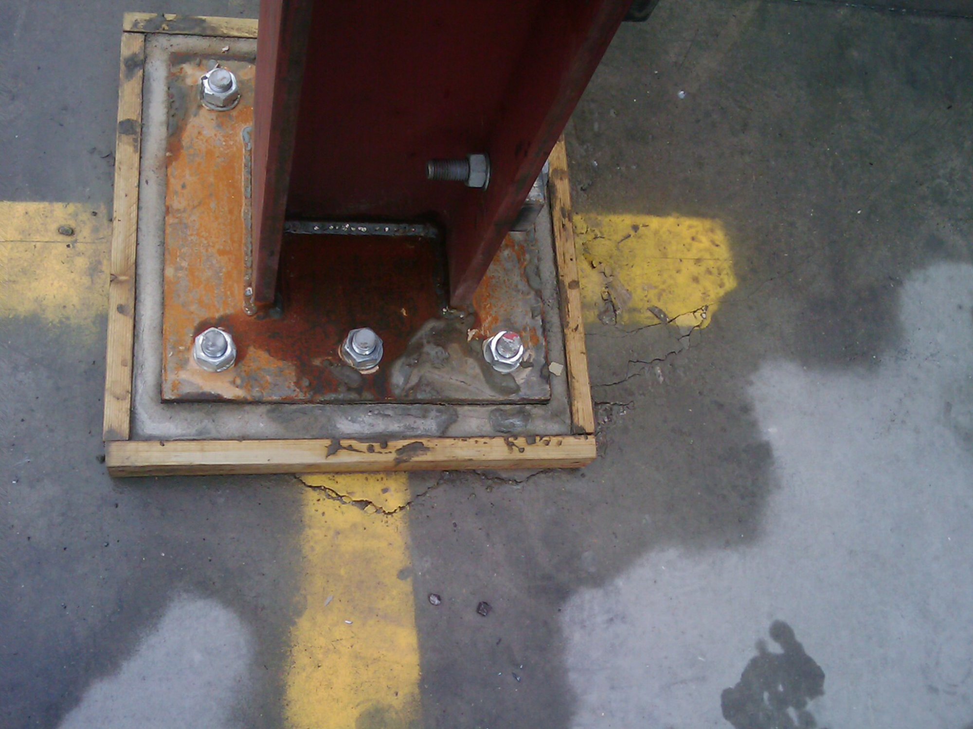

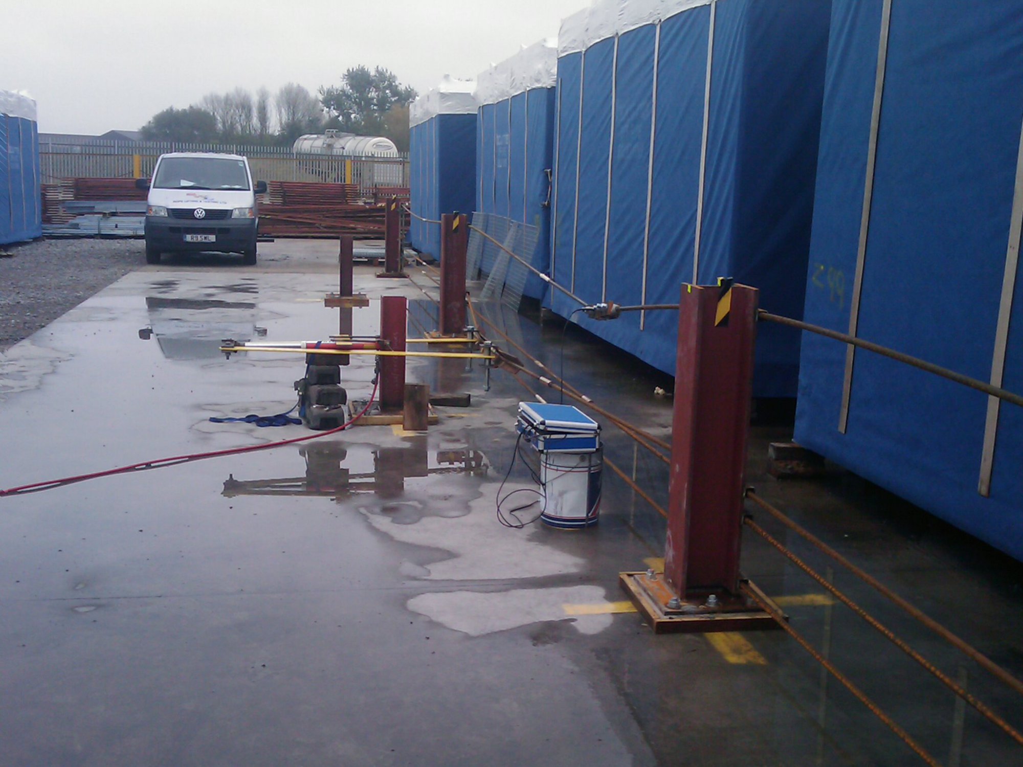

@Kent not had any pull out and the first ones been in a year nearly. No different to using threaded bar with a nut as long as it's down flat to the wall top or whatever. I've used ratchet straps to hold say a handrail down hard. I normally do the usual plate with holes for the studs and then a nut on top to pull tight.
