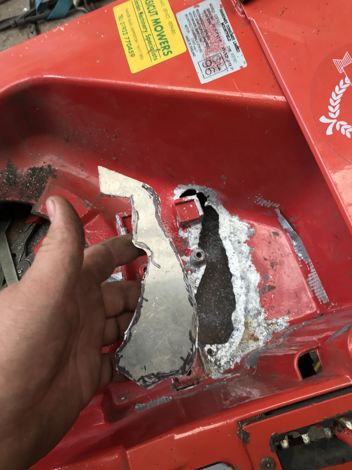

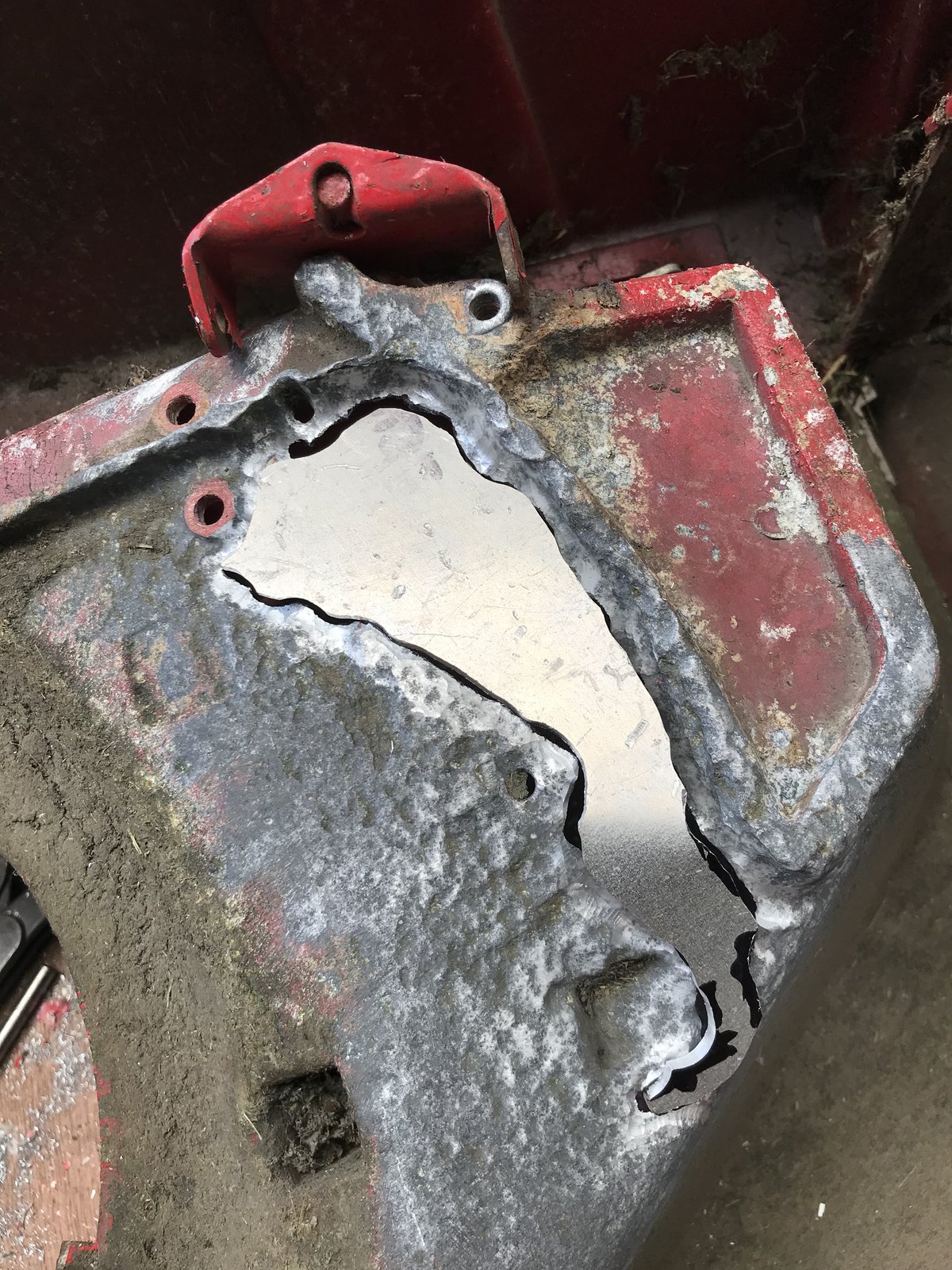

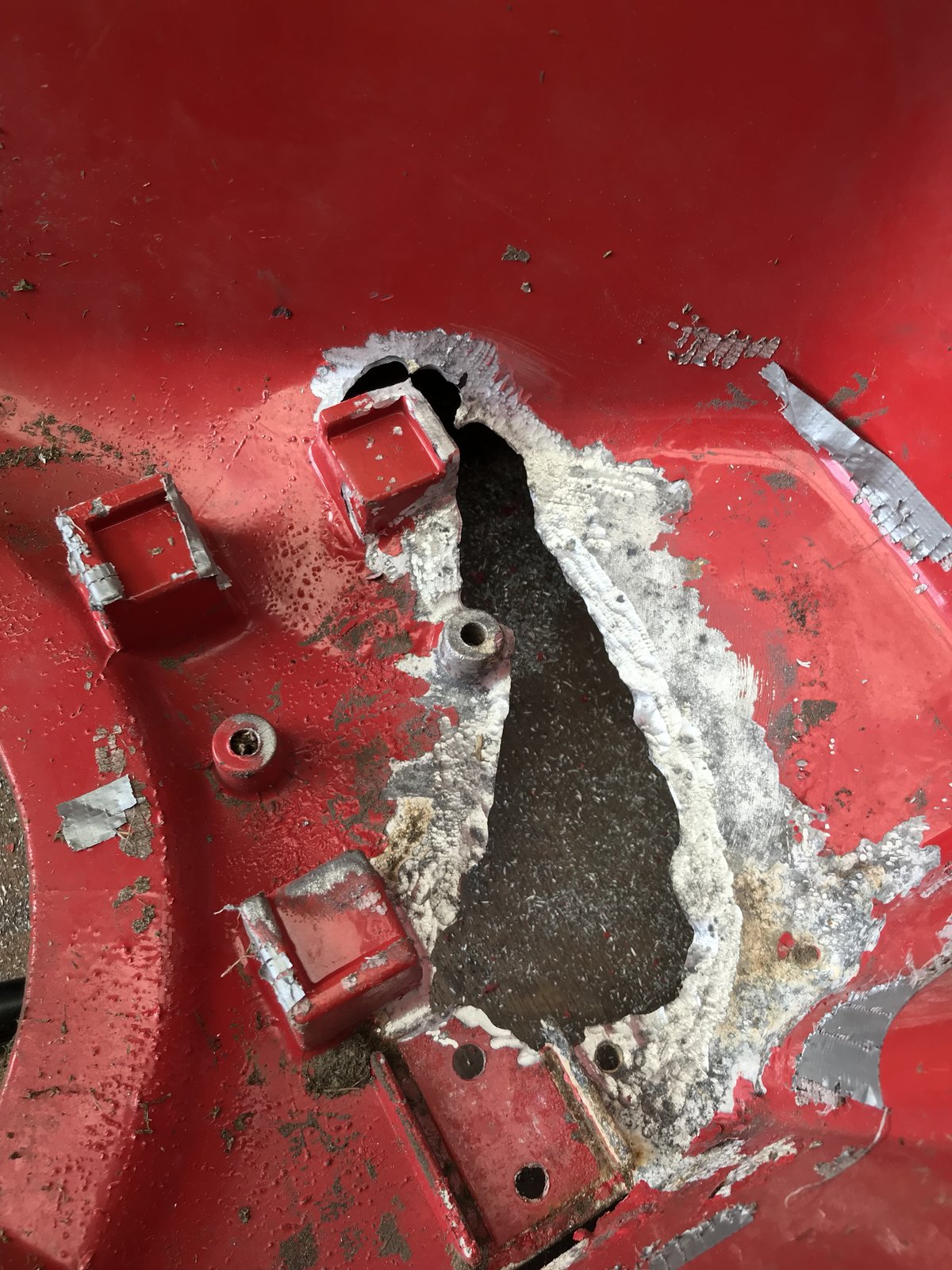

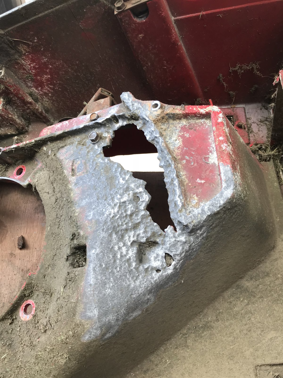

So, My lovely missus signed me up to repair her dads lawnmower.
Bit of sheet metal to screw on he said.

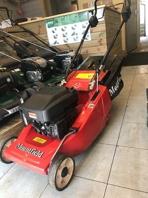

It’s one of these. Cast aluminium deck.

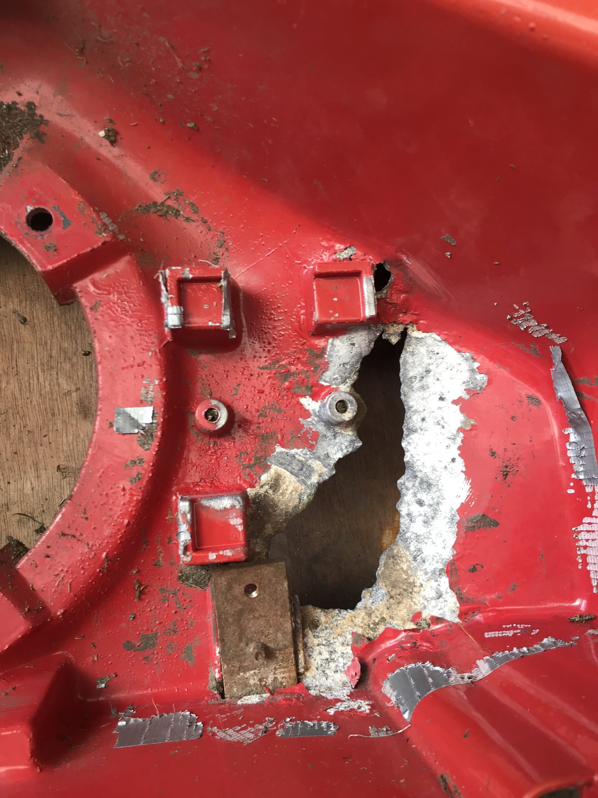

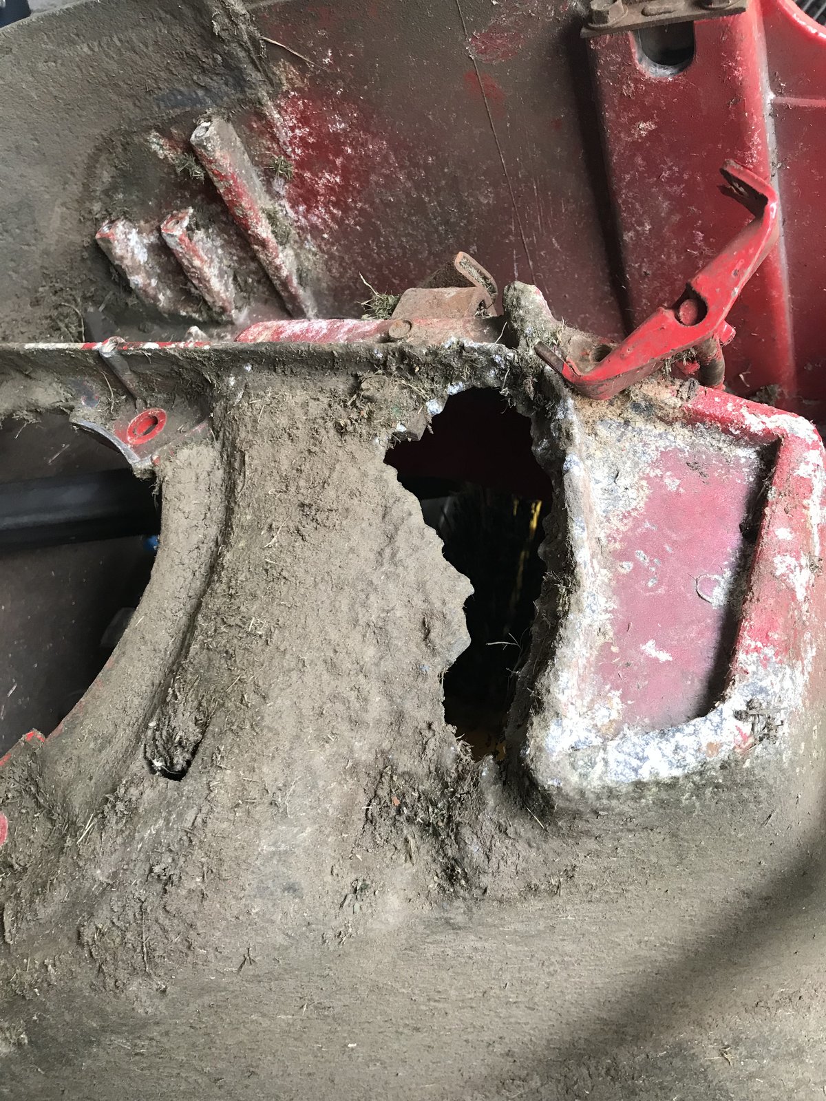

So I goes and picks it up. Massive hole loads of rot from the grass that gets stuck in there.
So it begins. Strip the poxy thing down takes an hour.

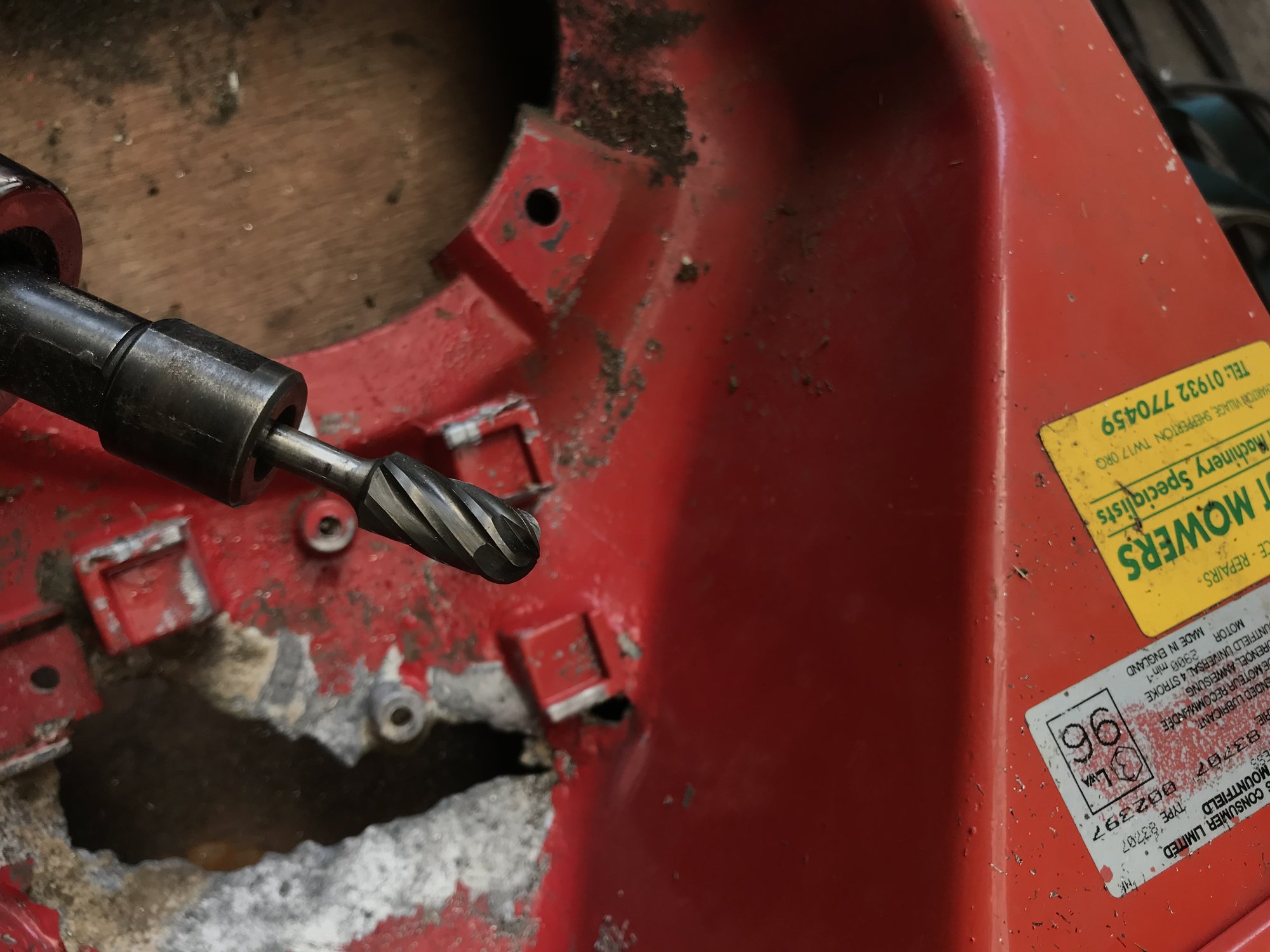

Wire wheel exposes more holes.

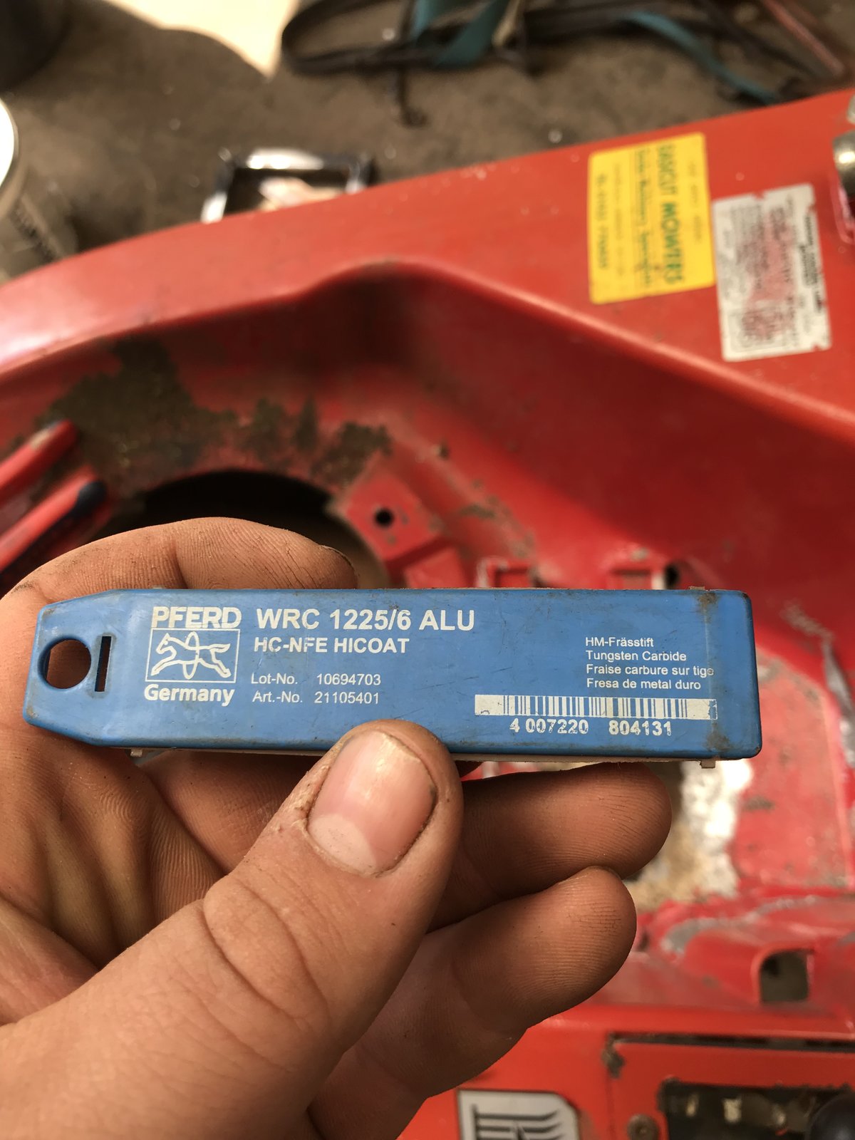

Getting the vicious Pferd burrs out.

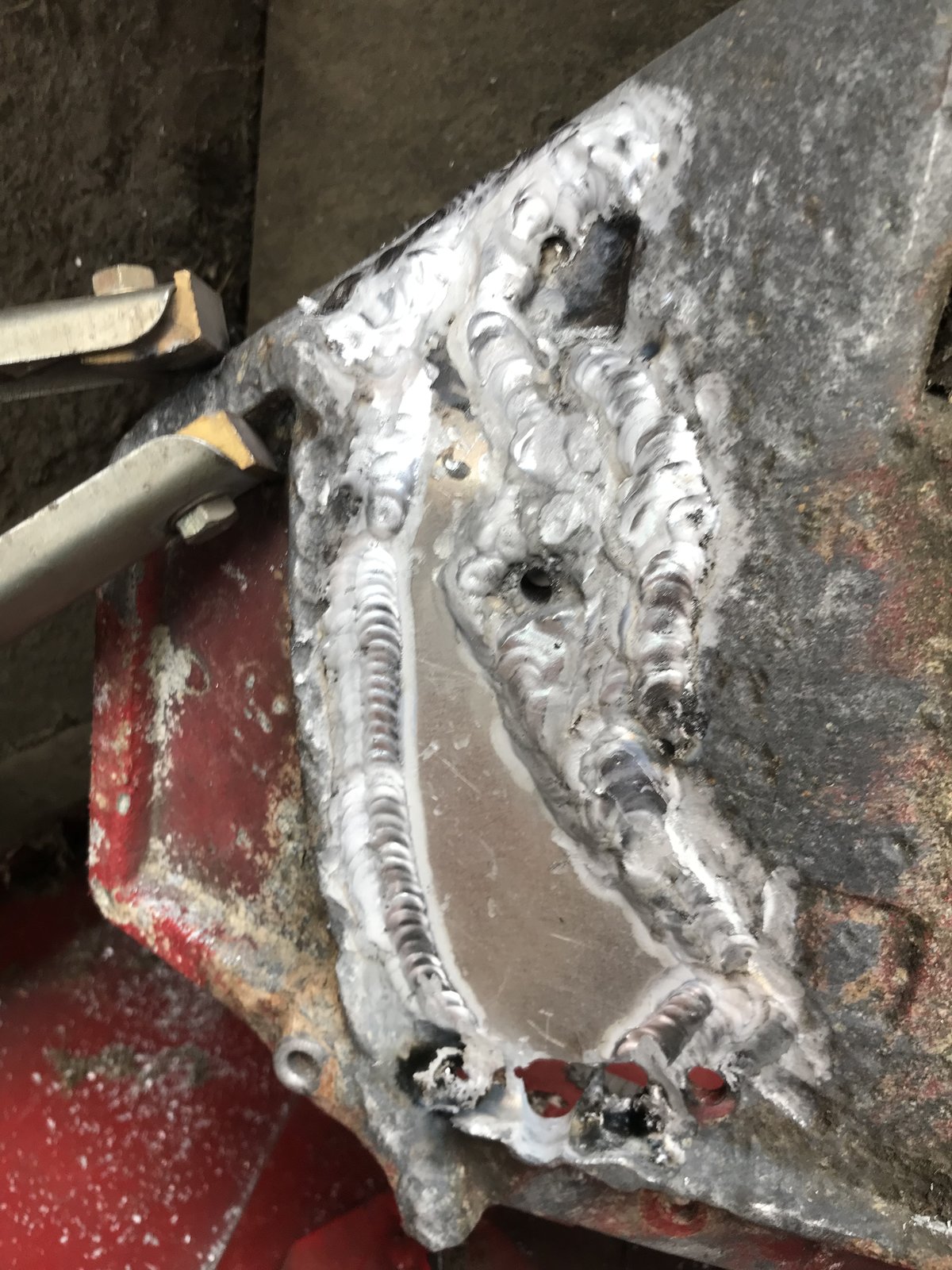

Where it’s at now.
