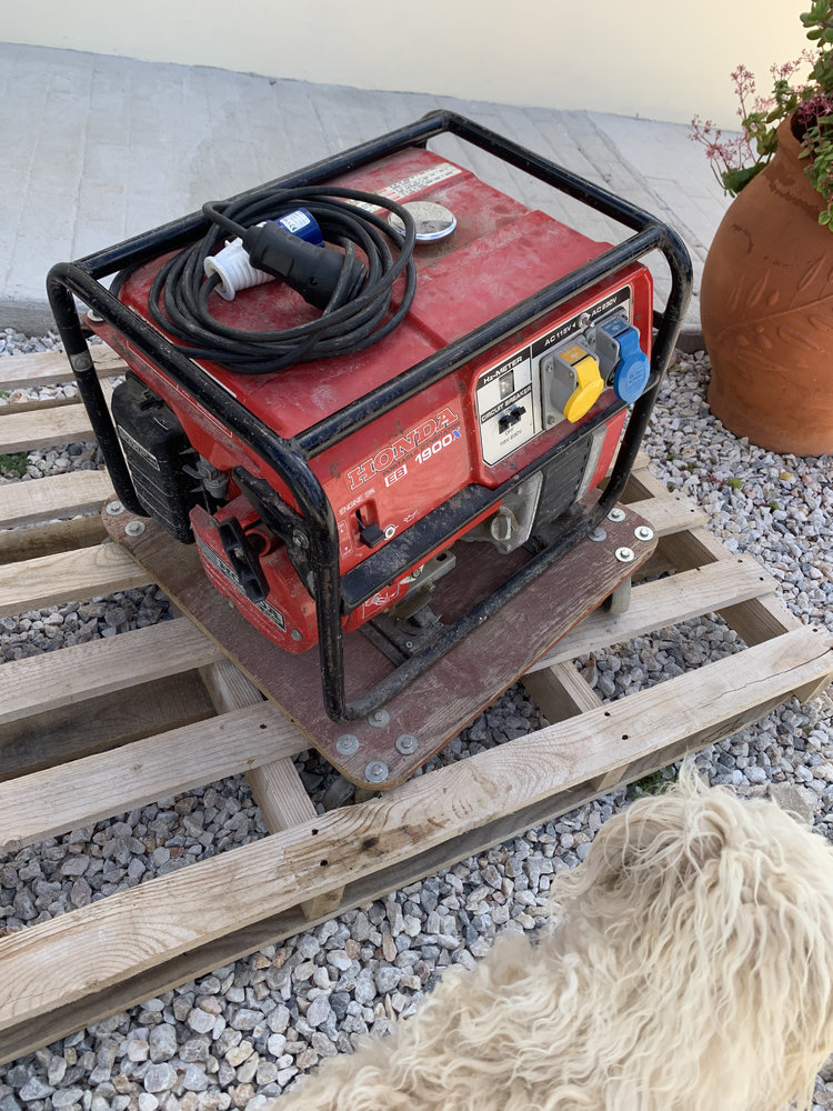

I need an elecrical spare part for this old Honda EB1900X genny.....it's I guess the voltage regulator thingy that switches on the generator.....
no output either voltage socket, well 3 volts on a multi meter via the 240v output cable.....
ps had the socket cover off and no loose wires in there either....
brushes are like new and not stuck in the holders.....the com is clean and shiney.....
abslutley no smell of burning or loose wires that I can see.....
the engine starts first time everytime......burns no oil.....
been trying for ages but so far, either no reply or it's to old.....!!!!!!
As u can see it's not done a lot of work, it's just for the house as a standby....
I've prob had it for 20 years....I know it's old but seems a shame to junk it for an electronic board....
any recomendations whom to ask.....?
thanks.....
PS tried to get it fixed here but nobody will touch it.....engines, yes but not the genny......grrrrr....that was a Honda specialist dealer.....
found out it didn't work when we had a power cut ....ta.........
