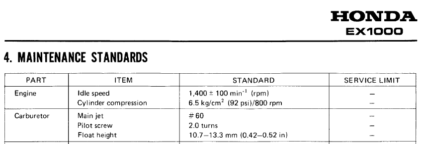

iforgot i even had it i bought a tool box 3 years ago and it was in one of the drawers never had a reason to use as of yet

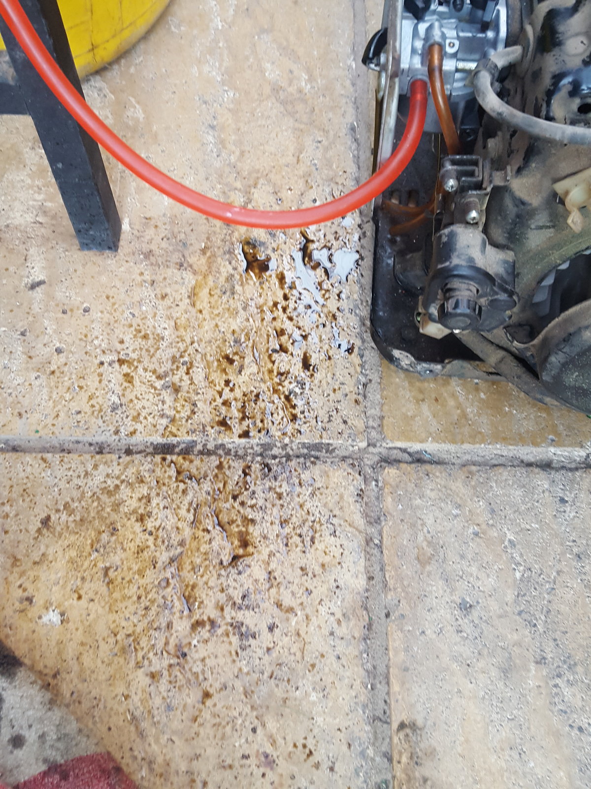

any how so 90 psi is fair for the mechine then could there be anything with the rods to let oil being thrown out the breather pipe ?
is there any way of testing if theres more pressure if theres enough pressure to pump oil out the breather pipe
