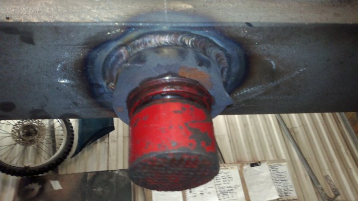

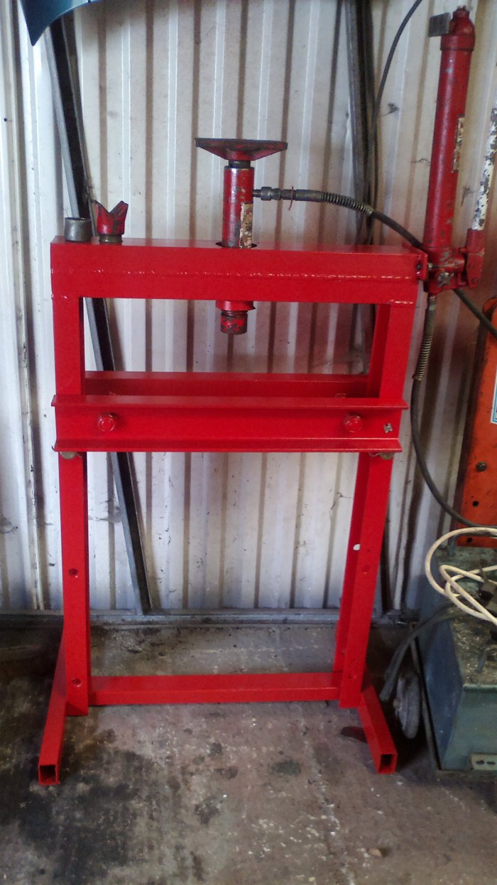

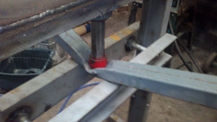

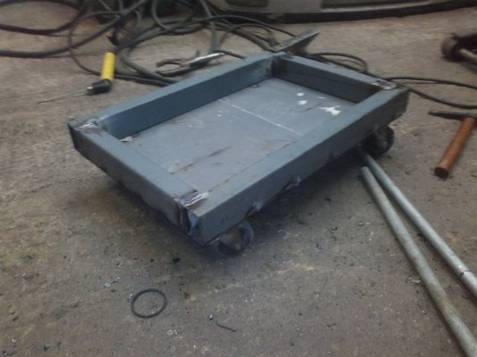

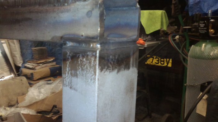

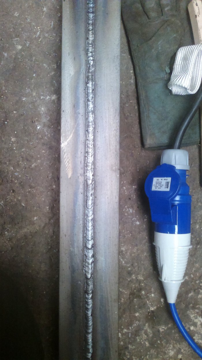

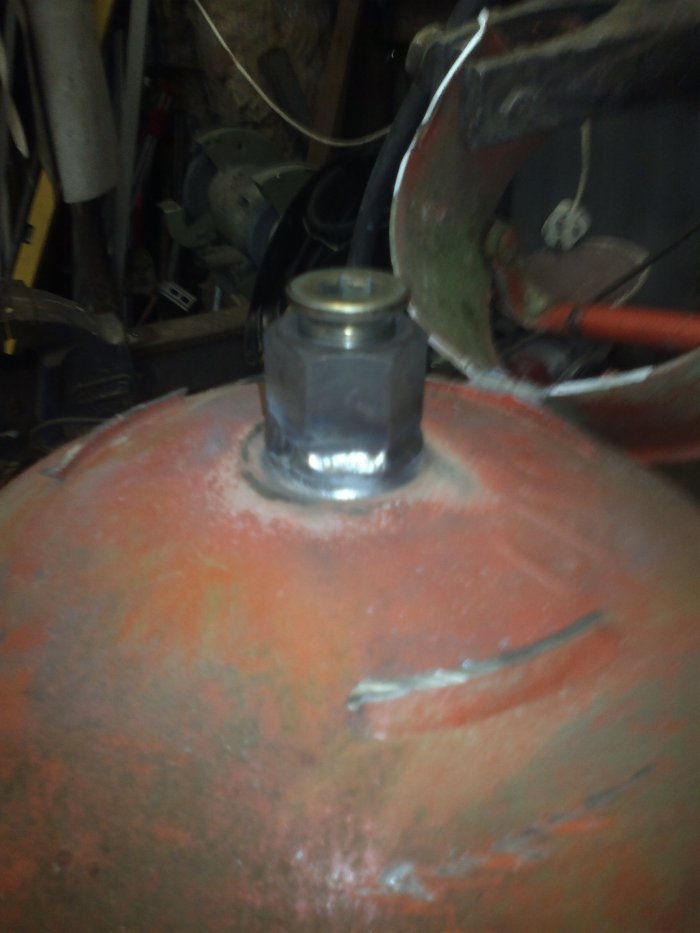

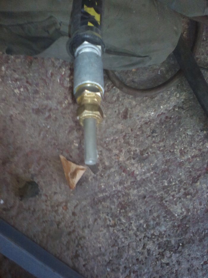

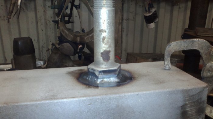

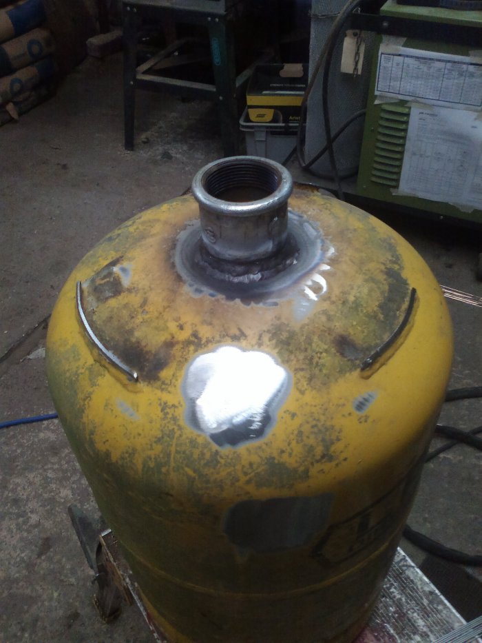

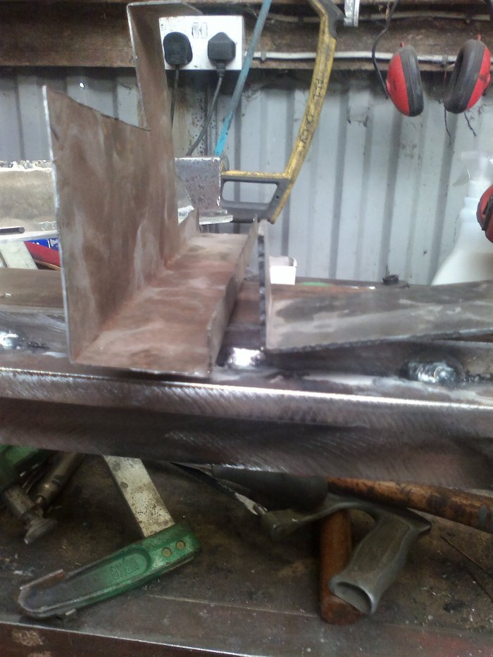

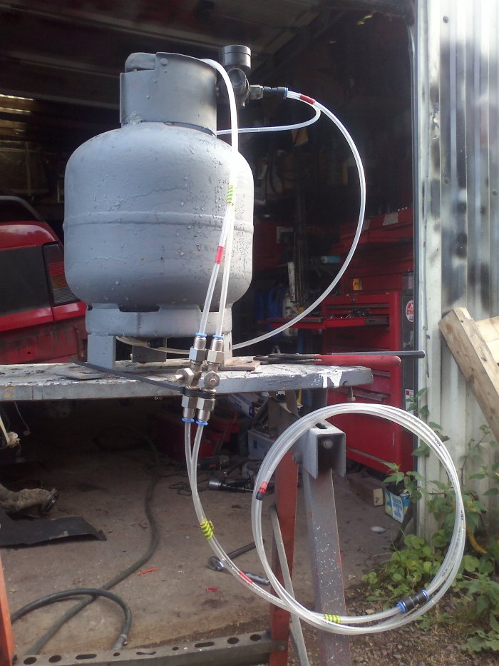

Here is some of the stuff I've been making over the last few months, all just to make life easier, practice with the tig and just have some fun
Started off with hydraulic press, I had the porta power and steel C section all ready and waiting for several years. But time and motivation were lacking, as is always the case.

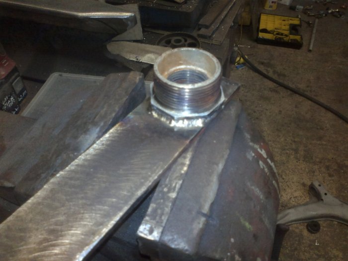

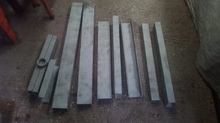

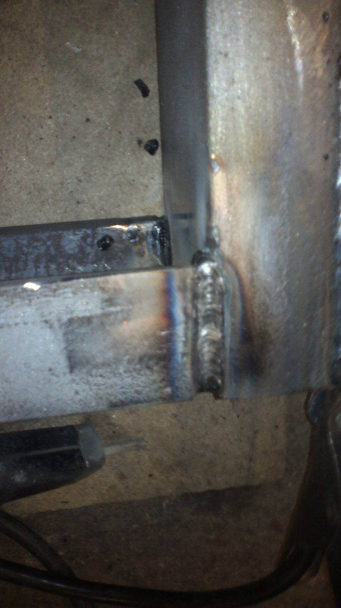

Started with chopping it all up and blasting it at work, the V'd the joints and tig root and 3.2mm 7016 Comets for fill and cap. I was a little rusty with the sticks in all honesty. I used some M30 bolts to hold the side's of the table together, with a nut each side so I can split the table off if needed. Then zinc primed and some celly postbox red I had kicking around.
