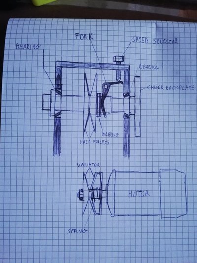

Back here with ideas.
Found a Facebook group entirely dedicated to homemade lathes , milling machines , shapers etc .
I've googled "homemade Norton geartrain " and found @gaz1 's thread about something like that.
Now just wondering about , I'm sure to be able to make a simple lathe without to much difficult.
Once done I think that I could be able to make something similar to a Norton box using chains and sprockets .
Using an M20 2.5mm all threads as lead screw .

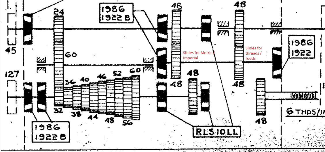

If you arrange the gearbox so you can drive either of the shafts and the leadscrew can be powered by either shaft you can go between length/turn and turn/length (metric and imperial) with only one or two changes in the drive from the spindle -
