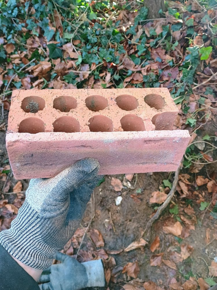

I have a fairly immediate need of 6 knurled inserts in stainless to take an M12 bolt. To be resin fixed into brickwork. Not particularly structurally critical, the bolts will be in shear. The brickwork will be drilled carefully, (non hammer) with a grit edged hole saw, 2mm oversize, then the insert resin fixed in.

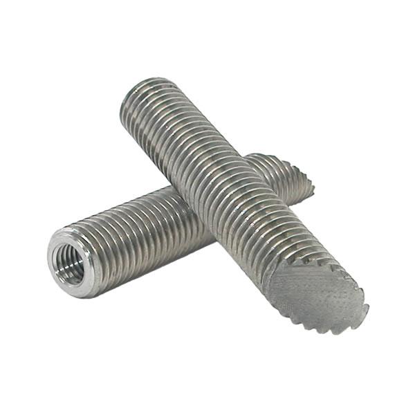

Something like this but I don't want to really a) wait and b) pay £7.36 each. These are allegedly M12x25 to go in a 22 mm hole
a typo I presume, they must I guess be made from M20 stud.
I can likely find some M16 stainless studding here, I've certainly no M20 or M24.

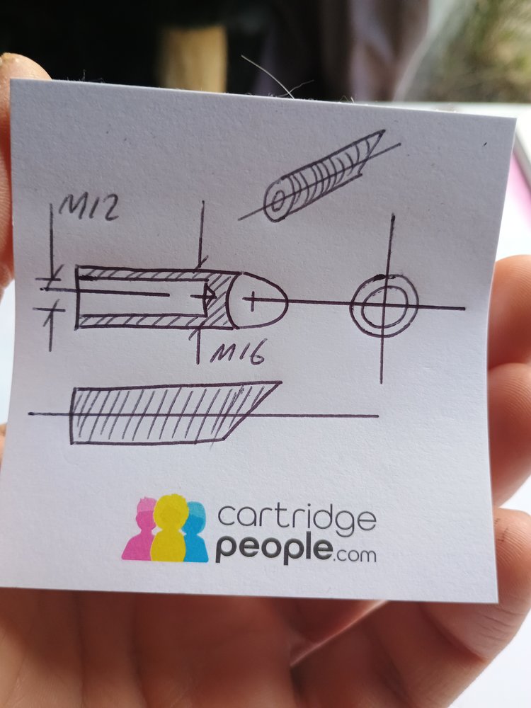

I can probably get access to the BiL's lathe. So centre drill, drill out to 10.2mm...think I have a drill, 10.5 if not, then tap at M12.
Doable or am I on a hiding to nothing? Is the resultant, remaining thin wall, likely to collapse on me when tapping?

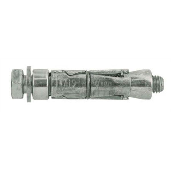

The fixing holes in the frame are for M10 not M12. Thinking now to use tarmac type fixings and maybe drop to M8 with a big penny washer.
