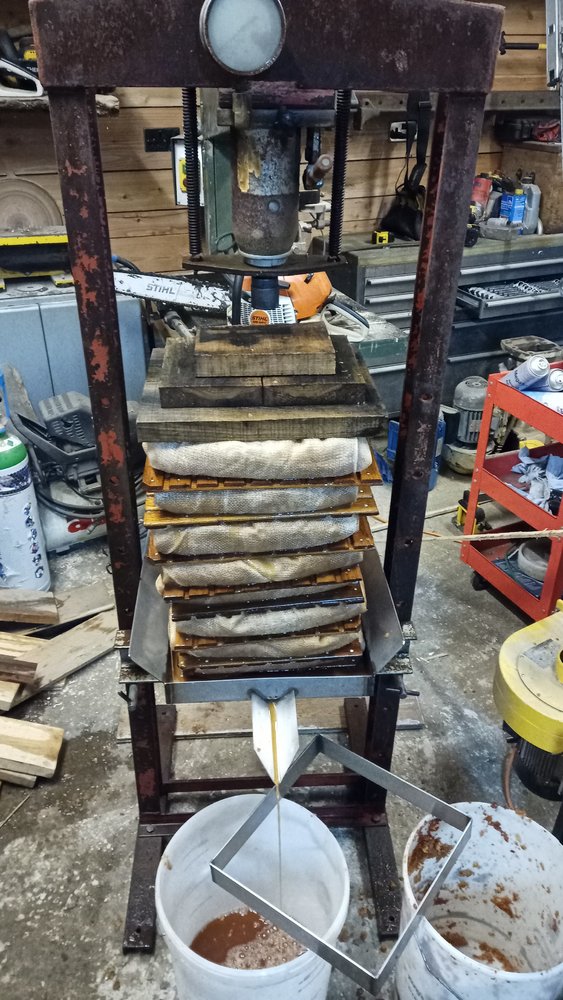

The apples are put into a food grade glorified garden shredder to produce a pulp then this is put on the press in cloths with wooden lattice in between each of them and then given a good squishing to produce juice. (Modified old Clark workshop press)

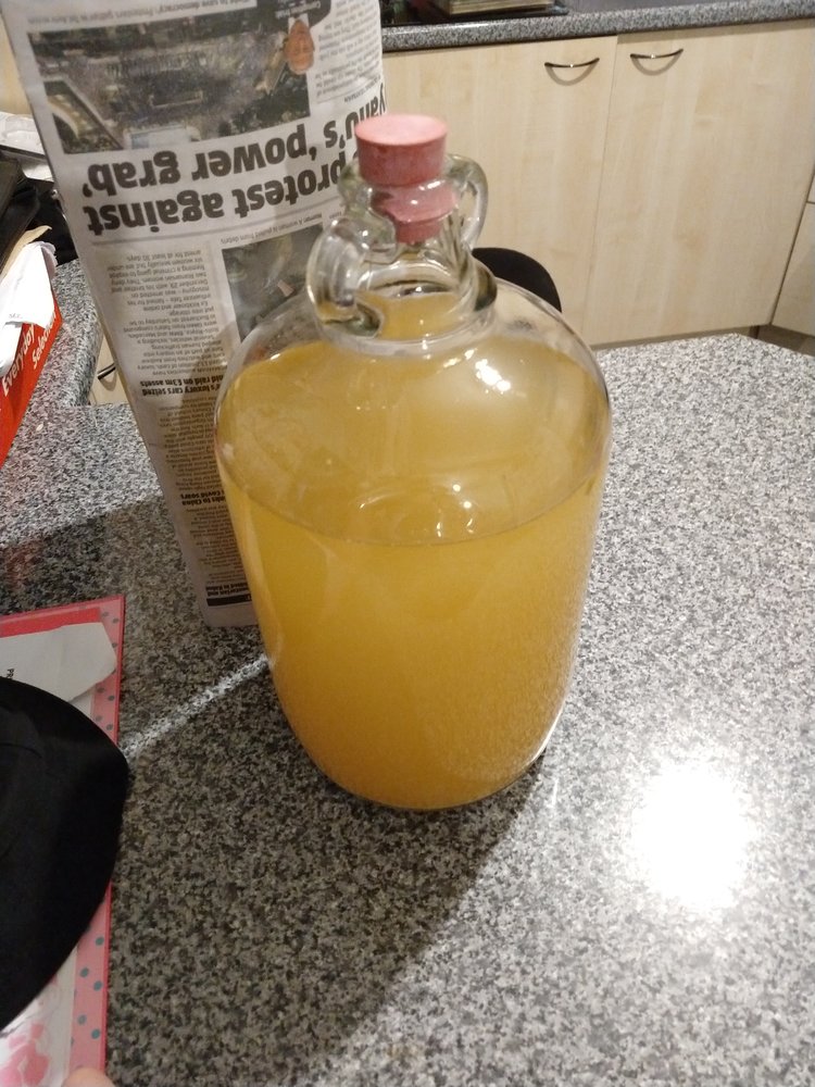

Campden tablets are added to the juice and left for a couple of days then yeast is added.
Cider fermenting seems to be quite a slow process but we have kept a small batch in the warm to ferment quicker, it was decanted after about a month and Hase been left to settle, now seems quite drinkable.
The taste is very dry scrumpy style cider.

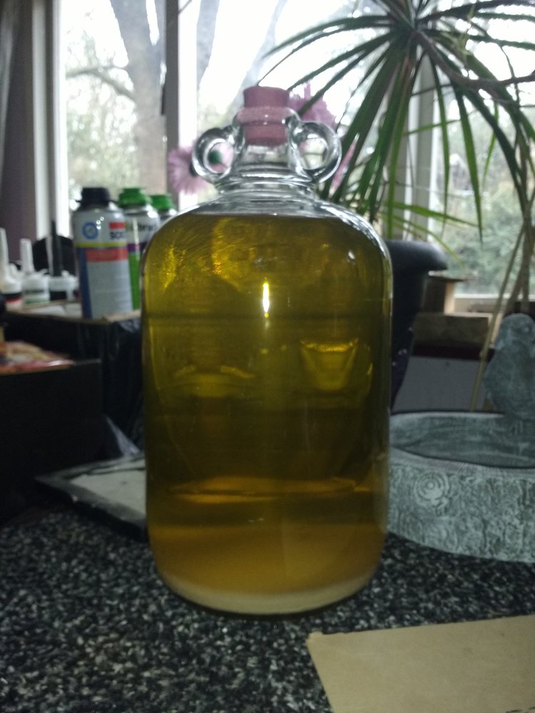

Just rack it off. Gravity filtering fines from a large volume is a huge pain, the paper quickly clogs and there's so little force pushing the liquid through so the filtration stalls and you have to change the paper. You'll have to try pretty hard to keep it all sterile too.The mead I'd say has cleared on it's own really well. There's some lees at the bottom that it needs to be racked off of.
I was thinking of buying a filter. Something like the old Boots one that took the round filter pads. I don't think they're still around but is there a close copy made?
Commercial breweries use a pump and a Plate and Frame filter to get as much filter area as possible, and as much pressure behind it as possible, not really very feasible at home unfortunately.
