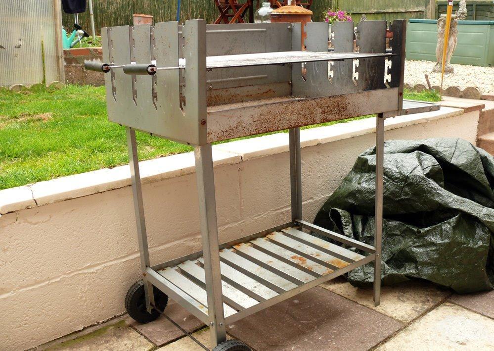

That's great but it is just for bbq not smokingmines massive so dont need to build one
this isnt mine but its the same type and design
Cooks for up to 14 people. Cooking area: (W)73, (D)45cm. Can cook up to 28 burgers at a time. Material: Painted. Grill material: Chrome plated steel. Dimensions: (H)93, (W)115.5, (D)51.5cm. Colour: Grey.
its older than both my kids and still in working order
