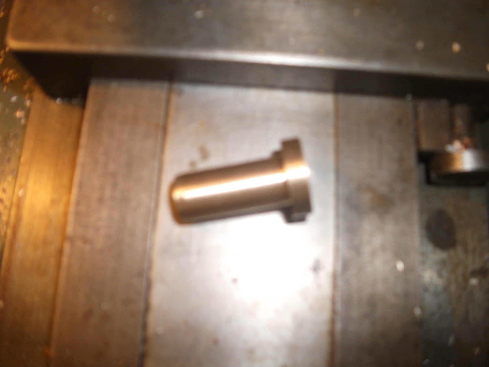

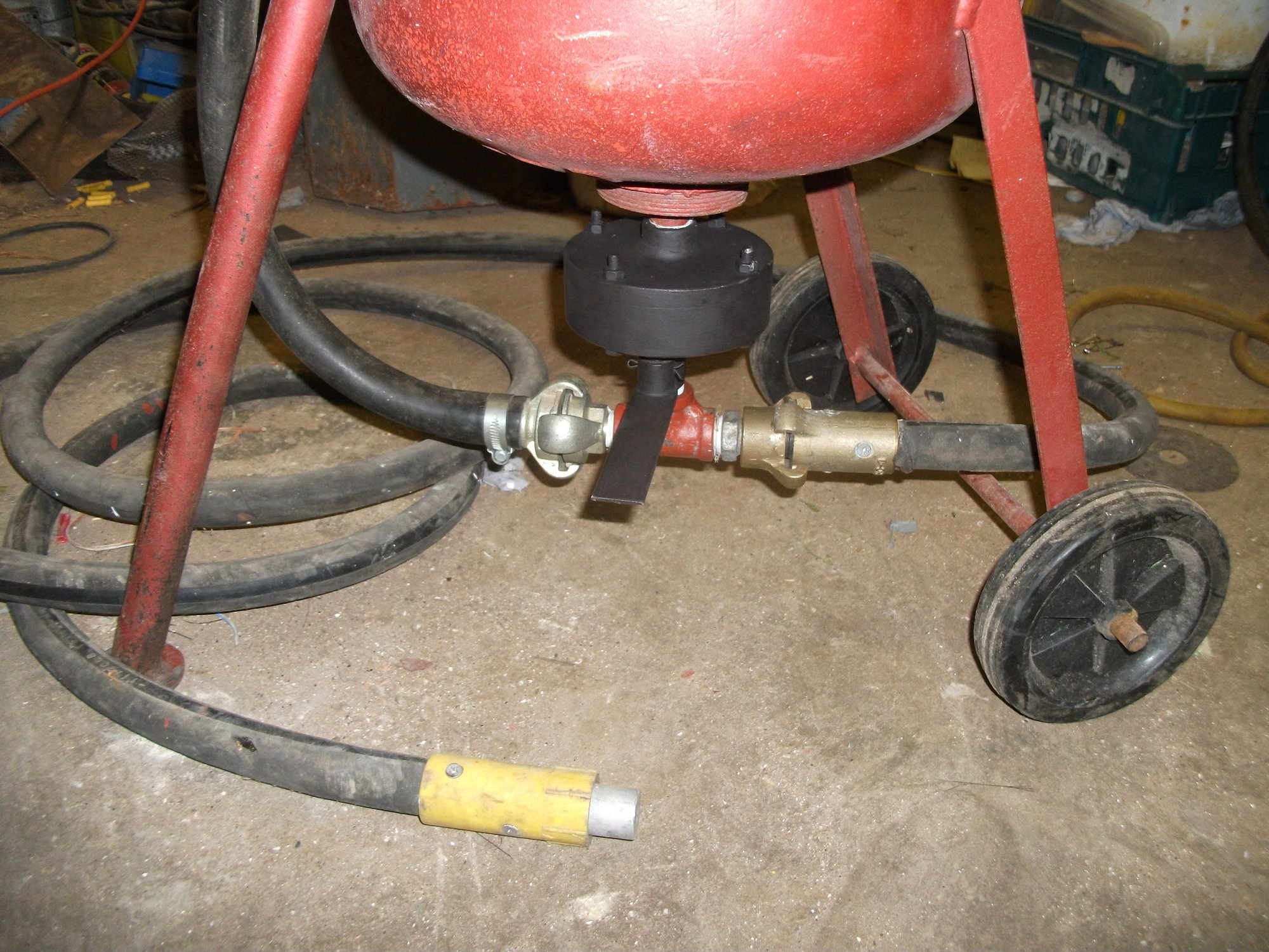

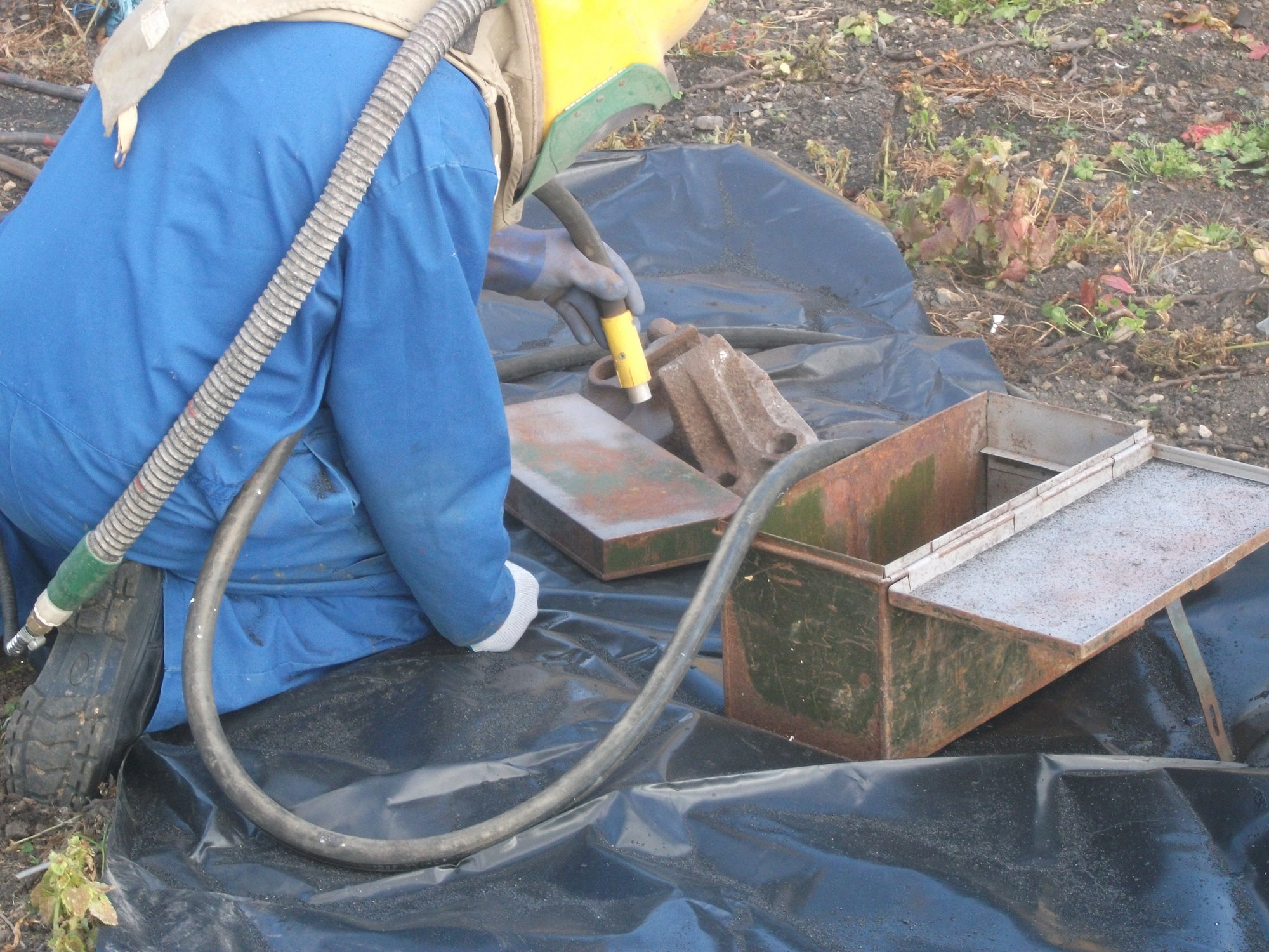

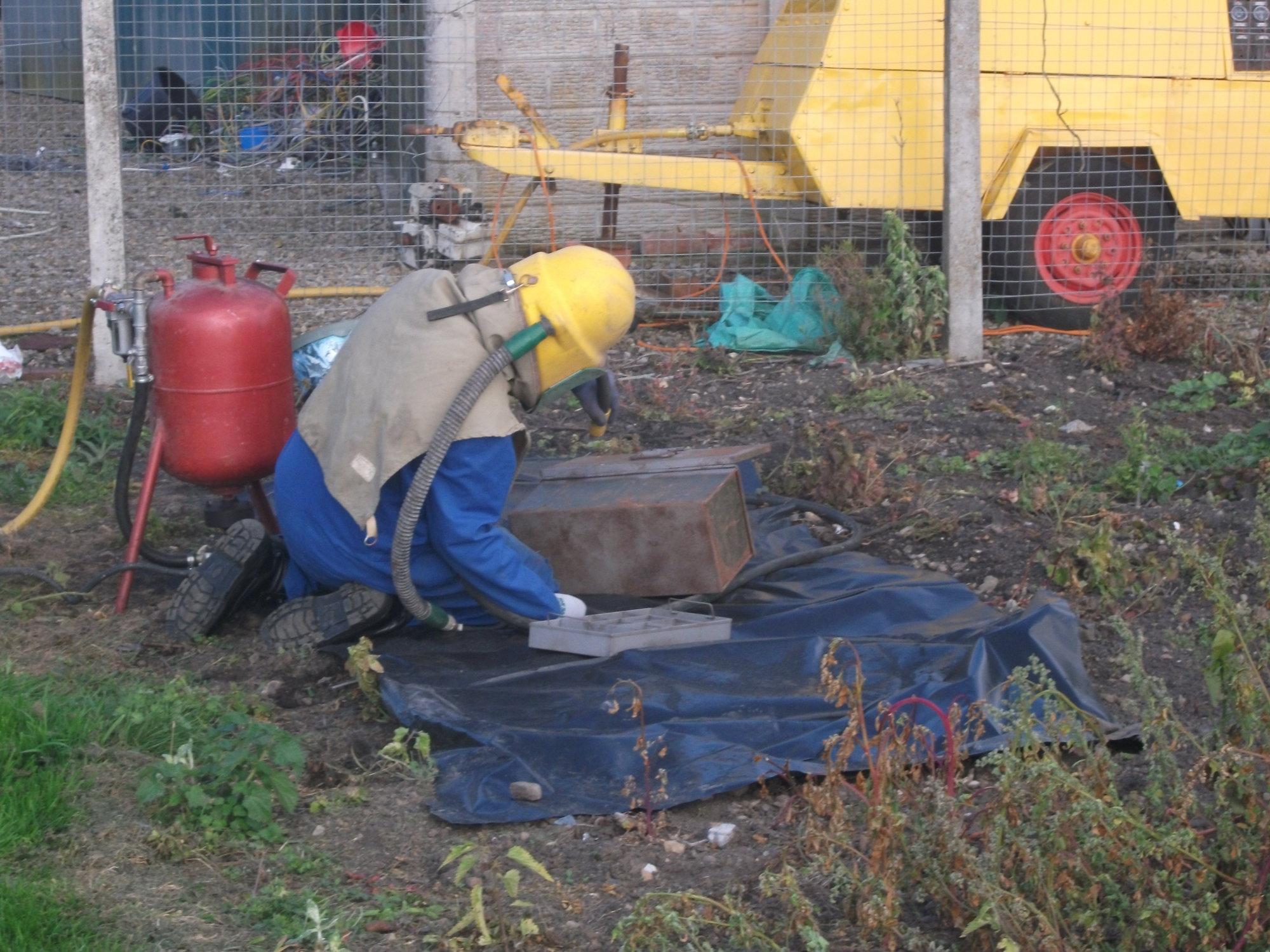

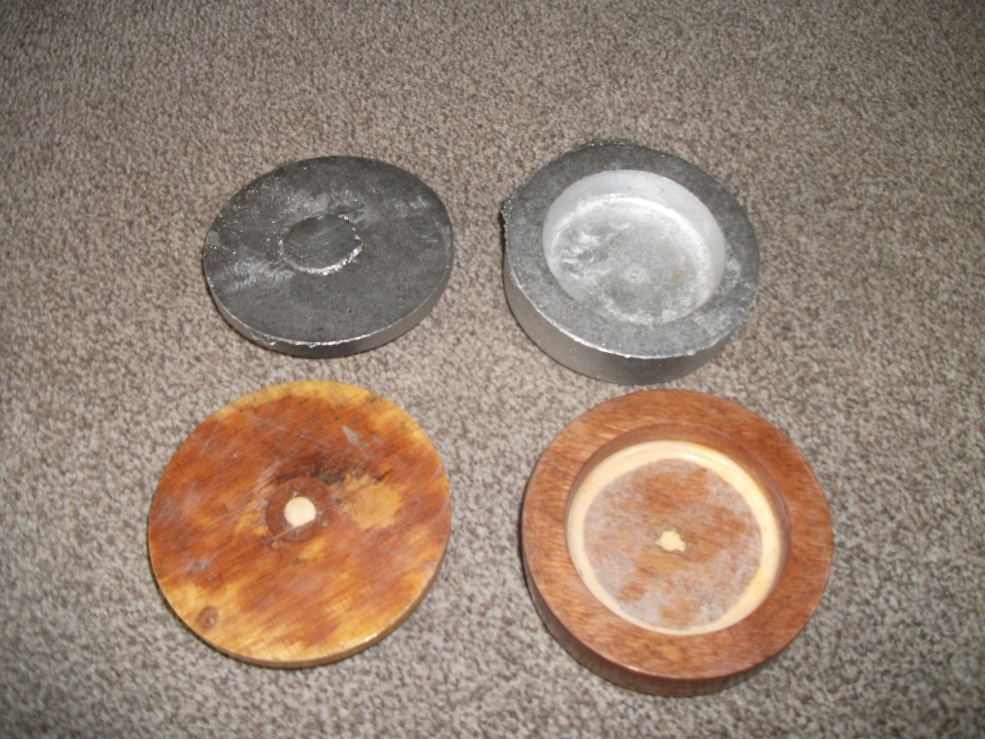

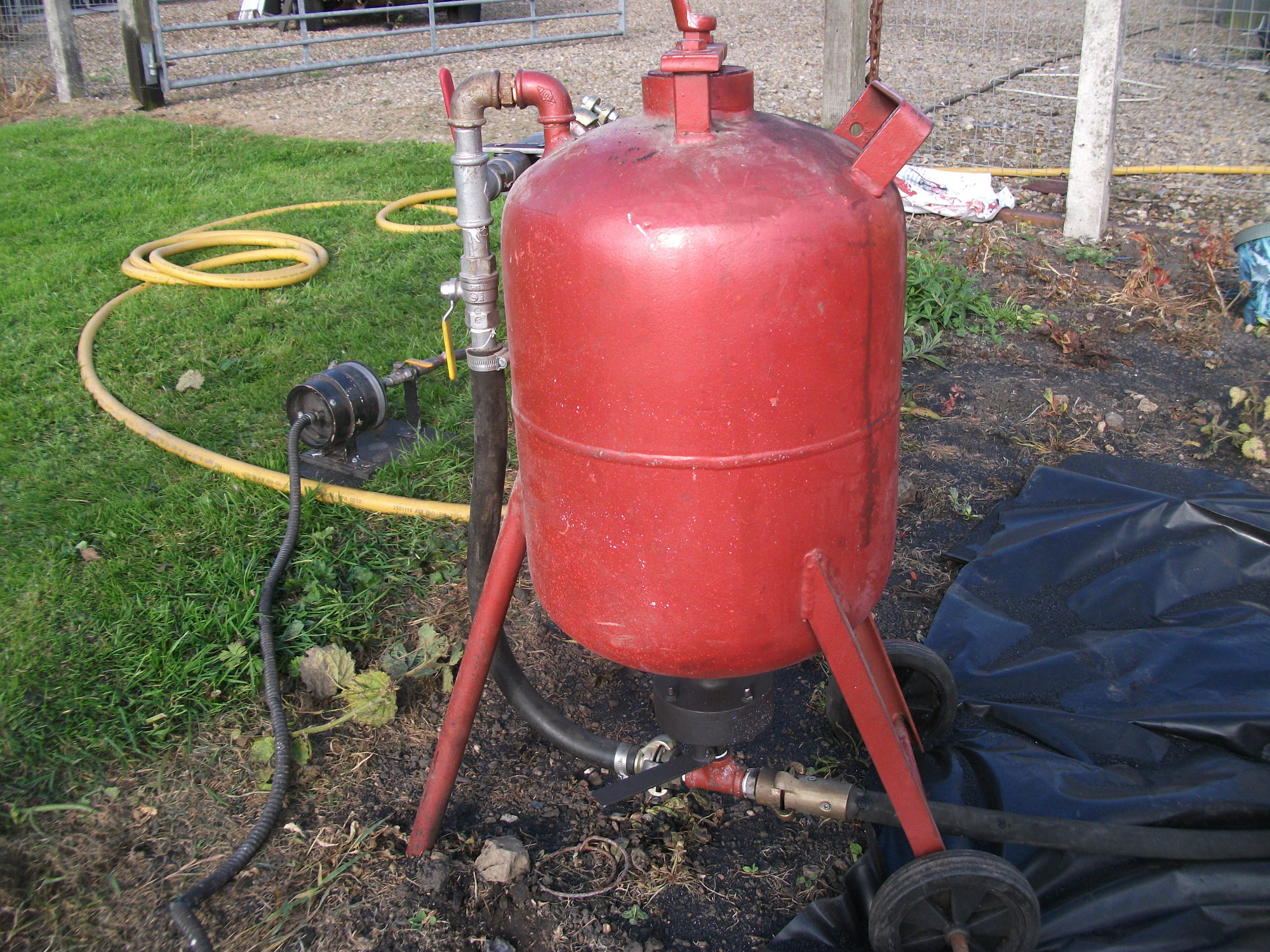

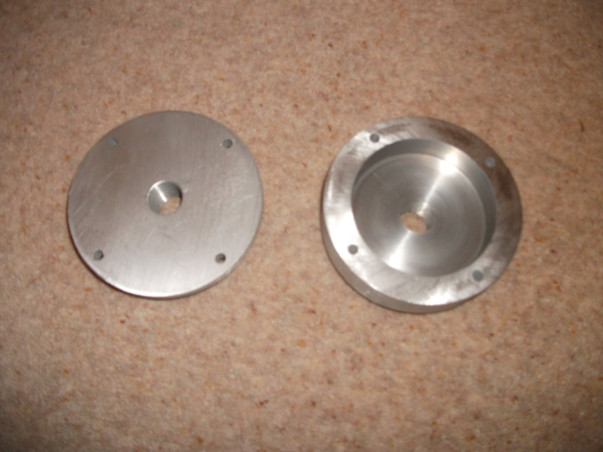

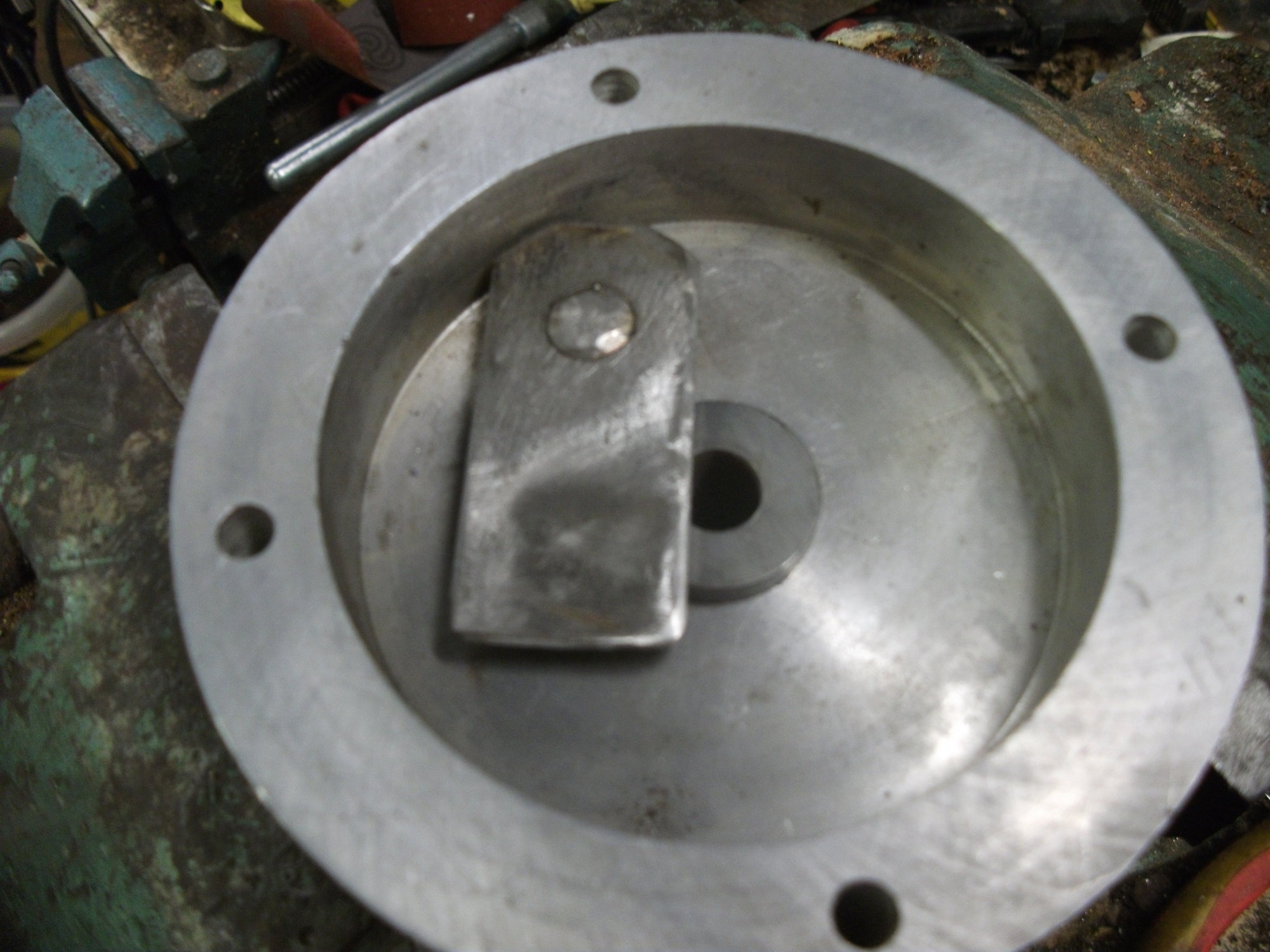

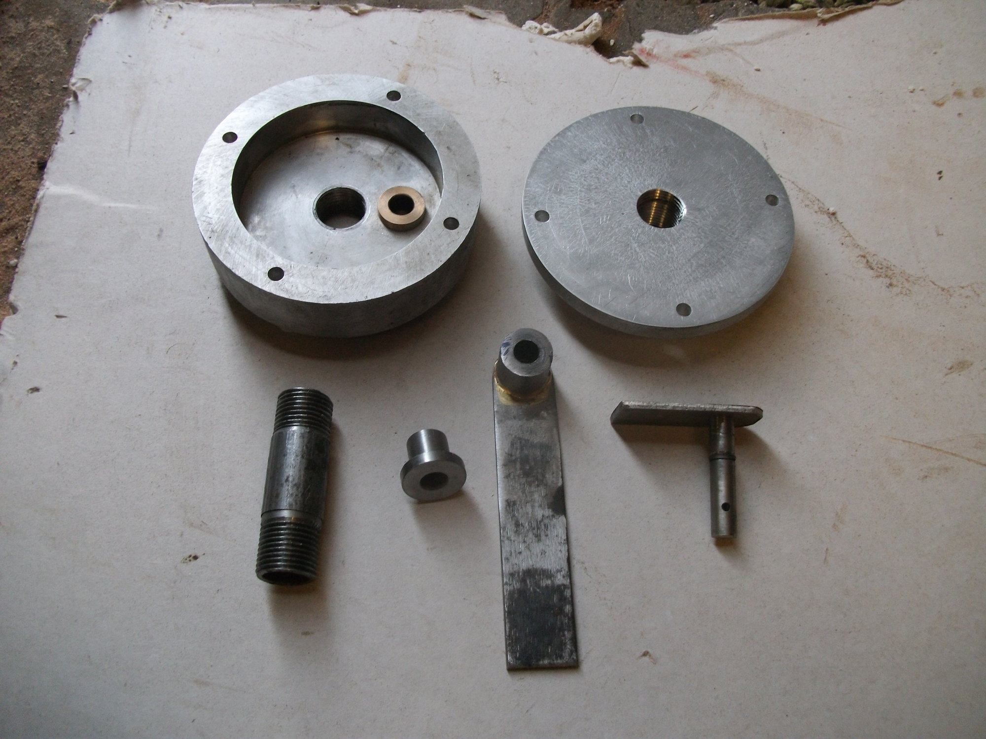

decided to make a regulator cast in ally as the couple of steel; ones I made were a bit small. they worked well using finer grit but didn't regulate 2 well on the coarser grit . this ones a larger chamber and a larger outlet hole under the gate. I made a couple of wooden patterns up nothing flash needed then brother cast them for me in his small foundry . they were easy to machine up being aluminium . the internals were made of stainless steel and I made a bronze bush for the regulator rod its all assembled and will work famous last words ive got a few bits to blast this weekend weather permitting so will see how it goes
