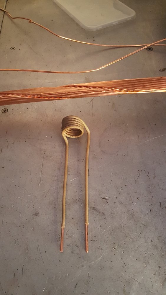

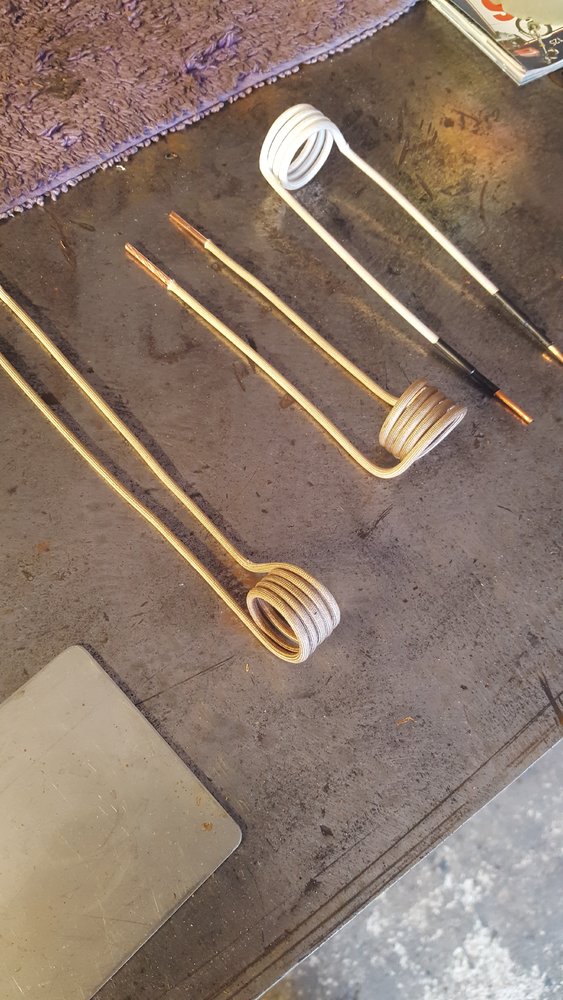

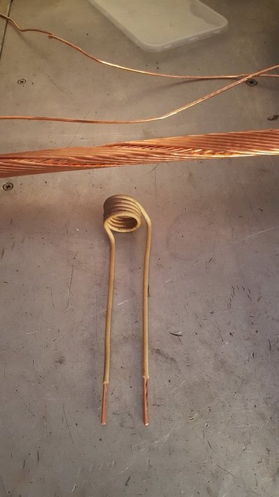

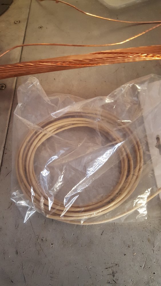

I have one of these guns which are just amazing for flame free rusted nut/bolt removal, The coils are a consumable as they get burnt over time and are a hefty price to replace...Solution is £15 worth of scrap bright copper cable with 2mm strands, couple of 5M rolls of heat proof insulation £6.00 (what you find in electric cookers) and there you go...a pack of Sykes Pickavant coils are £160...Chinese made ones for £35 (white in pic) dont last 1 hour as the insulation just melts.
Made a couple up in 5 mins for pennies..The white one is a China muck special which burn in no time
