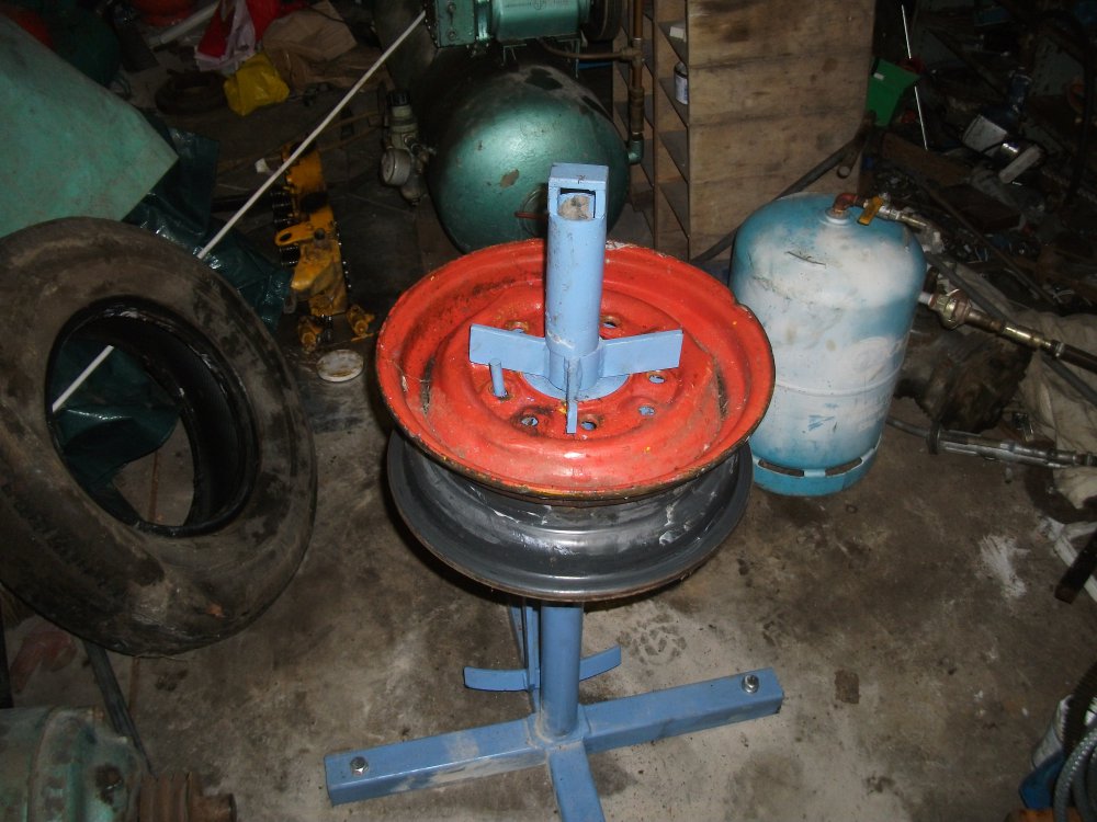

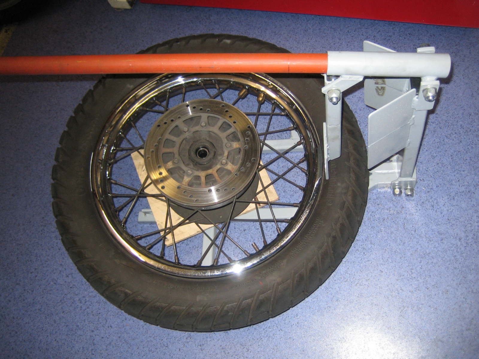

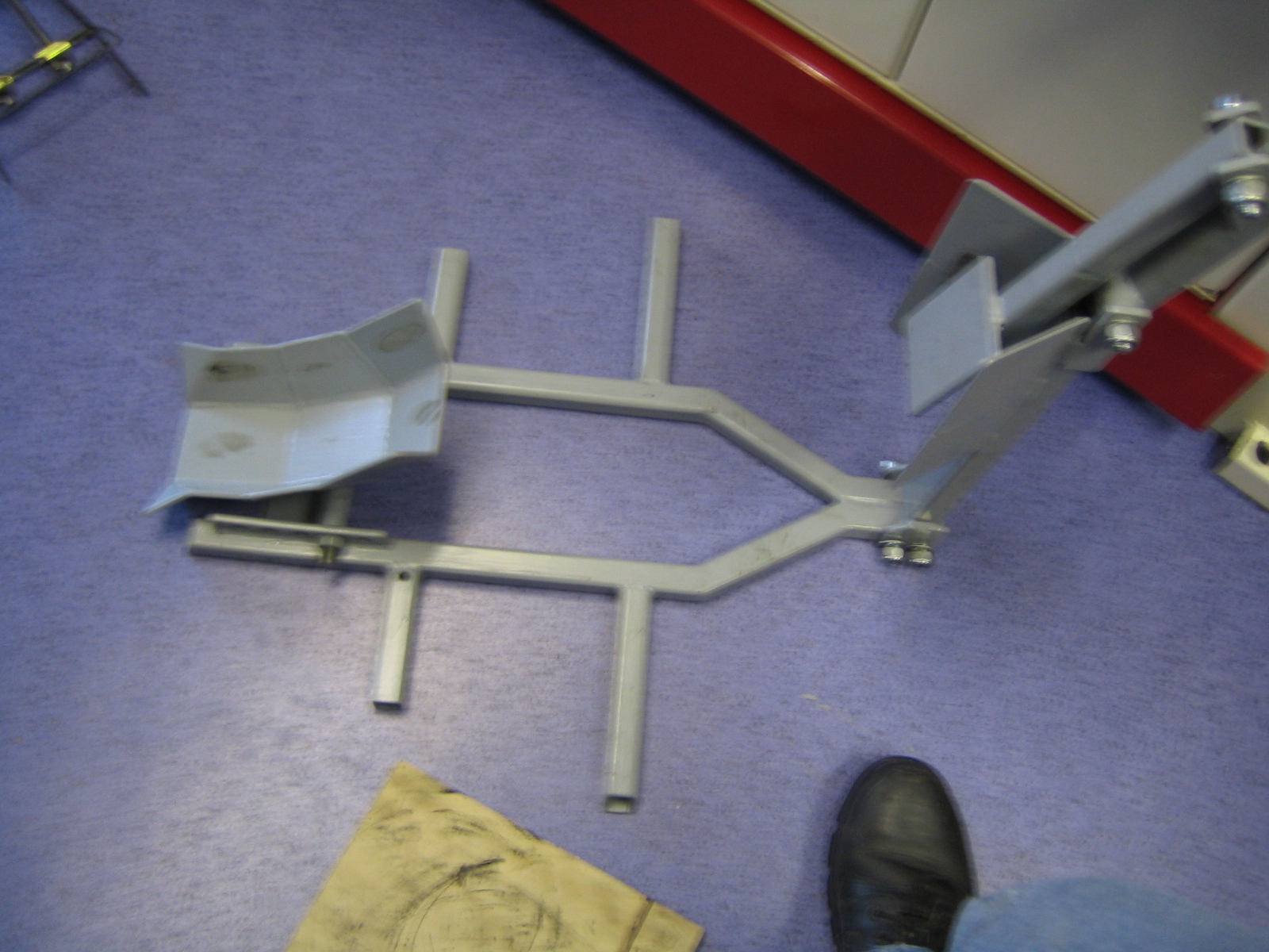

when I made the breaker I-rolled-it to the circumfrence of the wheels and tapered it underneath so when u push it down it pushes in to the wheel rim rather than just slide down the tire wall
