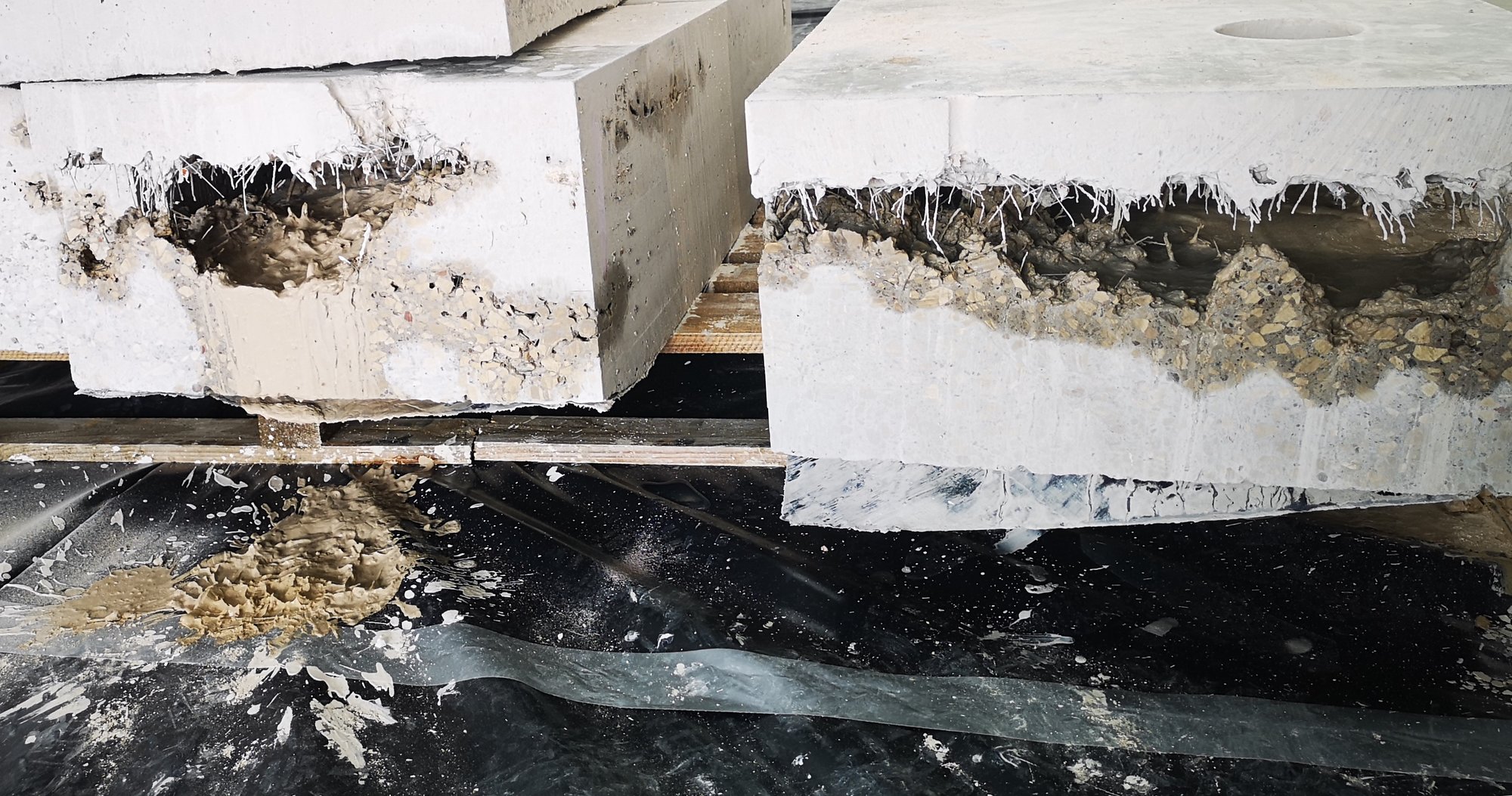

Someones in for a slapped hand.
Looks like the needles haven't been mixed throughly enough. I believe they are added them once one site.
Looking at the partly washed aggregate, I think the last truck has washed out the shoot, the next hasn't mixed the reinforcement in enough, so it all came out at the start covering the top layer of mesh. Stopping any concrete falling through; causing the void.
Anyone seen this before.
