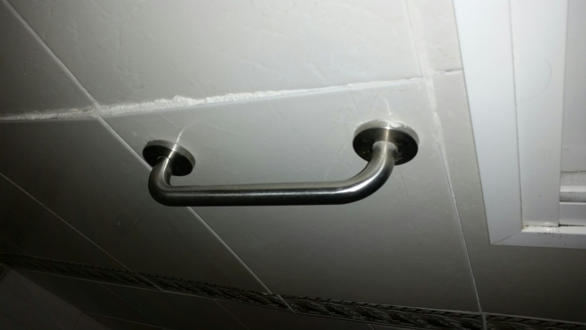

Time might be money but you cant go smashing big dirty holes in peoples walls and leaving them there just because a cupboard is going up.![]()
rough as a badgers a..sehole .u could just patch them up quickly with backing plaster it might not bother some but u wouldn't be working for me doing itI've got one but times money. It's never seen and the damaged plasterboard is away from my fixings. It also costs no more than a few screws and is stronger than any of the on fixings on the market. Comes down to surface area
To do a proper job you would cut a regular panel out of the board spanning two uprights, screw noggins to the uprights, fit 1/2" ply then re instate the plasterboard, joint fill, rub down and re paint.rough as a badgers a..sehole .u could just patch them up quickly with backing plaster it might not bother some but u wouldn't be working for me doing it
