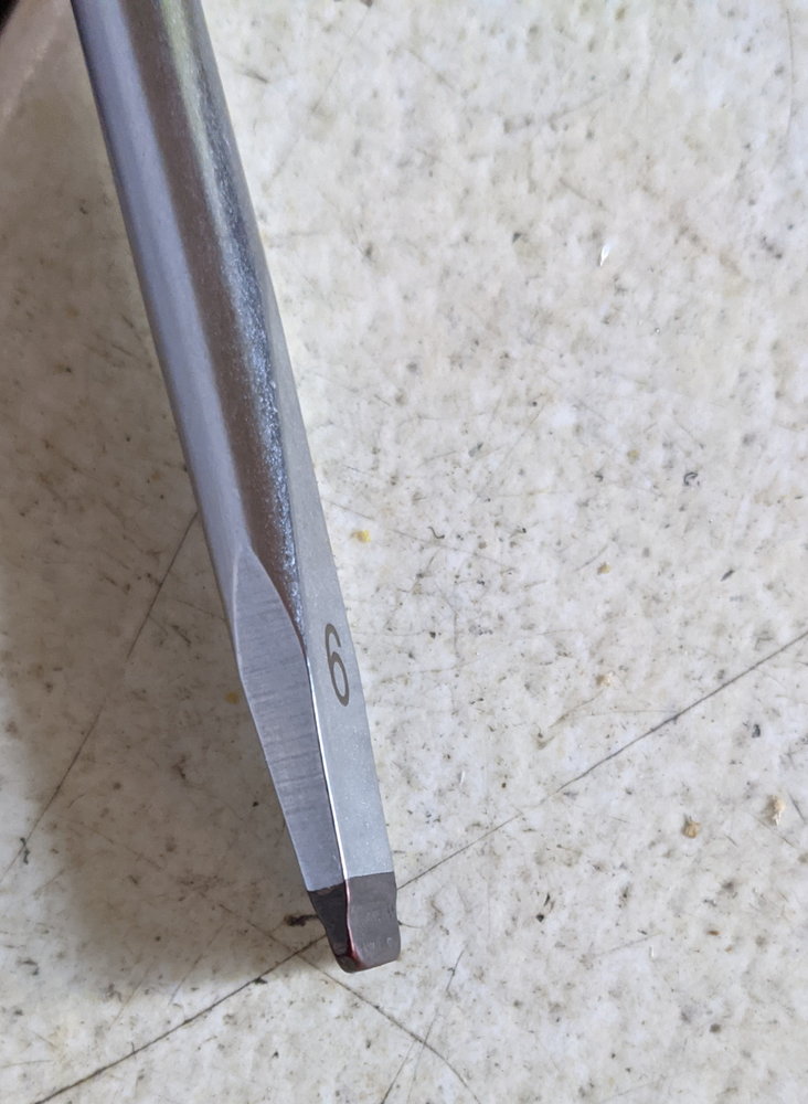

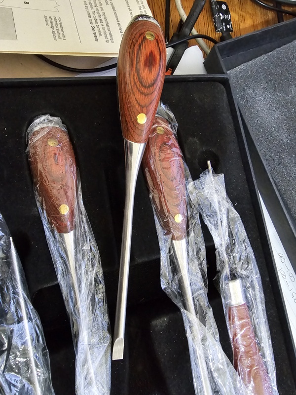

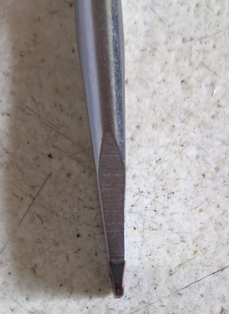

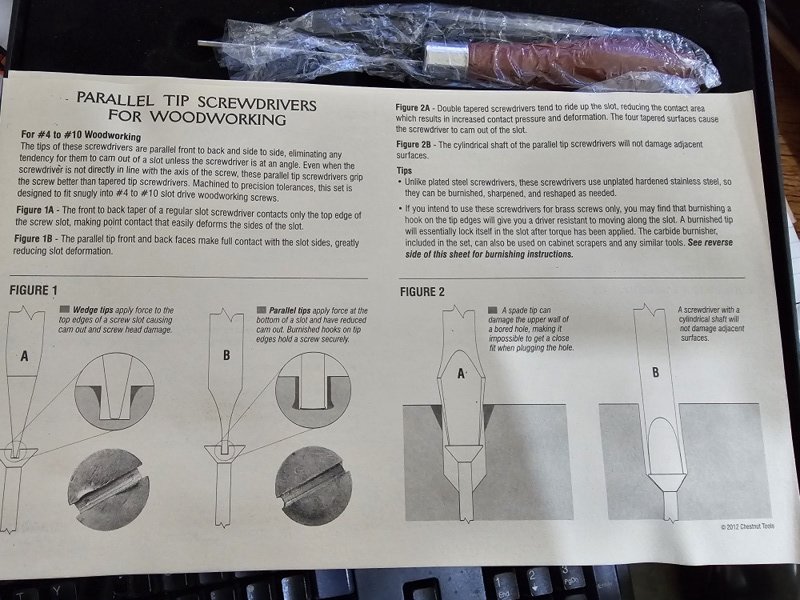

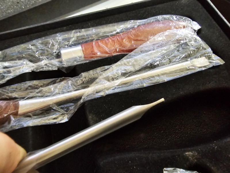

Way to good for use as a part time chisel....I got these as a present a few years ago. I only use them when I need to make sure that I don't slip on a cross head screw and chew it up. It wasn't a random present, I asked before they bought me the usual straight to land fill tat
Nicely made, feel very good in the hand

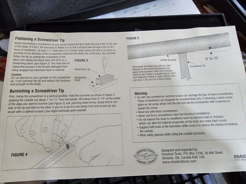

four screwdrivers and a burnishe
you put a slight burr on the end with the burnisher, a bit like you do with a cabinet scraper. Supposed to grip the screw better, seems to work.
