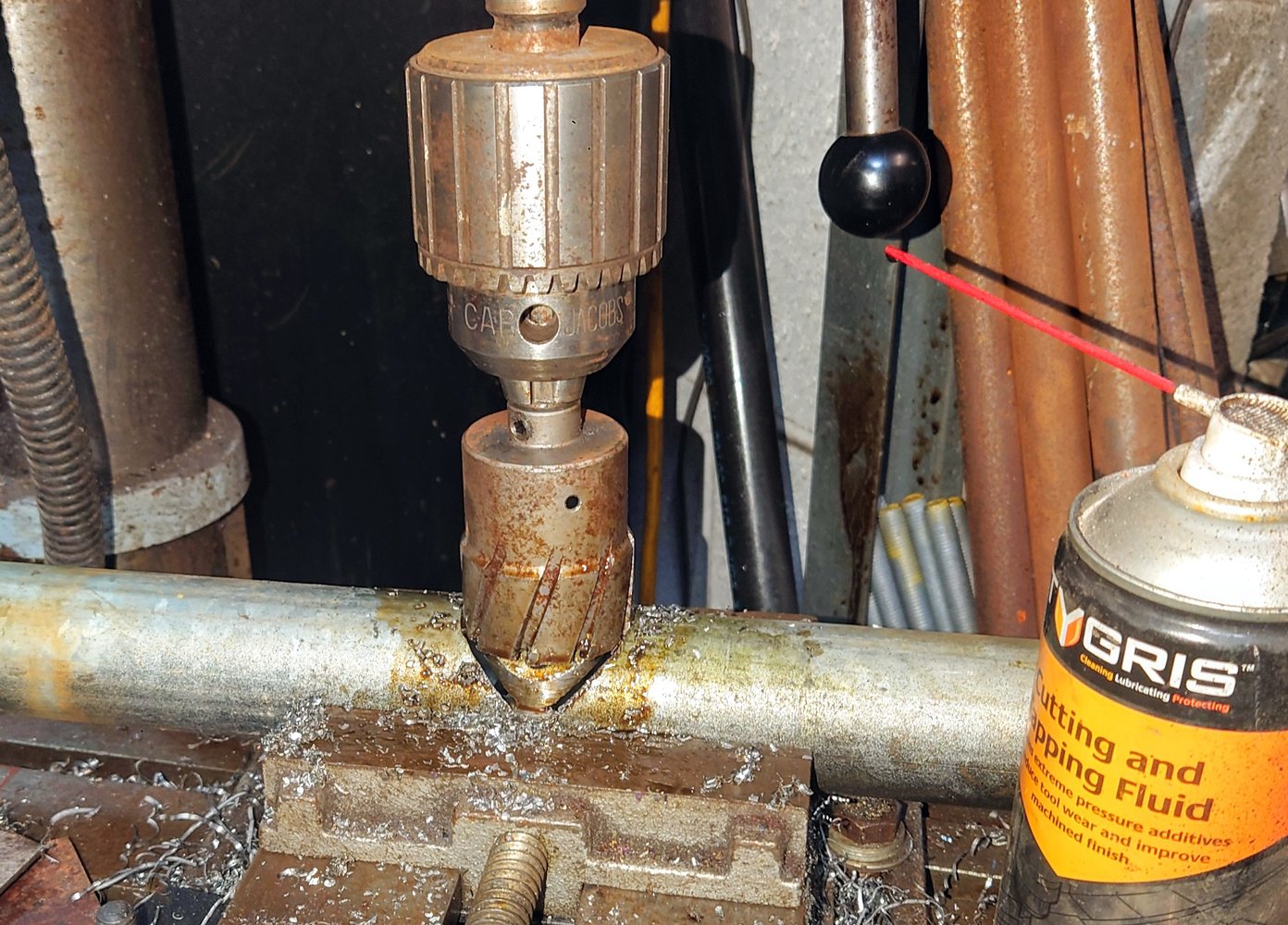

I've just done some 51 mm holes in a railway signalpost, so that's tube approx 160mm diameter with a 10mm wall. As others have said, swarf clearance is the issue. I found that cutting paste or thick cutting agents like Rocol RTD makes the situation worse, but a thin cutting fluid like Morris's Cora B really helps.
Psst... its cut the occasional 60 mm pallet nail in half down its length Fizzy ..guess how I know?
