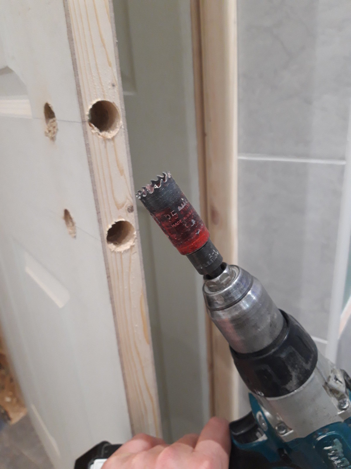

doesn't matter what make. there not happy cutting in to wood of any thickness no clearance for sawdust removal as the teeth are fine and overheat
Been meaning to make or buy similar for a while.yep.
spade bit, forstner bit, or (for bigger holes) router circle jig[1] for wood.
[1] i have a trend "pivot frame jig" which can cut perfect circular holes in any size from bit diameter upwards, but a trammel type jig works
Dunno mate. Have a lot of the Bosch occasionally give em a quick sharpen and they keep going mainly wood and composites mind.
What were you doing with it.
There's one in my box that was used to drill 30 holes through 45mm c16 then 10mm structural steel then through another layer of c16.
It's still in the box and happily chugging away through wood.
Need to replace the arbours occasionally as they wear.
Put a chainsaw file to a big one a few weeks back then drilled out the center hole for my fixed steady no drama.
Aye. There not really aimed a full on metal cutting I don't think.Main use is on steel so maybe unfair.
