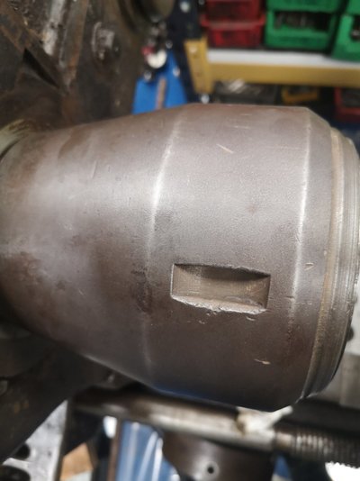

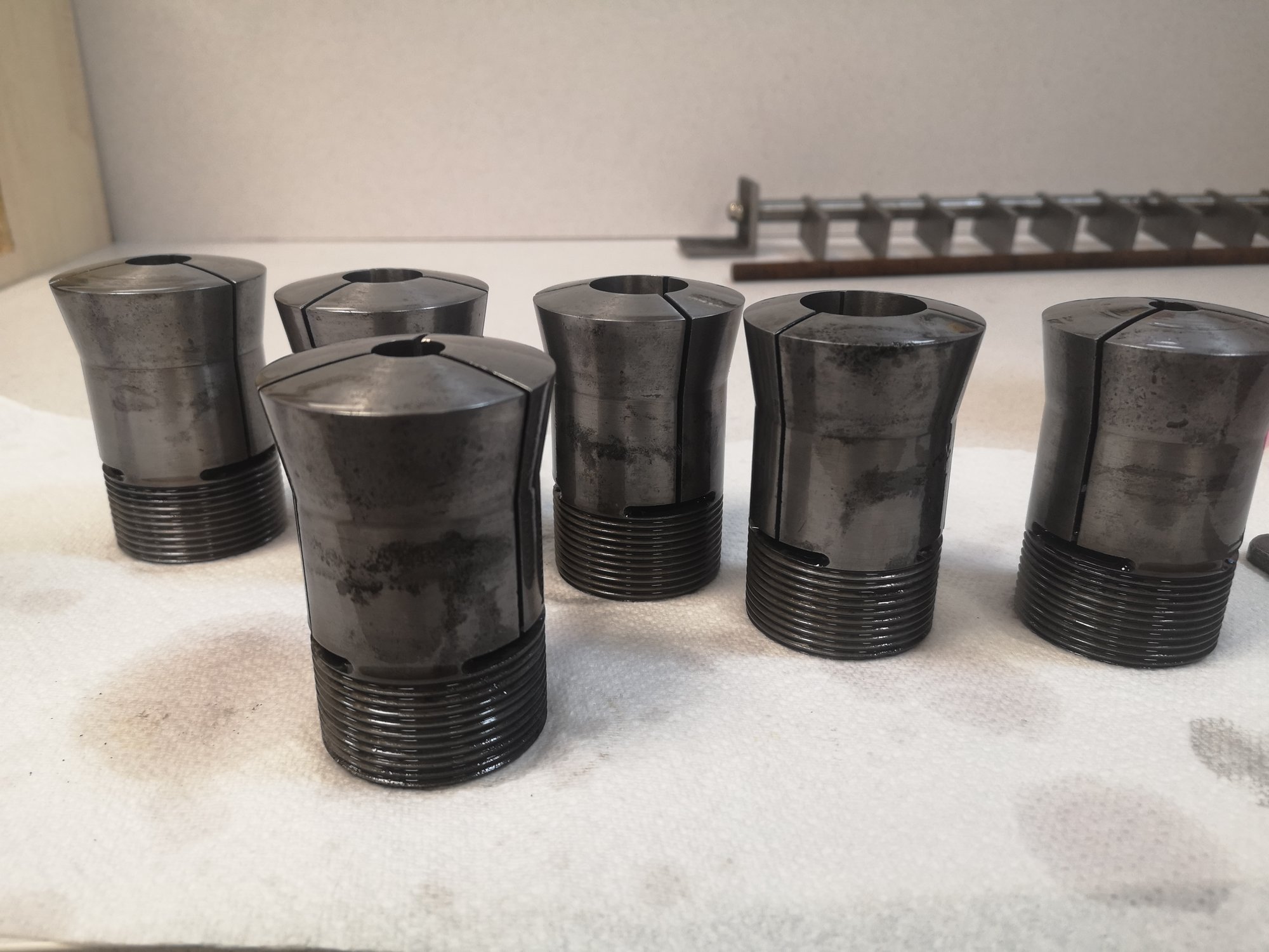

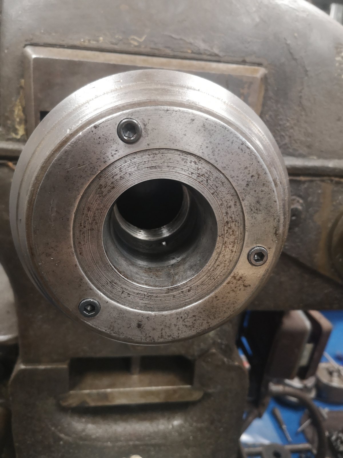

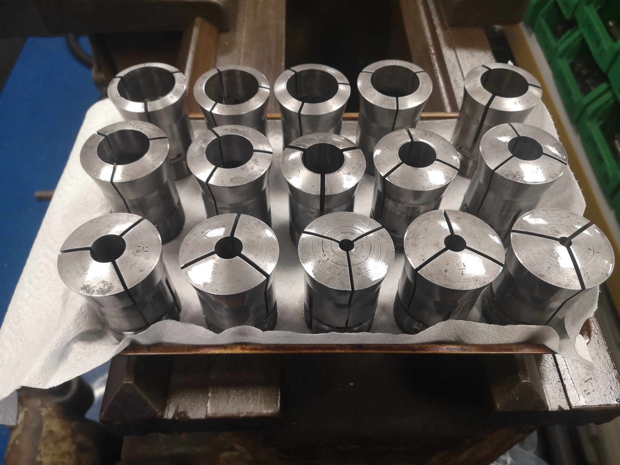

    So this week, I have mostly been busy with evaporust. Now normally I just go for you ordinary citric, but given what I was playing with I wanted to be sure of strength.
    21 Collets had to be cleaned in degreaser, into the evapo in a large jamjar in the ultrasonic at 55 degrees for a few blasts and
    finally a blow down with air rub over to remove anything left and covered in ACF50. (This can be washed off as and when I come to use them)
    Thankfully all have made it, none of the internal bores were affected by rust and the threads all held up (12 TPI)
    Some marks through use over the years, but this hopefully has stopped the deterioration
    Great capacity from 1/4" through to 1 1/2" some are marked Hardinge, but these where produced for just 2 models so are rare

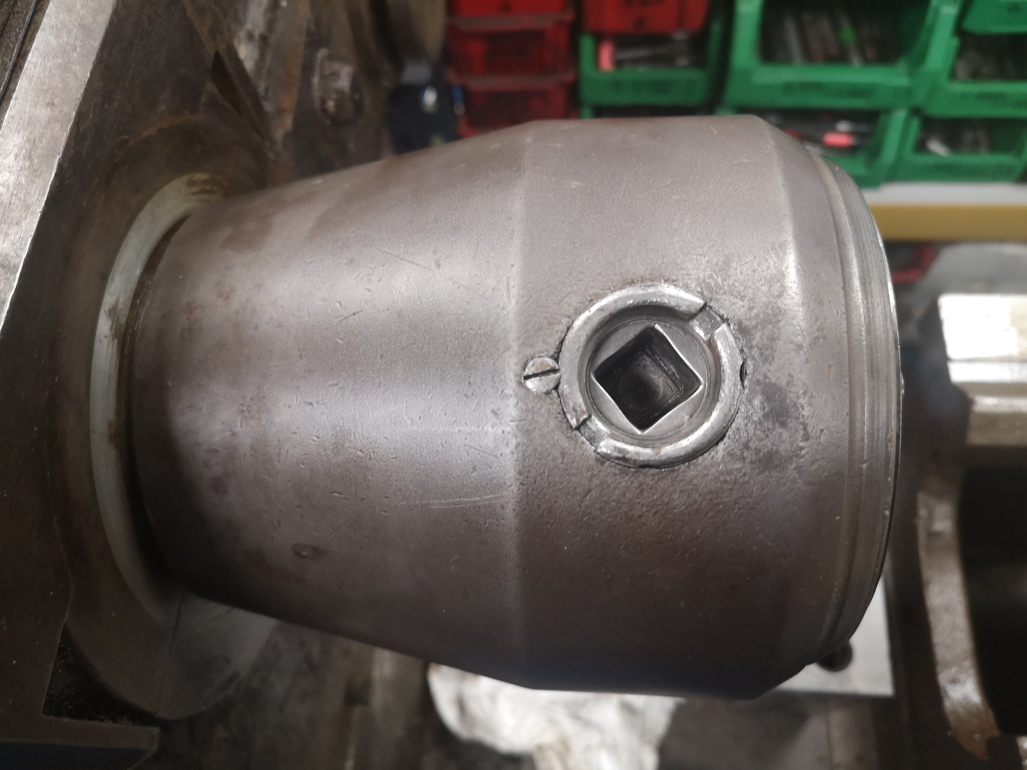

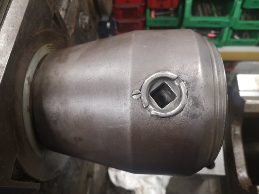

    Chuck also stripped and cleaned, some wear on the teeth but nothing that affects use...
    Much fun was had removing the original BA cap heads on the front as this had been mashed over time
    5mm allen key ground had to be ground to fit
    Only thing missing is the huge C-spanner to take the chuck off, I can see a laser cut one been the order of the day

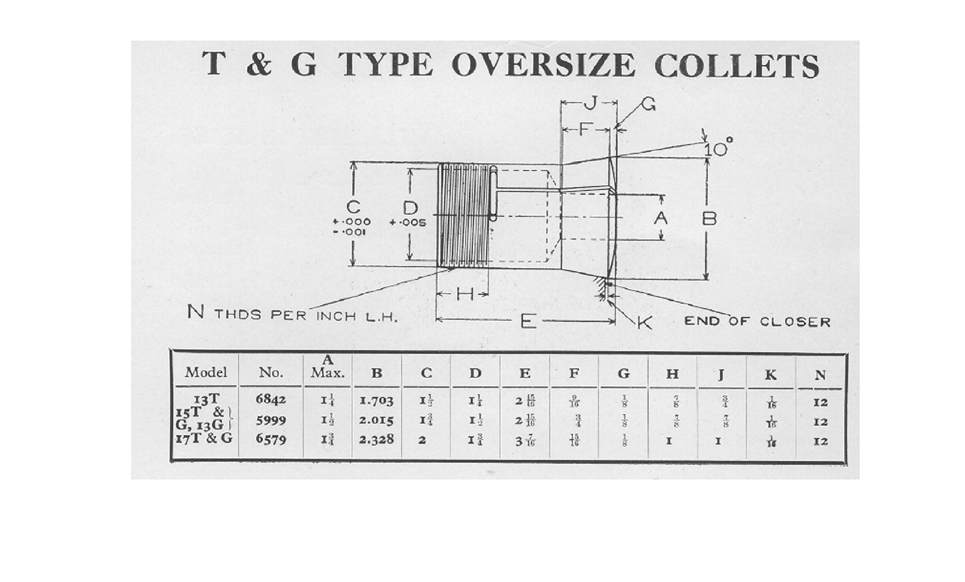

    LH thread collets?
    Milkybars likes this.
  14. Milkybars
    Milkybars Forum Supporter
    Messages:
    545
    Location:
    Essex
    @Pete. 1.750 x 12TPI LH thread yes

  16. Hopefuldave Intergalactic pot-mender
    Messages:
    1,804
    Location:
    The Shed of Danger, surrey, England
    How big is the C-spanner, I may have something suitable (doesn't fit anything I have), think they're for L-type spindles...?
    Dave H. (the other one)
    slim_boy_fat and Brad93 like this.
  17. Milkybars
    Messages:
    545
    Location:
    Essex
    The chuck is 5.400" OD the slot is around .400 wide

  19. Milkybars
    Messages:
    545
    Location:
    Essex

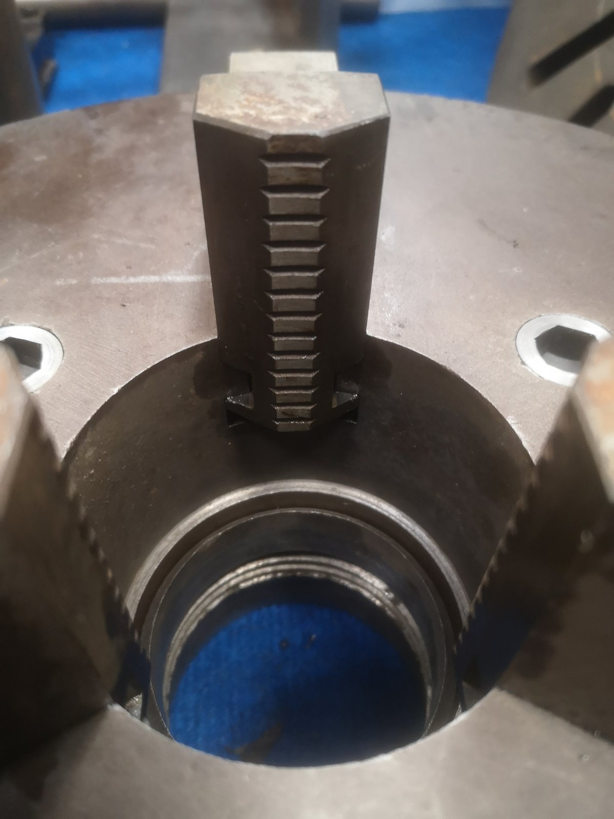

    Been busy sorting the accompanying chucks and steady.
    The steady has led to looking at paint which I am not sure on just yet.
    Really happy bunny today ..Ebay came up trumps with a new set of jaws for the 'obsolete' 12" 3 Jaw
