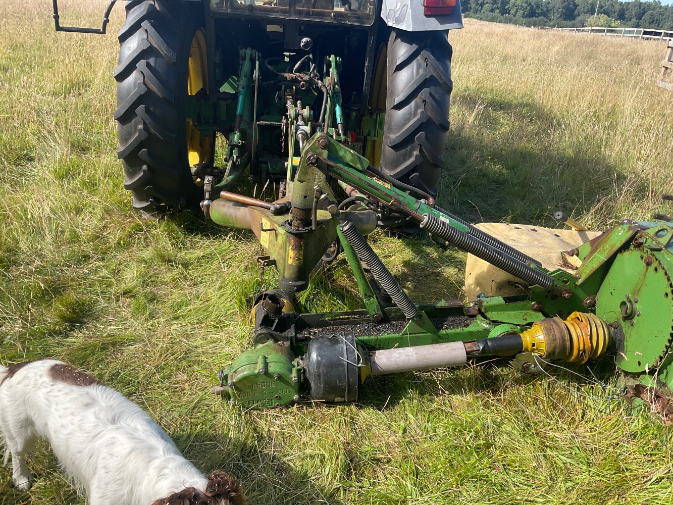

No matter what I do, it keeps pulling apart at the pivot. It’s not been used for a long time, and I’ve never hitched one up before, so not sure if it’s busted or if I’m doing something wrong.
Has that snapped or come apart at the bottom, looks to me like that should have a bearing or some kind of top hat bush/ bearing at the top.No matter what I do, it keeps pulling apart at the pivot. It’s not been used for a long time, and I’ve never hitched one up before, so not sure if it’s busted or if I’m doing something wrong.
Will do, thanks. I’ve only ever used in-line toppers and flails before - what’s the best pattern for covering the field?In future once you've repaired the headstock, undo the balance springs from the top before unhitching, it'll let the headstock sit flat and makes it far easier to hitch back up again.
We have an am240cv as well, they're great mowers.
We use ours for silage. 9-10 times right around the field. Then split it into 2 or 3 bouts, work the insides outwards by going anticlockwise, then when the bouts are half gone, go clockwise around each bout to finish. It minimizes the tracks at headland.Will do, thanks. I’ve only ever used in-line toppers and flails before - what’s the best pattern for covering the field?

Yes to float position, if you have it handy, but its not essential. Once it's dropped into work and link arms are at the right height, the mower pivots and contours on a 4 bar linkage.Done the field now! A few more questions:
