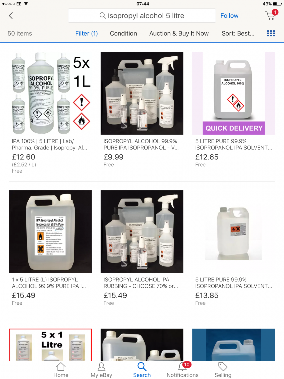

and it'd also lower the freezing point to about -4°C. Stronger mixes would lower the flash point, somewhere on the engineering toolbox site are charts for both freezing and flash points for various mixes of IPA. Same site also has data for different glycol mixes too. If you want to mix your own coolant for whatever reason you can get pure mono ethylene glycol (or propylene glycol) from the many of the same places as IPA and Hellfrauds usually sell DI water for ~ £4/gallon
