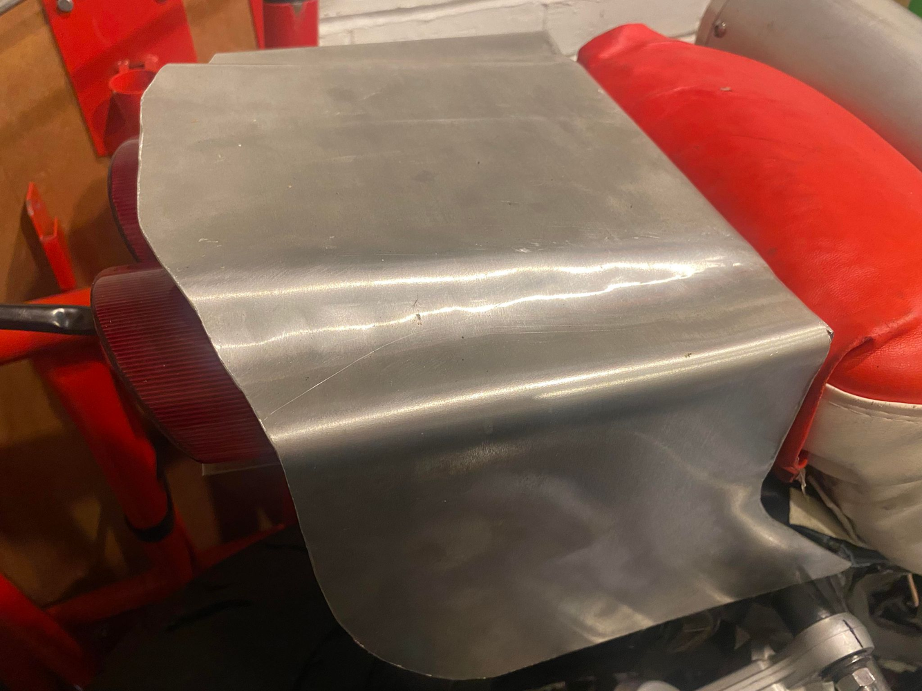

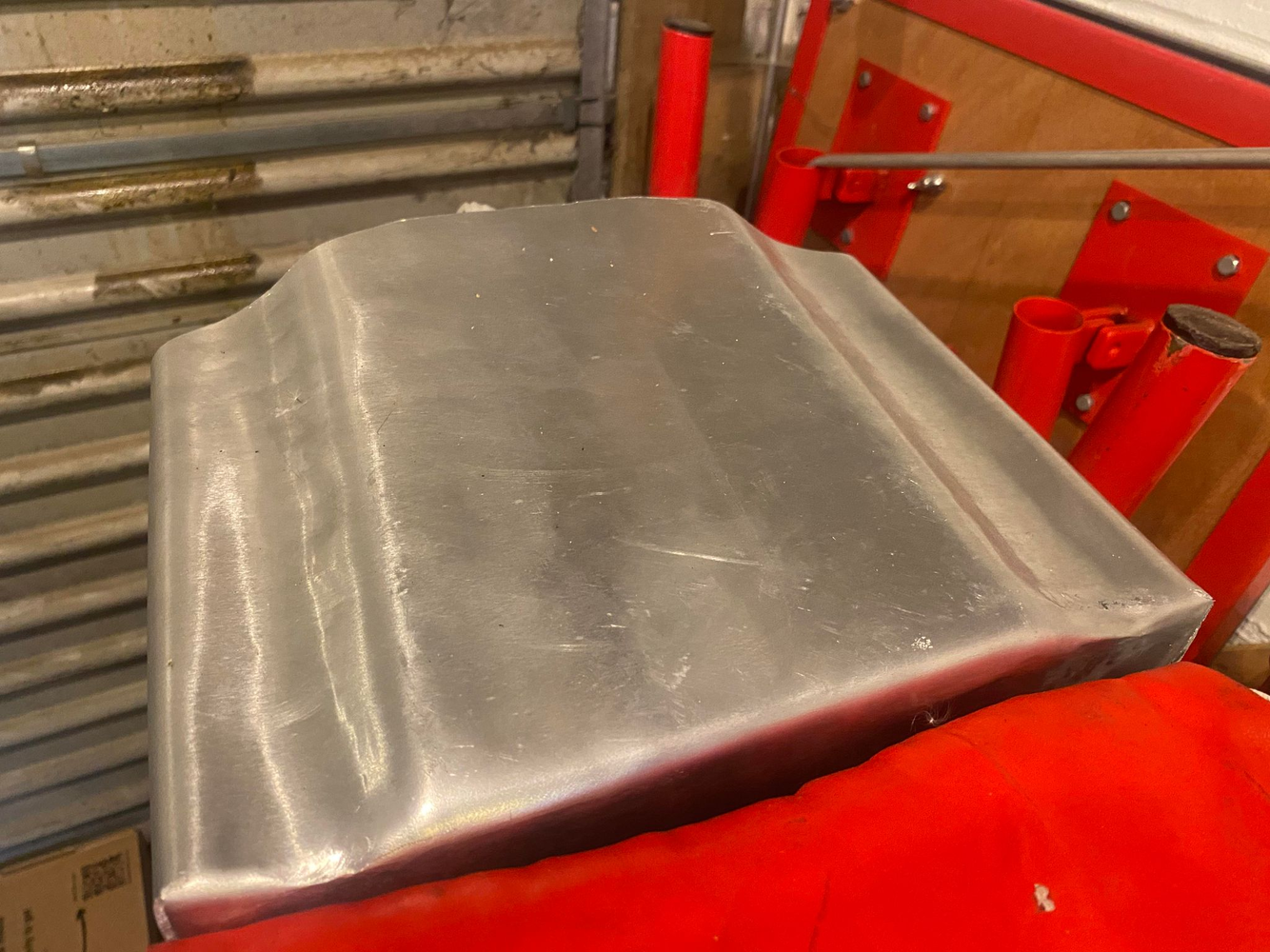

Thank you. Yeah, I'll take a look at those videos. Any help is better than none, and I'm new to all of this including shaping bodywork. The nearest I've come to anything like that was trying to make tail cowl for my bike out of 2mm aluminium. Isn't the best job, but it's better than I imagined I could do with no training and just going at it.Welcome!

It isn't a substitute for tuition, but if you put up pictures of the results on here, there is usually a few who are pretty good at giving some constructive feedback.

Just used a rubber mallet and a basic Clarke panel beating kit and a large piece of wood to shape it on.
