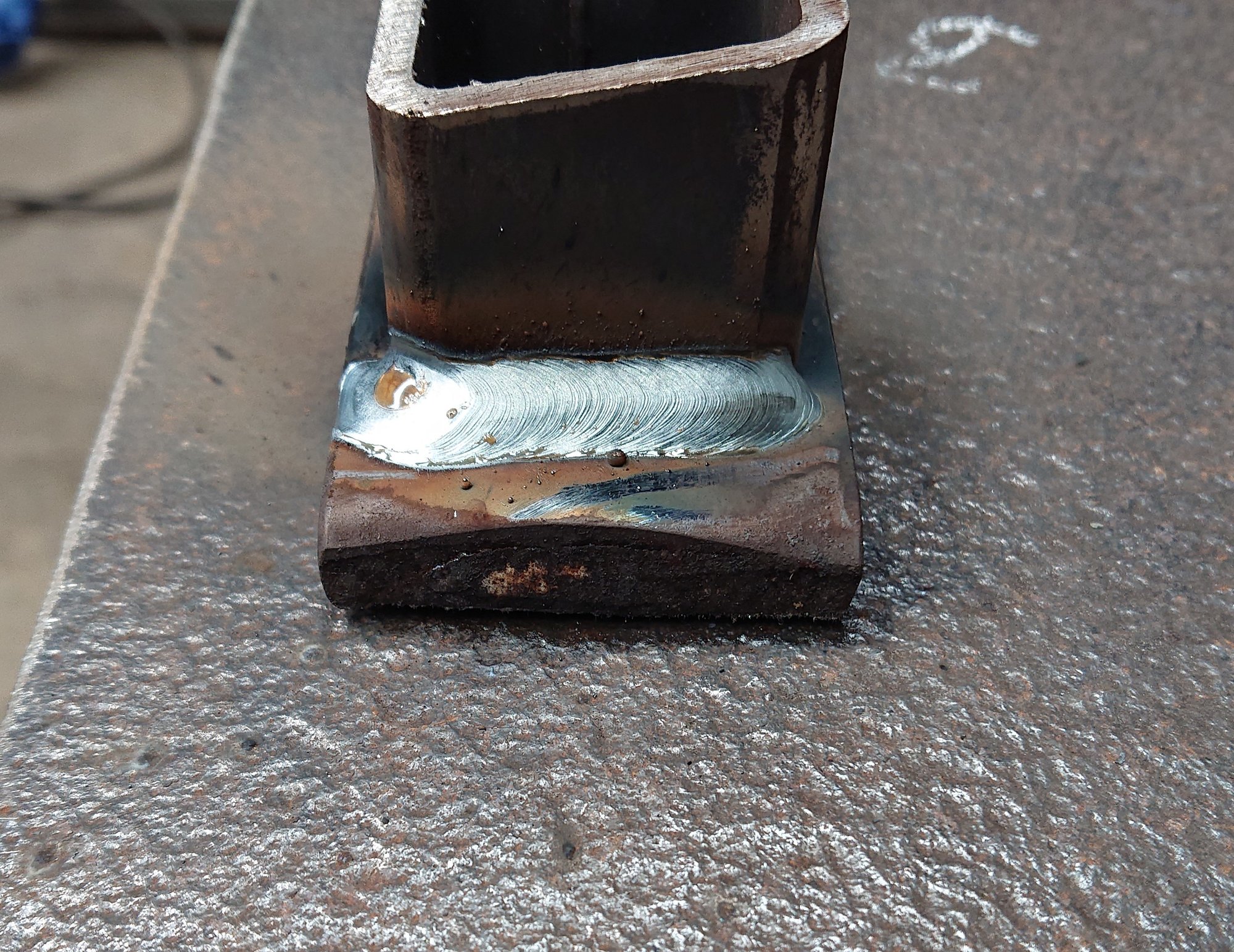

Well guys n gals I appear to have gotten somewhere but am not quite there yet.
Before I go on I would like to thank all of you for your input and especially Jim Davey who very patiently talked me through some areas to investigate.
After talking to Jim he had a strong feeling that the problem was torch related, even though I had tried 3 on the machine with the same results.
I set to stripping out the Eurotorch socket and found that even though the connections looked good they were actually loose and had signs of arcing. I removed the connection, cleaned them up and put it back together.
THIS DIDNT WORK!!!
Next I removed the full wire feed rollers and the Eurotorch socket. I didnt find anything here except some discolouration of the socket where the wire passes through.
I cleaned this up and rebuilt.
Suddenly I can weld again!
I dont know what is going on, but I have 4 torches here, 2 of which used to work and are in virtually new condition yet the one that is now connected and working has been borrowed to me by a friend and has clearly had a hard life.
I am going to replace the Eurotorch socket and see what happens.
