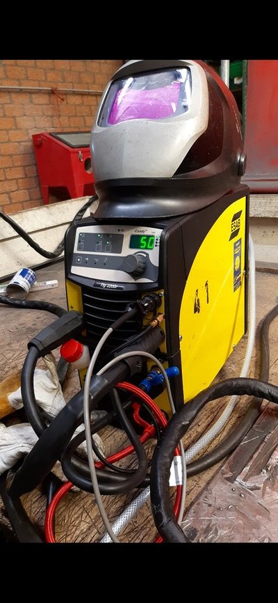

I own an Esab Caddy tig 2200i ta33 welder with water cooling.
There seems to be a problem with the Hf starting. It goes well for a few times and after that the spark fails...
I have thought about several causes.
Including the cooled torch. But with the another equak torch the problem is still there. I also changed the tungsten rod. No change :-(

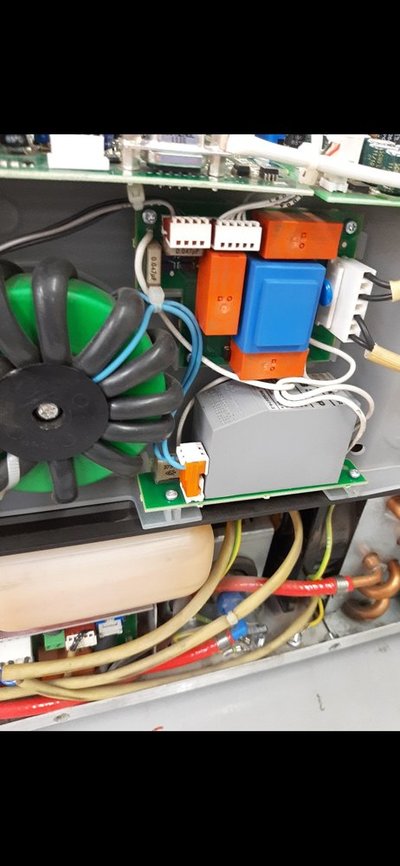

Since i have a second (broken down) welder witha fried control board i could change the tig board and pulse generator from one machine to the other. Also no change in my problem.
