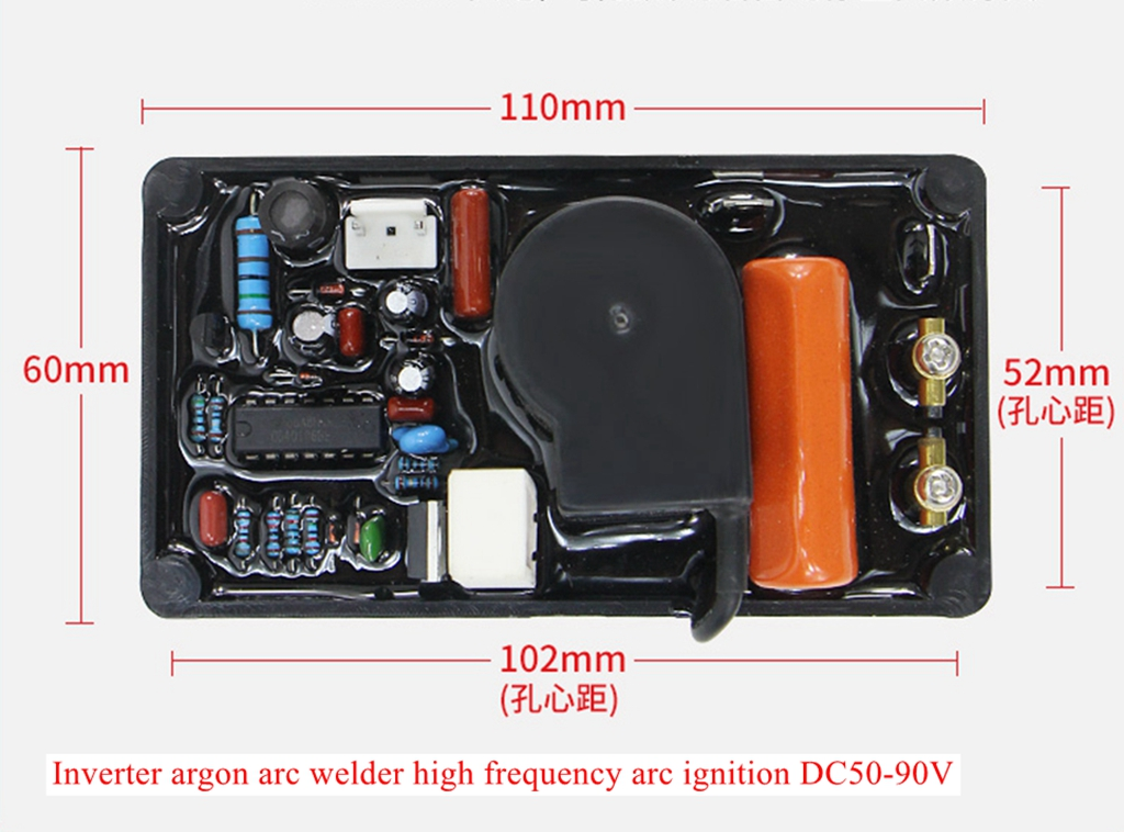

I've sketch out a rough (very rough) circuit for this, and from what I can see it will not generate a spark on its own. It needs a drive into the 2-pin connector adjacent to the 24v input. I would say it's looking for a square wave or similar.
