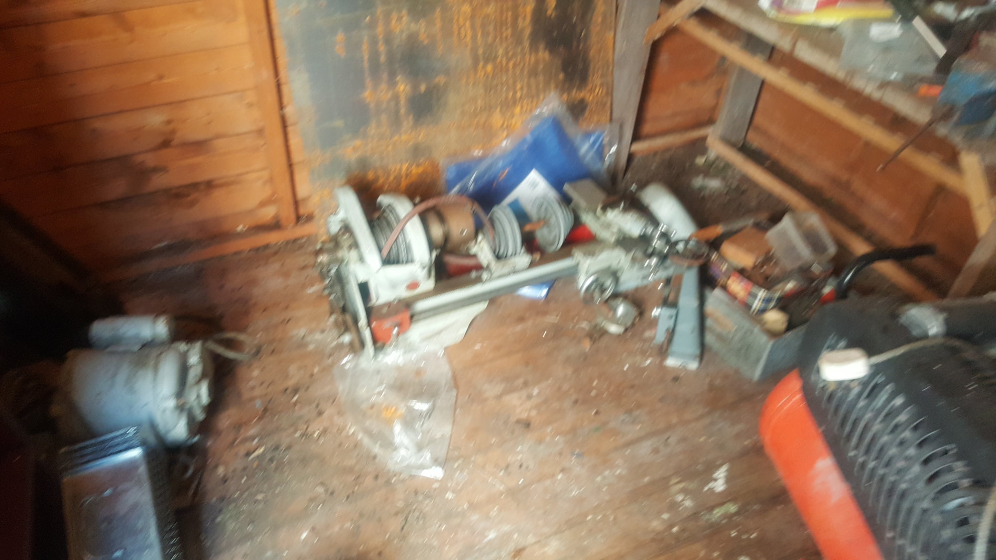

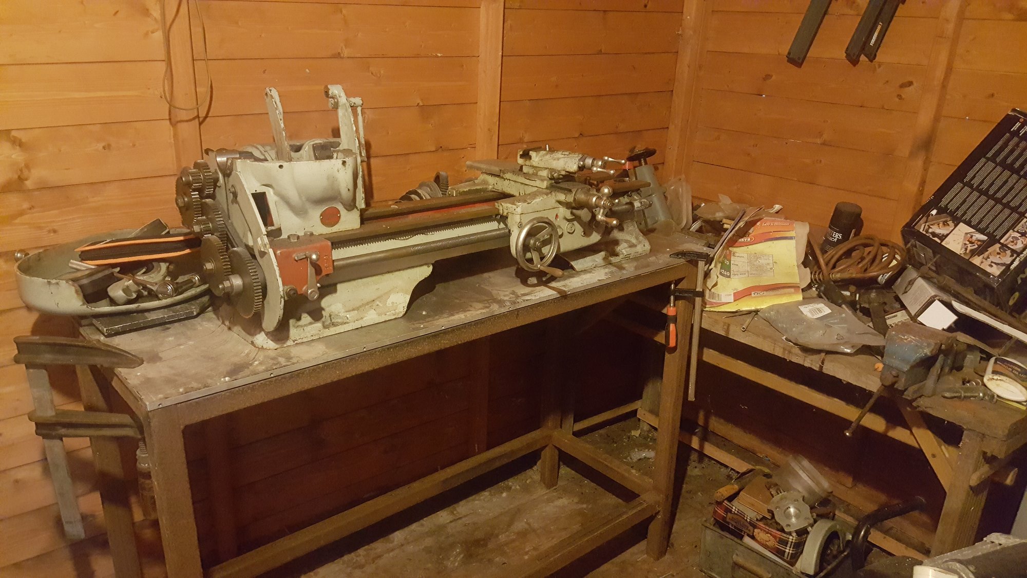

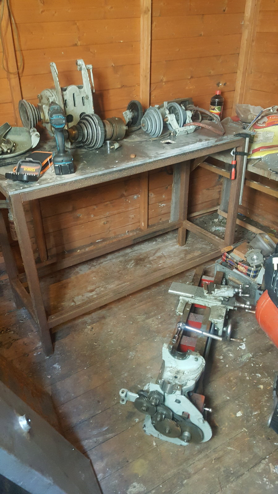

First impression, for a small lathe, it weighs a ton, which is always a good sign!Excellent. i'll be watching with interest as I've decided to make a start on mine after deciding not to weigh it in.

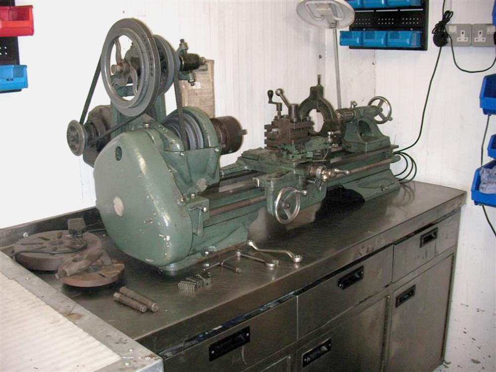

I was confused, because everything I've read about them says the motor is mounted separately from the countershaft, yet this one clearly has the motor mounted on the countershaft bracket, and looks like it was made that way.
Yes, it has quad pulleys throughout, and has plain bearings. Thanks for the tip. I was surprised, because with the back gear, that would give 32 speeds, but if it should be a double pulley that explains it, sixteen is a good selection, but not a ridiculous amount!Mine had the motor hanging off the countershaft bracket. Yours has the wrong pulleys on the motor and on the end of the countershaft. Should have quite a small double motor pulley and a countershaft pulley of something like 10 or 11" Diameter. Does your one have ballrace headstock? If so then it shouldn't matter much how fast you turn it but if it's the plain bearing variant you should take care with the top speed and monitor the bearings for heating up.
About the same size as the myford ml7. 6" by 18" with all sorts of attachments available.Looks like a proper bit of kit!
That's a lot different! I'll run it on the slowest speed from the motor until I can find pulleys the right size. What oil should I use on the oiling points? I'll need to figure out what belt I need too as the motor belt is missing.Here's what the original pulleys looked like. The big one with the curved spokes ran with a bit of a wobble, and every other one I've seen did also.
