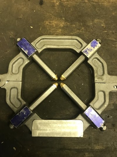

My first proper build with the TS light vertical, other than a little oscillating steam engine.
This one:

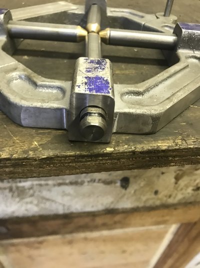

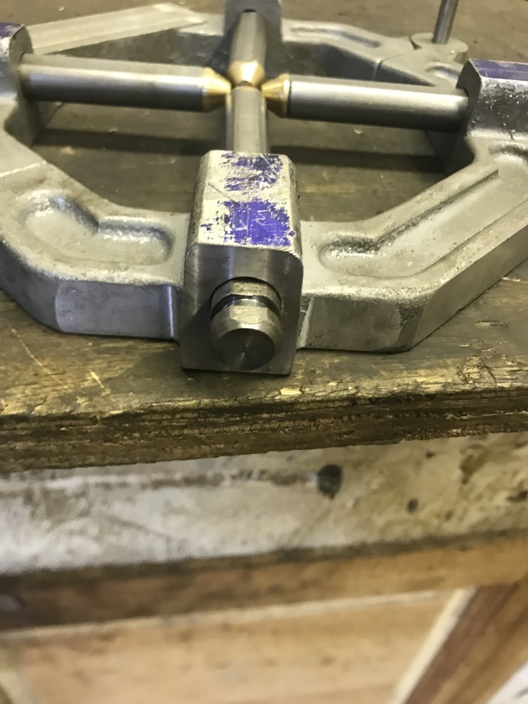

Going fairly well, but I’ve managed to bore one of the holes for the steady fingers at a slight angle. The other three meet in the middle nicely.
I’ve bored out the offending hole oversize, at the correct angle. The plan is to fit an aluminium plug, then rebore it. Which loctite for the plug? I have 271.
Press fit might be tricky as I don’t want to move the part from the vice.
