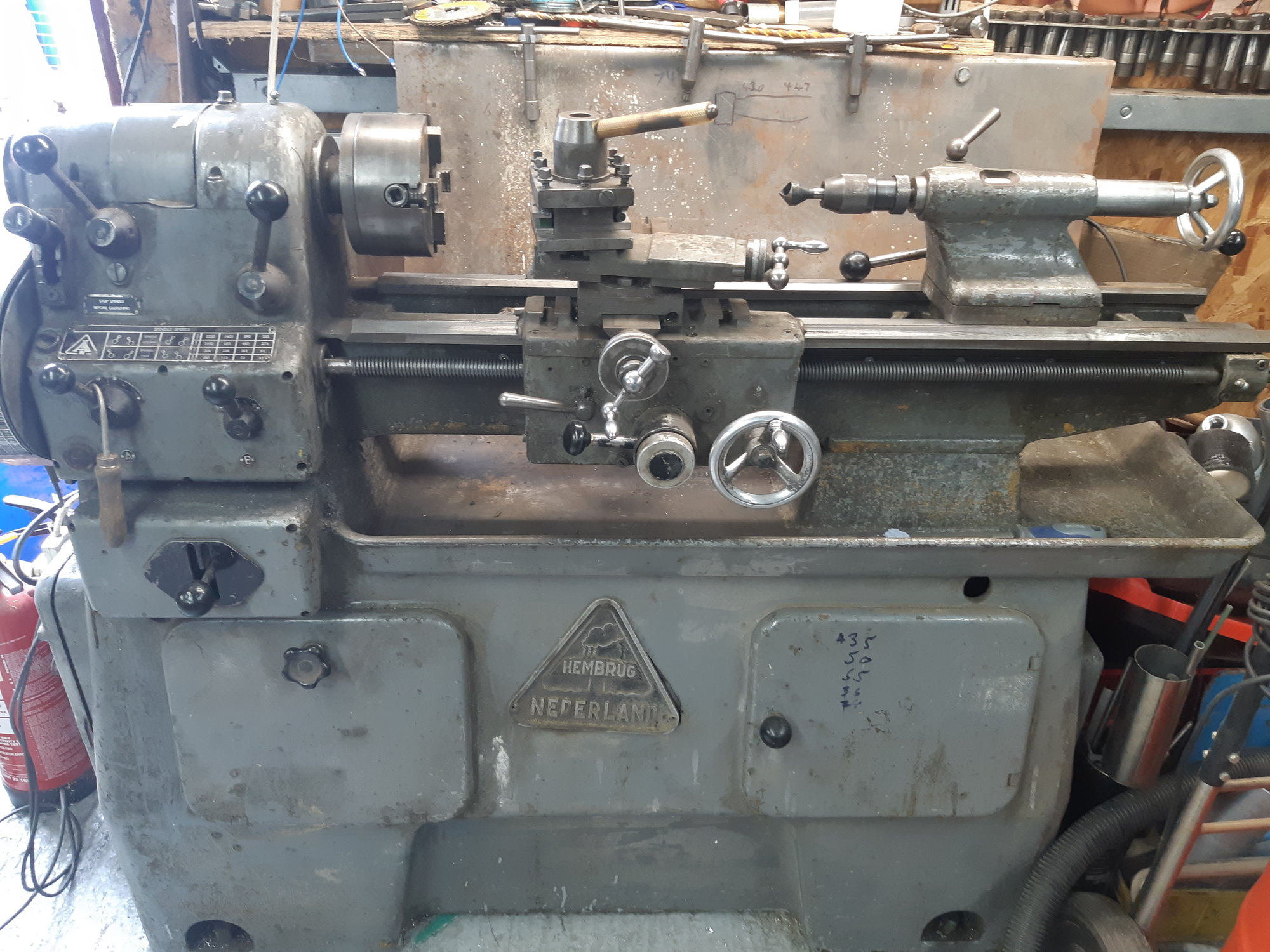

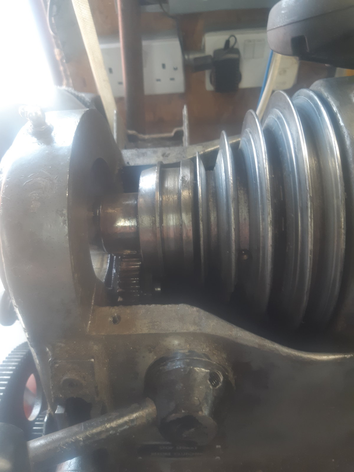

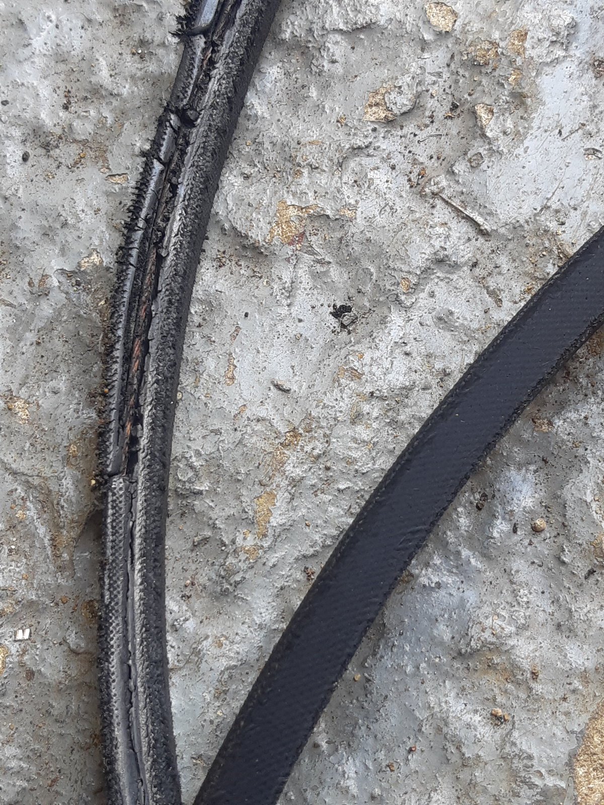

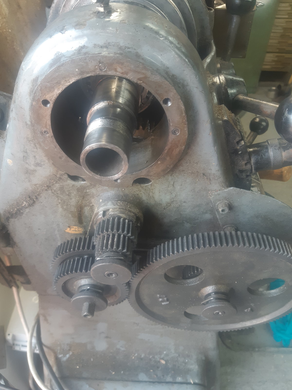

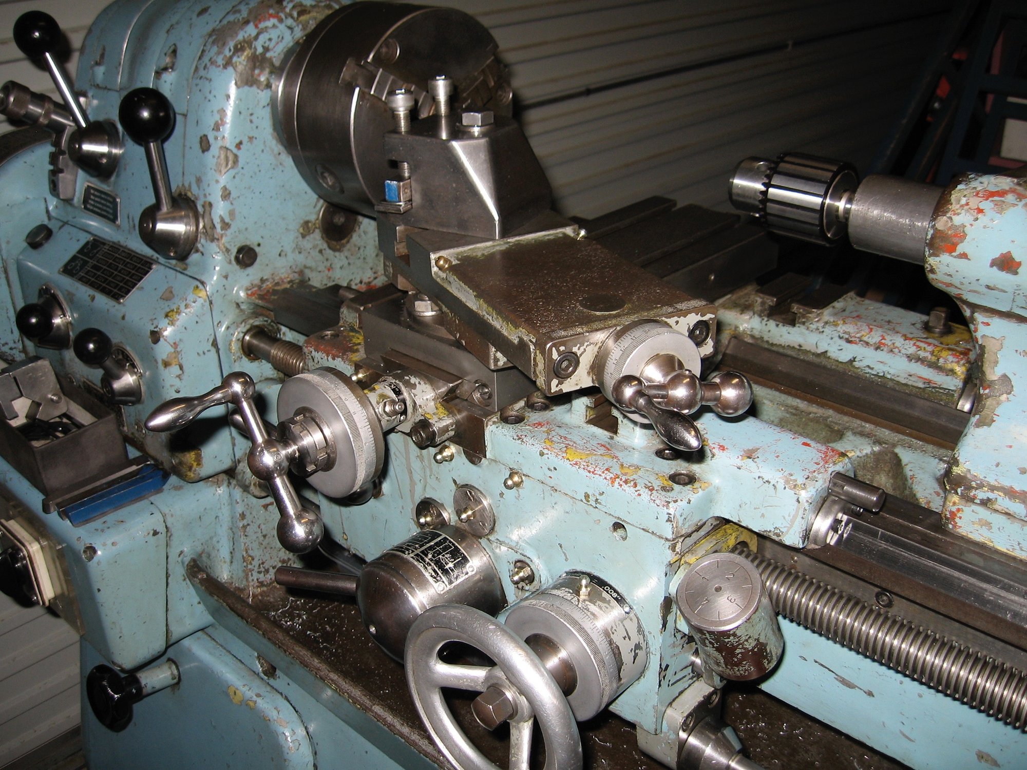

That looks like a serious lump of compact steelView attachment 235064 Anyone got one? Looking for how the headstock comes apart, and more importantly goes back together. Need to change the belt
Weighs more than I 1ton engine crane wanted when I tried to unload it... ended up jacking the back of the van up... taking the weight with the crane then dropping the Jack's and driving awayThat looks like a serious lump of compact steel
Now that's a nice one, I am prejudiced but I think this is the best lathe in this size.
Was wondering if these were ever sold in the UK.

Found and translated from a dutch site:
Incidentally, a belt is fairly easy to replace, you take out the rear bearing bush (which contains the ball bearings) (you can press it with 2 or 3 m6 bolts from the fixed head) and you have to loosen the left fork. then you have just enough space to put the v-belt around it.
It's if you're a little handy in half to an hour of work ;-)
