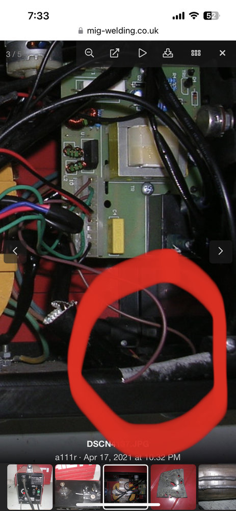

Open up the side panel - look for brown wires that’s under a black sheath - one off these wires will either be corroded or burnt - very common on this model had several with this fault - clean up connections - I normally strip right back - recrimp with ring terminals ( heavy duty ) bolt them together and heat shrink
