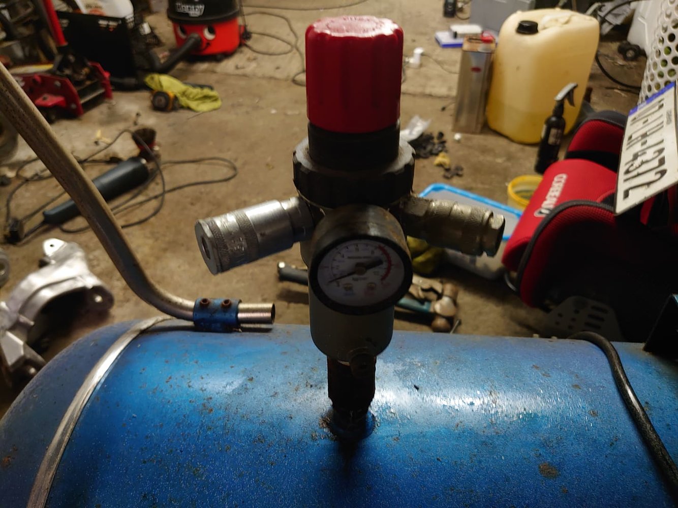

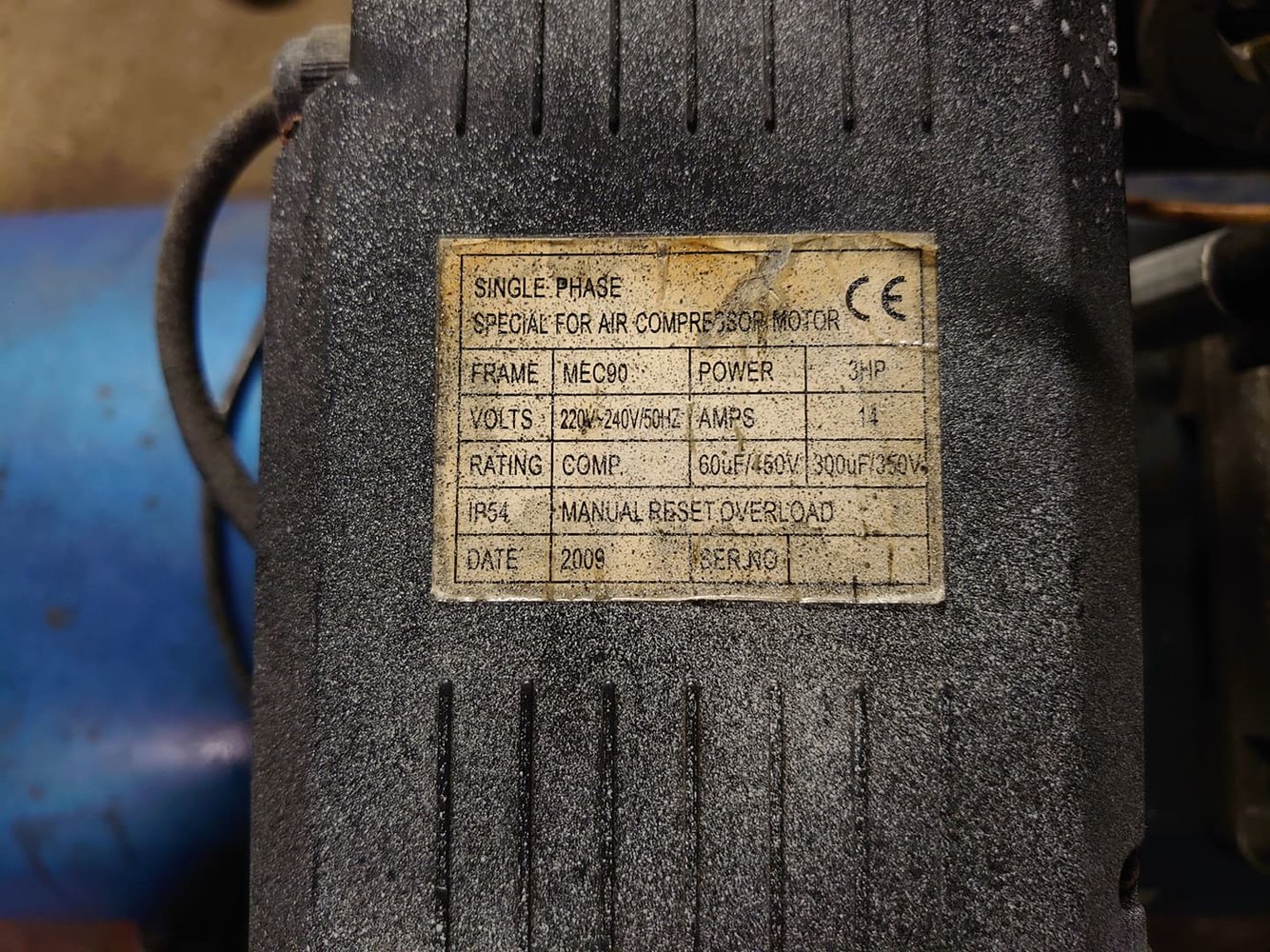

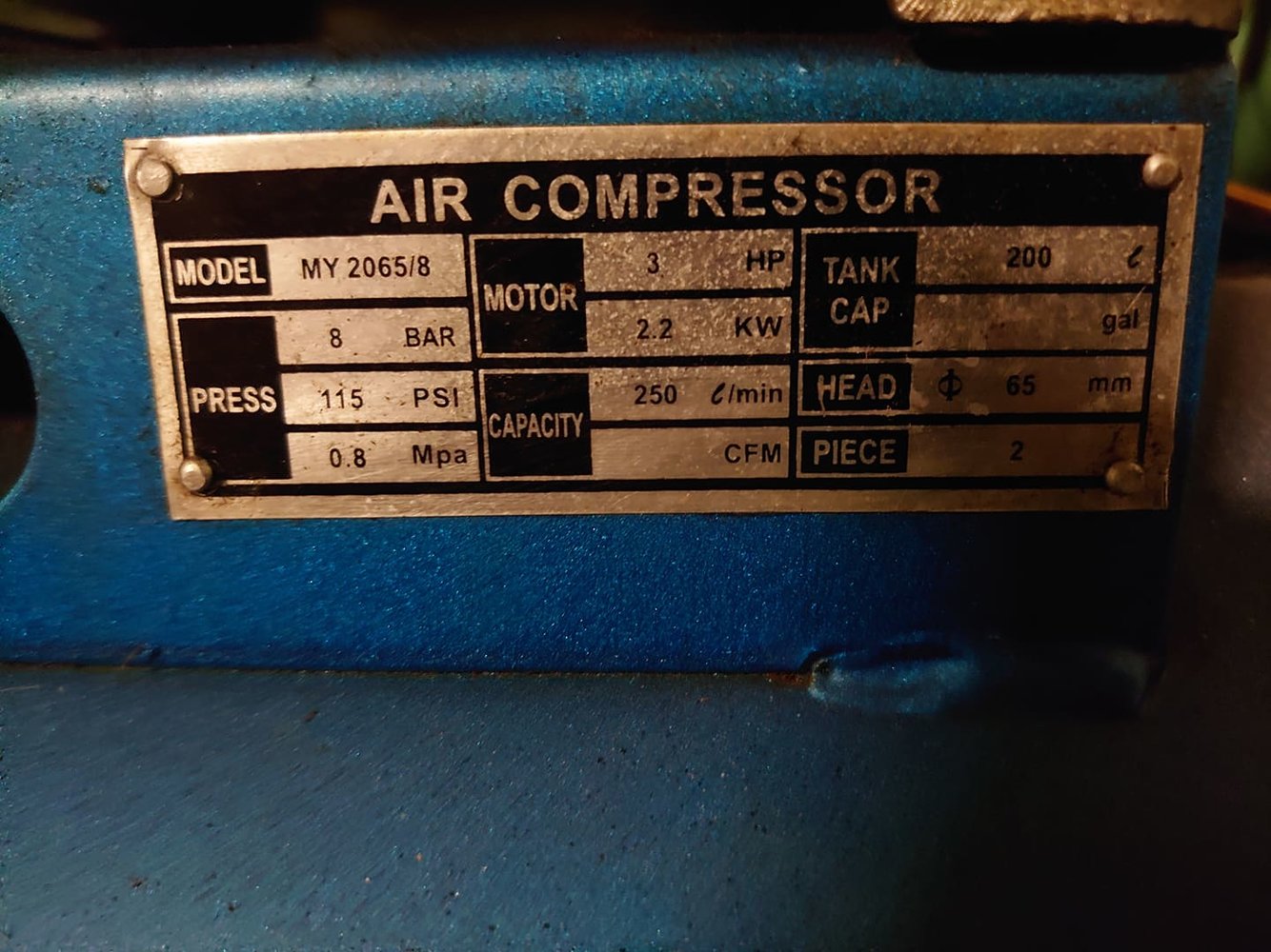

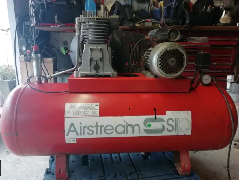

Hi guys,
I've been offered this compressor for sale to me from somebody semi local. The price is €300 euro.
Would somebody mind looking at the pictures and telling me what they think, if it's suitable for me or not please? I converted the air flow from l/min and it's 8.8 CFM. Is that enough? I feel like it may not be? 115 PSI also seems on the lower end but might do as I see most stuff runs about 90 PSI.
I would like to use this with my die grinder and orbital sander mainly.. also spray paint too (provided I get appropriate filters/traps).
It also appeals as a cost effective way to get a 200 litre tank, considering I may have to eat the cost of the 50 litre if I can's sell it :'(
What do people think?
Thanks a lot in advance.
