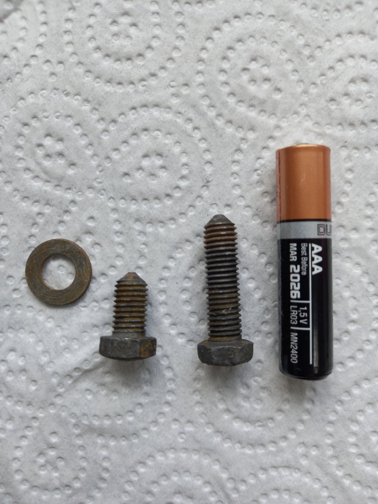

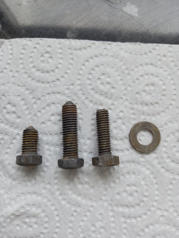

If a broken bolt could cause an accident I would stick with steel like for like strength (or better).Yeah sure bolts are for my 1970s roof rack restoration.
Its not a vw roof rack not sure on brand but its from the 70s and my dad had it on his vw beetle . Its been in my garage for 30+ years . I decided to restore it and bolts have to much rust to use again .Assuming they're metric, measure the diameter across the thread crests (major diameter) and distance btwn threads (pitch) and compare to standards for coarse and fine. M8 coarse is 8x1.25 mm and M10 is 10x1.5 mm. They're probably not imperial if off a vw.
Yeah I do have a caliper but its dead and have not got a battery for itNo-one can identify a thread with their eyes, at least not unless you already know what threads are used on a particular machine

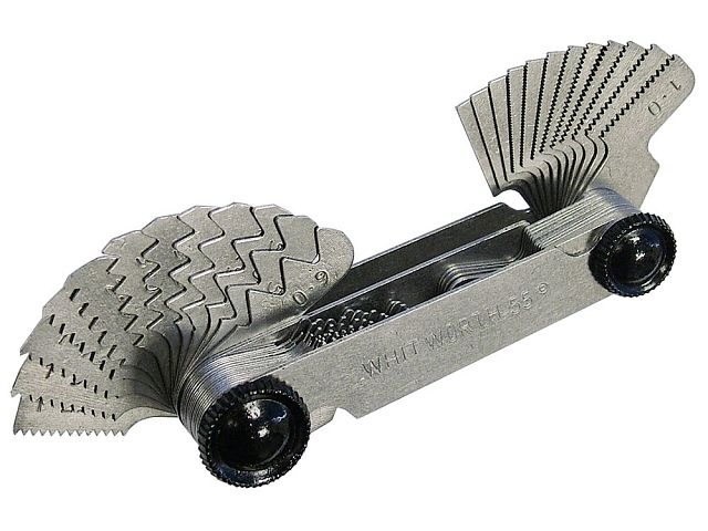

The reliable way of measuring threads, is a thread gauge, a caliper, and a Zeuss book. I highly reccomend these three tools to anyone at all who doesn't have them - they don't break the bank, and they'll bail you out on enough occasions to be well worthwhile!
MikronTec, 52 Blades Thread Pitch Gauge | RS
uk.rs-online.com
See? not expensive. You should have a caliper anyways, you can buy a cheapie for a tenner, and you can use the internet to look up Metric/BSW/UNC thread sizes etc if you're too cheap to buy a Zeuss book.
but I shall invest in the above. ^^^^^^^^^^^^ WHS ^^^^^^^^^^^^No-one can identify a thread with their eyes, at least not unless you already know what threads are used on a particular machine![]()
But Bladevane's guess could be close.From a quick scale of the thread diameter and pitch relative to the battery and taking into account they are from the 1970's I would estimate these are 1/4" BSF. The real test though is accurate diameter and pitch measurement then relate those to Zeus (or similar) tables.
A good clue would be the spanner size that fits the head.... ...Still need to identify thread pitch though.
I get the same result, scaling on screen, counting threads and using vernier calipers. BSW, UNC and UNF are too far out with the TPI, which comes out at 25.5tpi for me, thus 26 BSF.By scaling the battery photo to a real AAA battery size, the thread is 1/4” x 26 TPI i.e BSF
