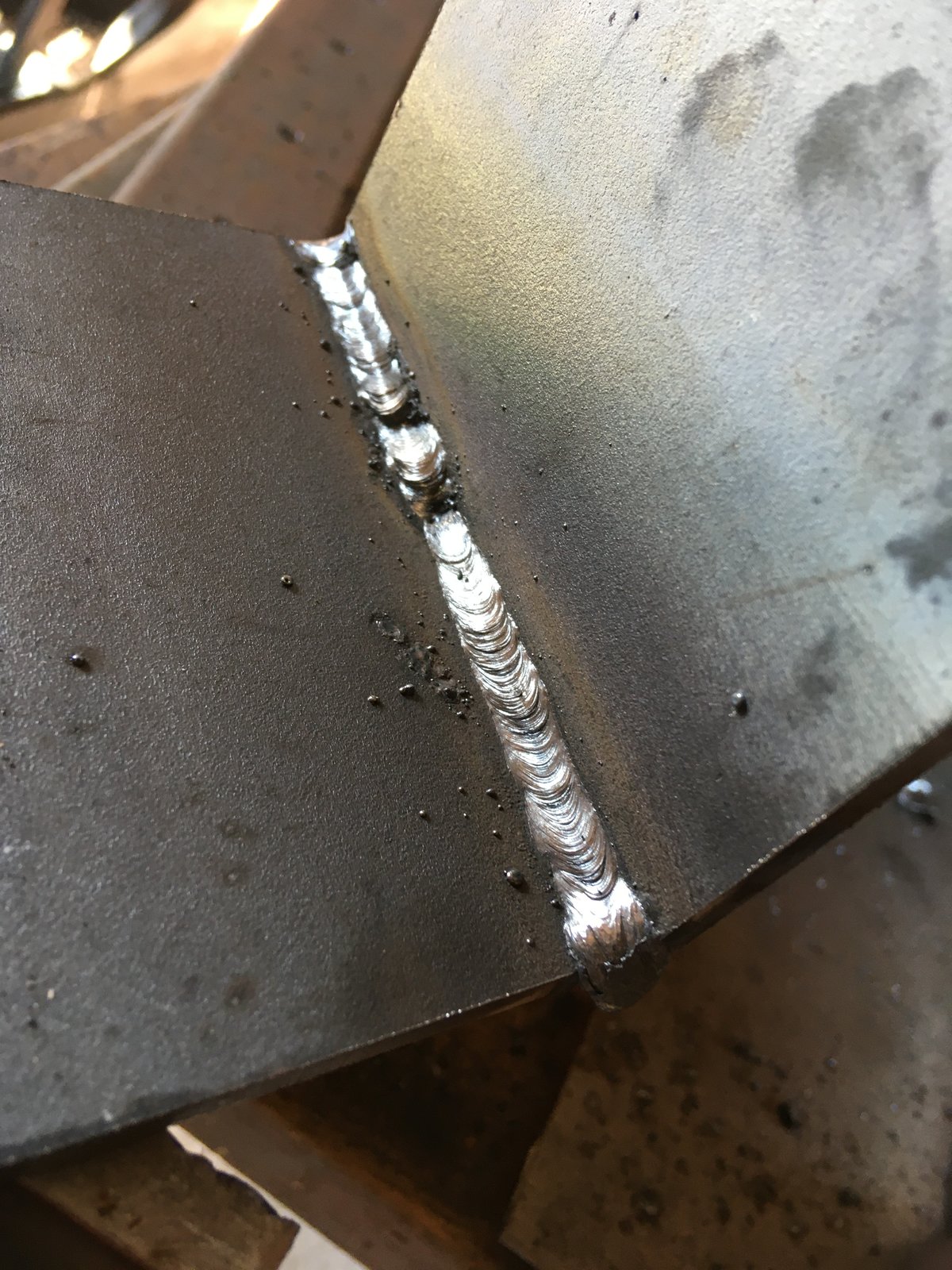

Another go today (AC).
Root pass, have to stop half way as it takes the garage breaker out otherwise.

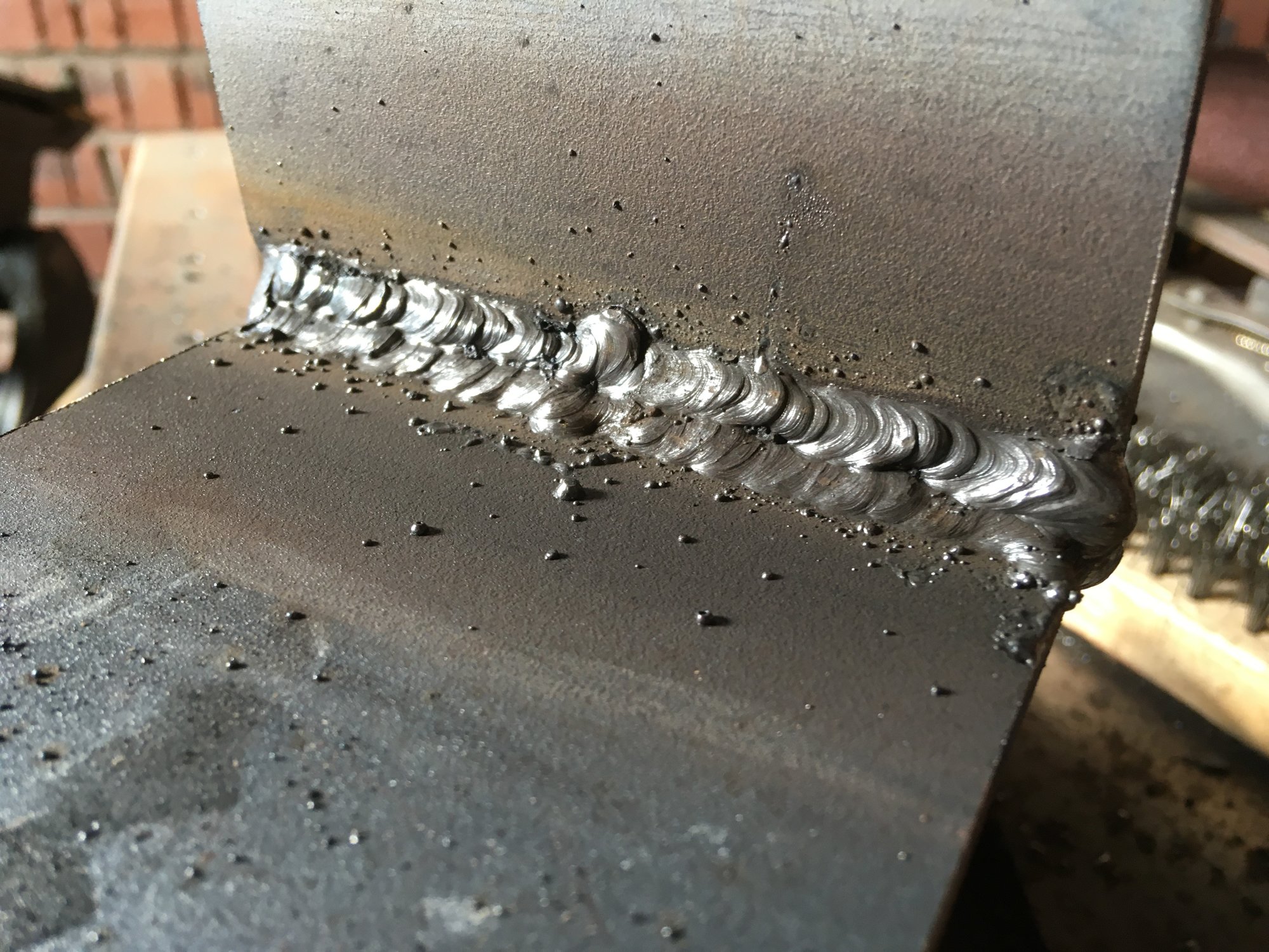

couple of passes over the top (again stopping in the middle to stop the breaker tripping), not very neat but they're continuous beads which is progress
I find I'm almost dragging the rod against the steel with the flux it is so close, my arc length has been way too long for years on all positions I reckon. Every day is a school day as they say![]()
