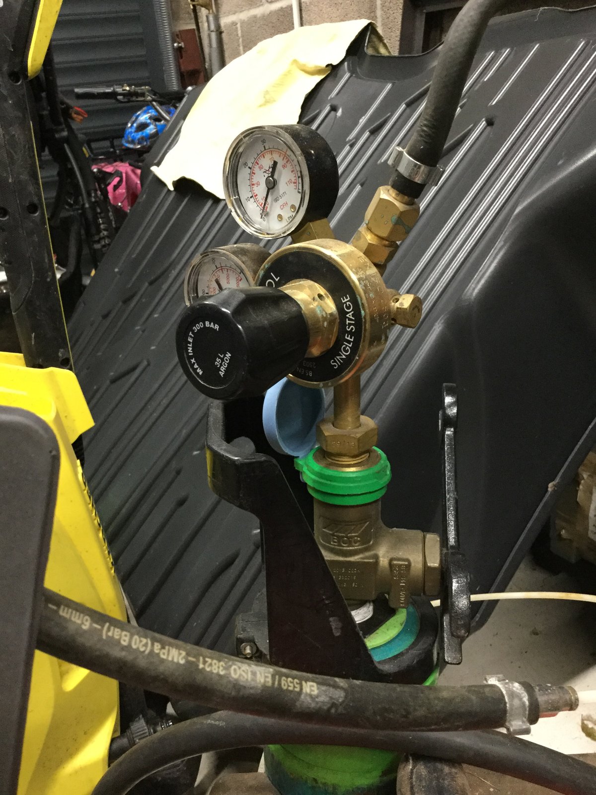

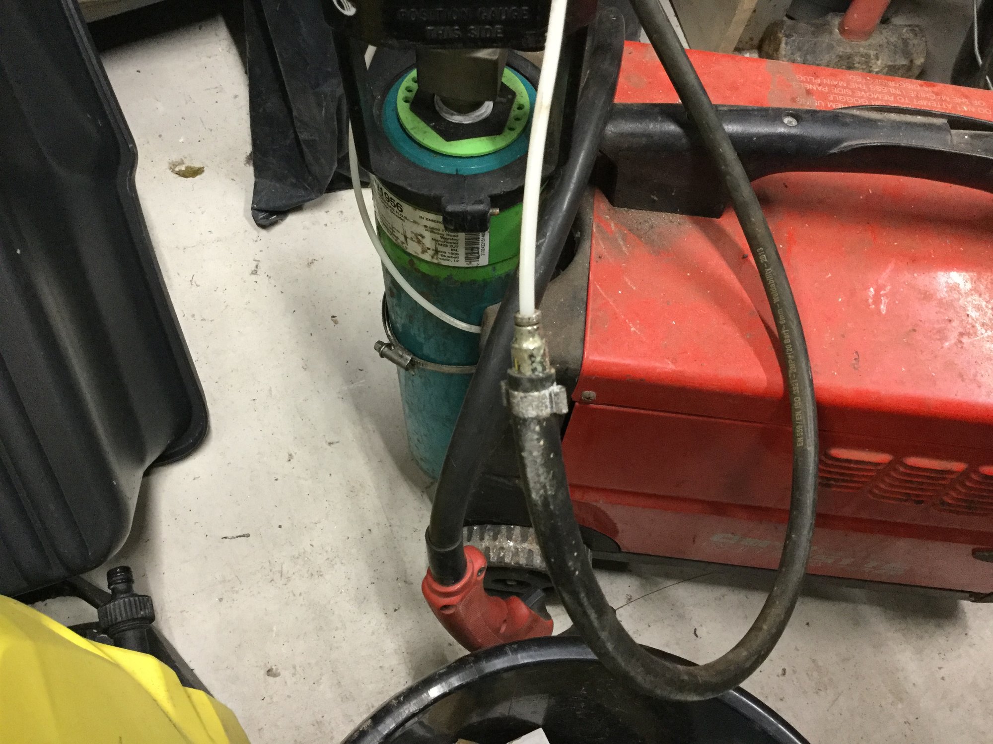

    Here’s mine on the same welder. Can’t remember what the bottle size is but it’s About the size of a fire extinguisher (which I guess is as long as a piece of string ) from boc. Prices went up recently but about 50 for the year from memory and about 30 for the fill.
    Regulator was from weldequip on here and I’m pretty sure it came with the little adaptor to allow the plastic tube to just push in.
    Looks like I need to give it a clean looking at those pics.
    The other thing I can’t recommend enough is upgrading the earth lead. Again I got one from weldequip and connected a push in plug (dinse?) to the front panel. It makes a huge difference to the weld. It just wires into the existing cable inside the welder itself.
    Hope that helps.
