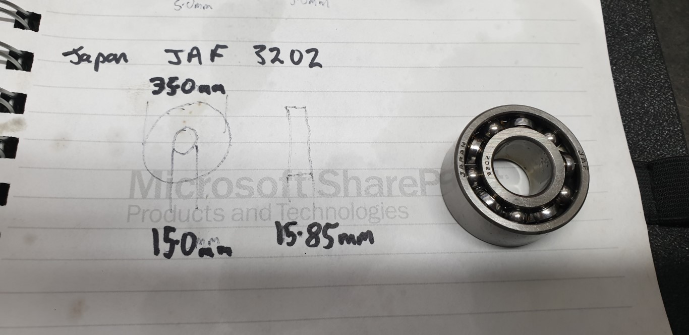

1. Main Bearing for the wobble gear - probably takes the most abuse

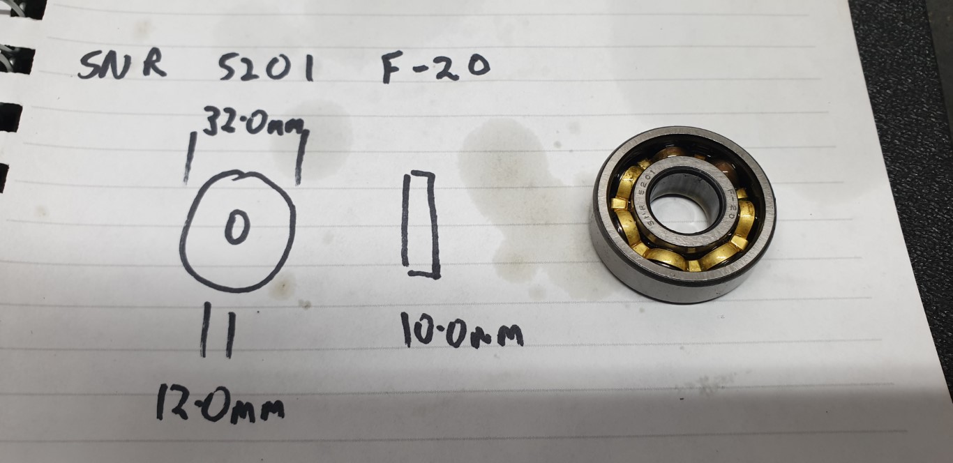

2. Bearing that supports the gear/drive shaft

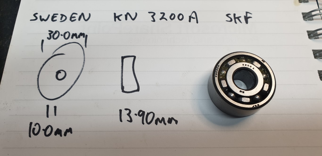

3. 2nd driveshaft bearing

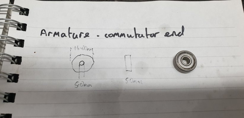

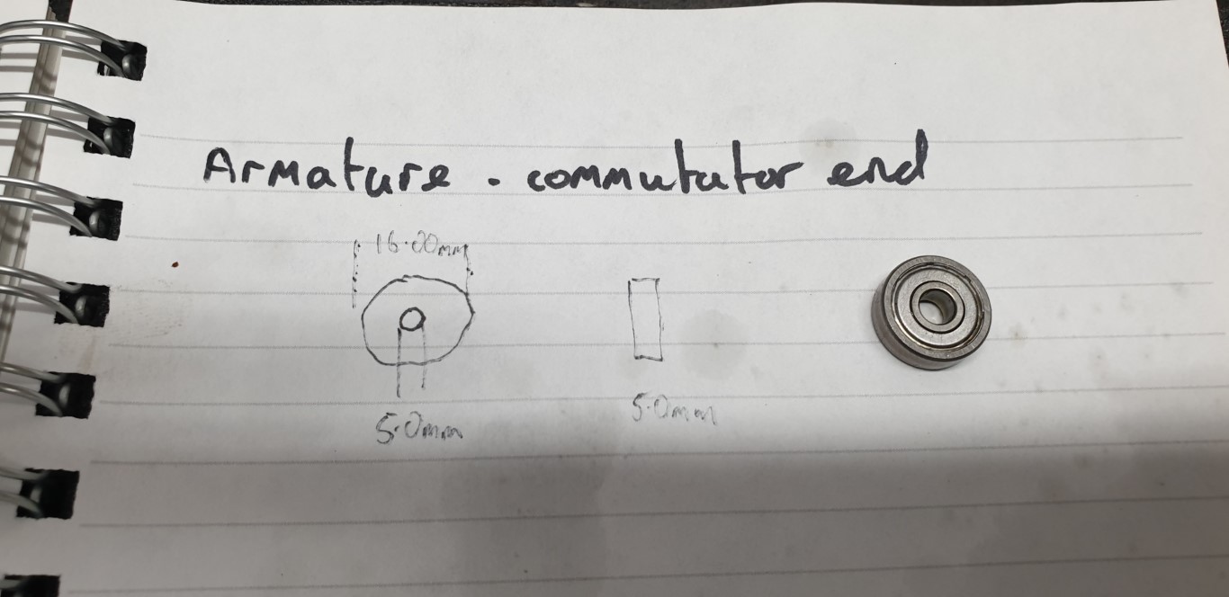

4. Armature commutator end bearing

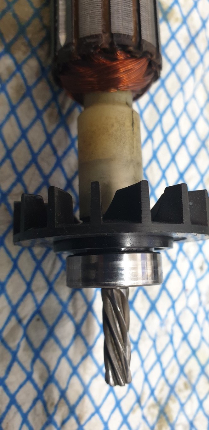

5. Armature fan end bearing
On this last one measurements are approximate as I haven't figured out how to remove it yet
, very small gap between back of bearing and fan - any suggestions?
