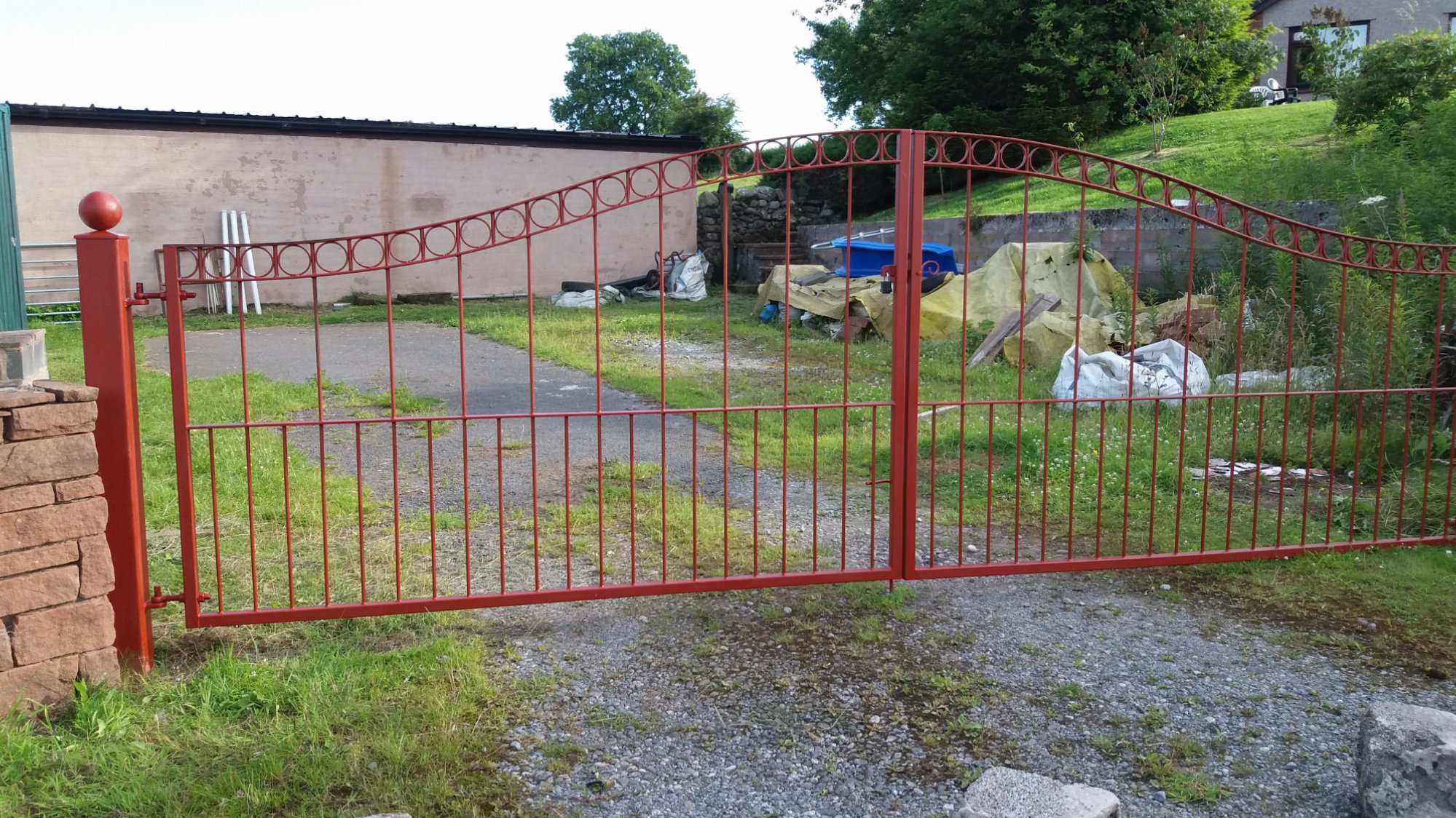

Hi guys well got my gates hung yesterday and painted them with No Nonsense Red Oxide Primer from Screwfix, lovely stuff excellent coverage and smooth drying. Set off this morning with a tin of black Hammerite gloss and was very disappointed in the result, very poor coverage so I have left it to get advice as to what is best. Really I would like to give them a coat of black gloss that will cover in one go, what would you all recommend please.View attachment 87766 gave up after a
How many coats of high build vinyl do you think I would have to applyHi build vinyl used for the gates round here[shipleys].
plus 2 for hibuild just a couple of coats. it will hand paint but spray is faSTERHi build vinyl used for the gates round here[shipleys].
u can thin it with cheap celly 5 quid a gallonHi build vynil put it on with a foam roller is the quickest way now it fitted

Xylene it's in the paint to begin withu can thin it with cheap celly 5 quid a gallon
the hammerite gets thinned with celly alsoI've switched from Hammerite to Tractol for all my workshop gear, and happy with the results brushed or sprayed. Can be thinned with 10% xylene for spraying, which is way cheaper than hammerite thinners at 50%
I got some lidl black metal paint what can I thin that with for spraying?
My friend sprayed his bike frame with it and as BS says, he just used cheap cellulose gunwash thinners and it came out perfect. Best thing to do is try a spot of paint and add whatever you are thinning it with and if it "curdles" it won't work.

Hammerite goes on ok thinned a little 20% and warmed up. If you don't do that it doesn't cover or spread well if used straight from the tin unless you apply it really heavily and then it runs.
