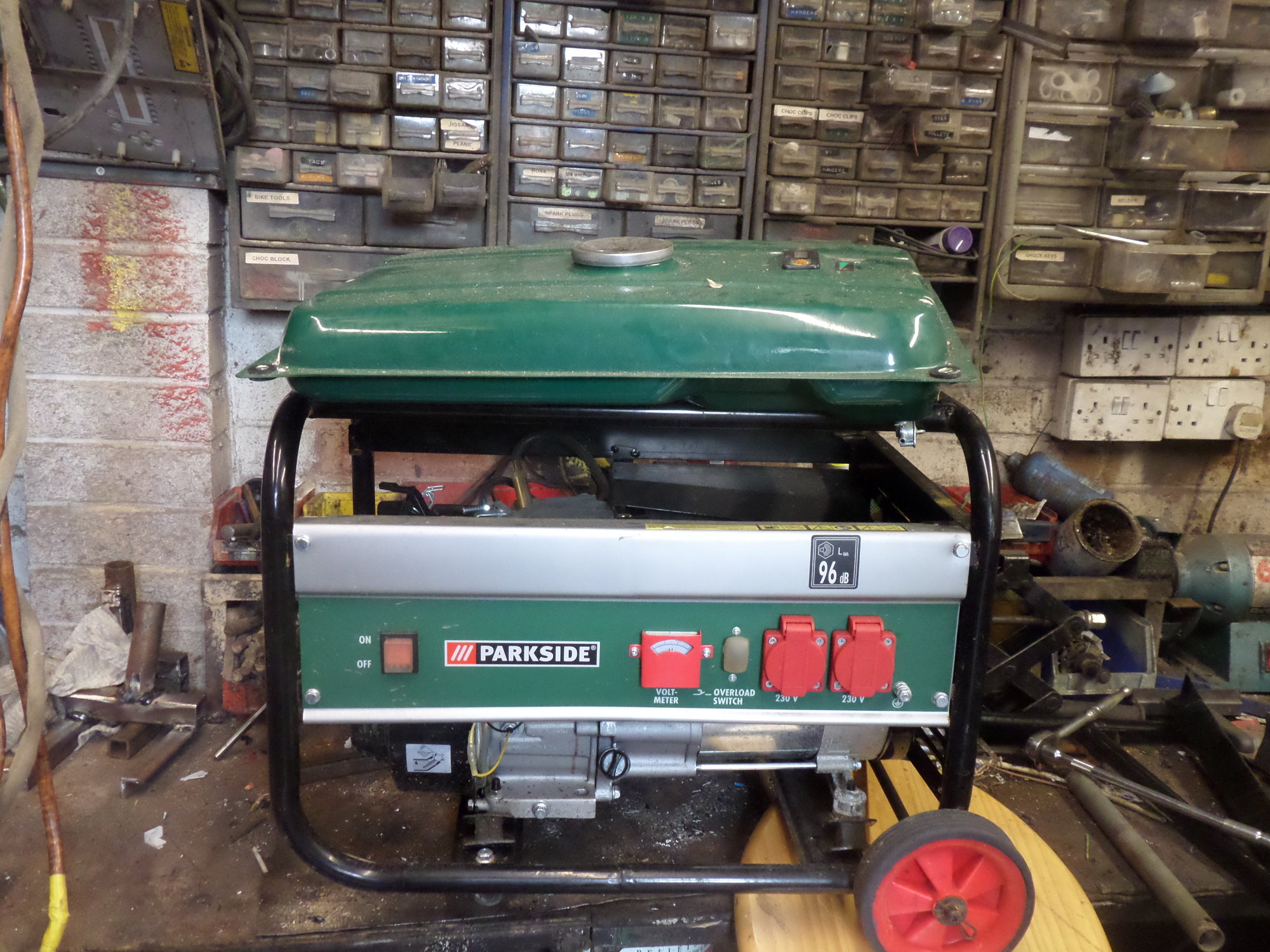

washer betweeh the exhaust port ogbthe cylinder
Seal that with non setting gasket material. when re-assemble.
Removed it and haven’t refitted it yet, previous post was without the exhaust fitted.
Have a watch of https://www.youtube.com/user/mustie1 on youtube, you'll find everything you need to know about getting old small engine stuff running.
before you bin it, some 5 minute checks to make sure..
- check the connection to the spark plug cap, they can be pretty poor, a lot are just screw on to the wire which is a pretty Jabberwocky method, but it's cheap, but also prone to corrosion..
- you could also try another plug, don't need to buy one, any plug to at least prove the theory if theres spark, if the coils are gone or it's a dodgy connection.
- Could also be a low oil / pressure switch blocking the spark stopping it running... is there oil in it... sorry for the basic question, not meant to insult your intelligence in any way...
- stop start switch, try it on / off a few times in case it's a dodgy connection / contact
etc etc worth a quck look anyway.
just tested a two stroke chainsaw coil, sorry it's not a generator, but the only 2 stroke I've got on the bench at the moment. Don't know how comparible the values are, but might give you some idea.
positive coil to plug lead, its showing 8.4 K Ohm.
coil terminals / windings 1.4 Ohm
sure its got the right spark plug in ?
...but you said you had a good spark?
I feel cheated.![]()
