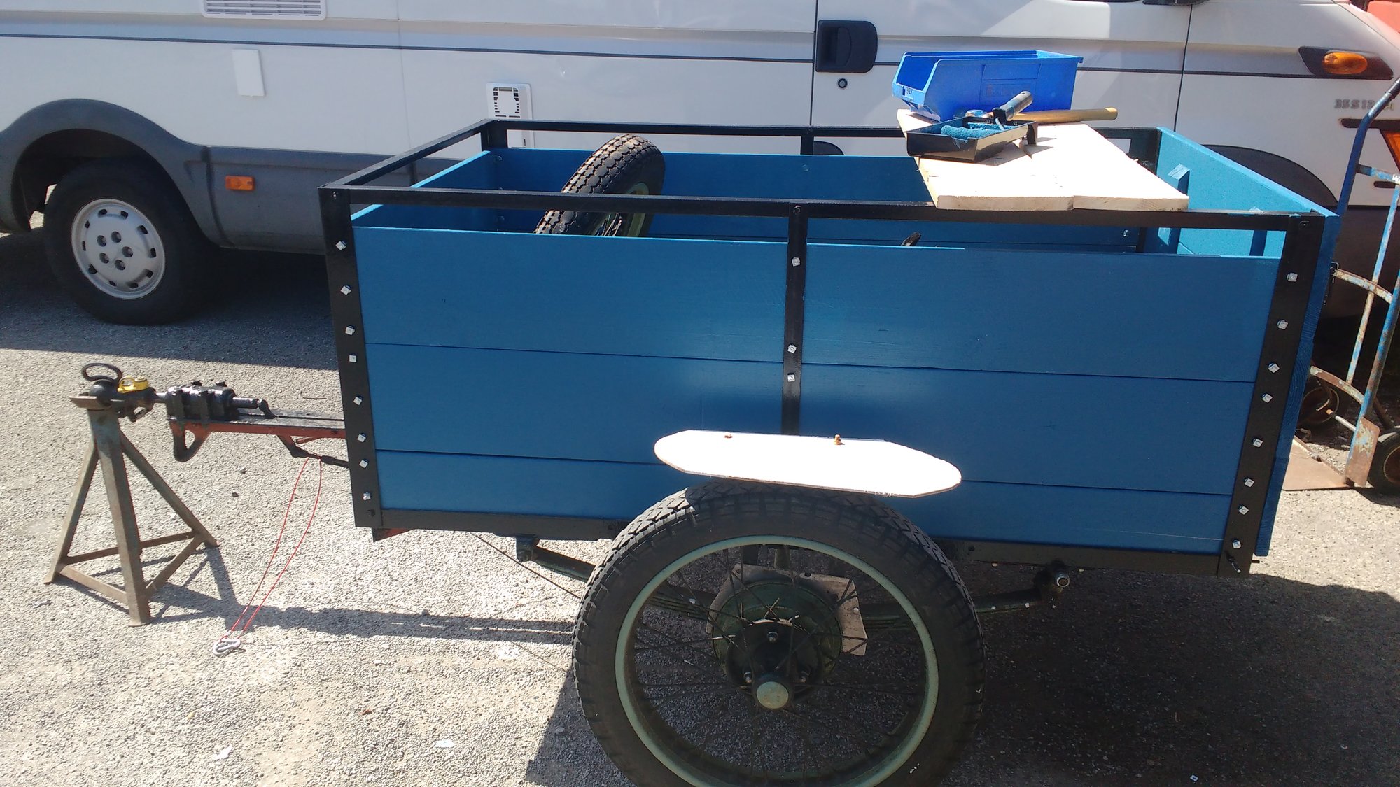

My local car boot has a nice chap who buys all the off cuts from a place that supplies the proper boards for lorry and trailer floors, he only has small bits often 6ft long but only 2 ft wide so I have two pieces ready for it, I might even plank over it in timber to keep the purists happyI once used marine ply for a trailer floor and it only lasted a year before disintegrating. Use phenolic ply (might also be called buffalo board, not sure) it is about twice as much as standard ply but it's very tough and will outlast it many times over and is worth every penny imo.

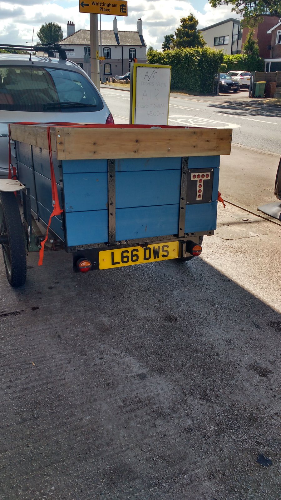

Not required as its a 1930 trailer they used a letter T on the back, many are just painted mines a posh one as its reflectiveWhere are you reflextive triangles?

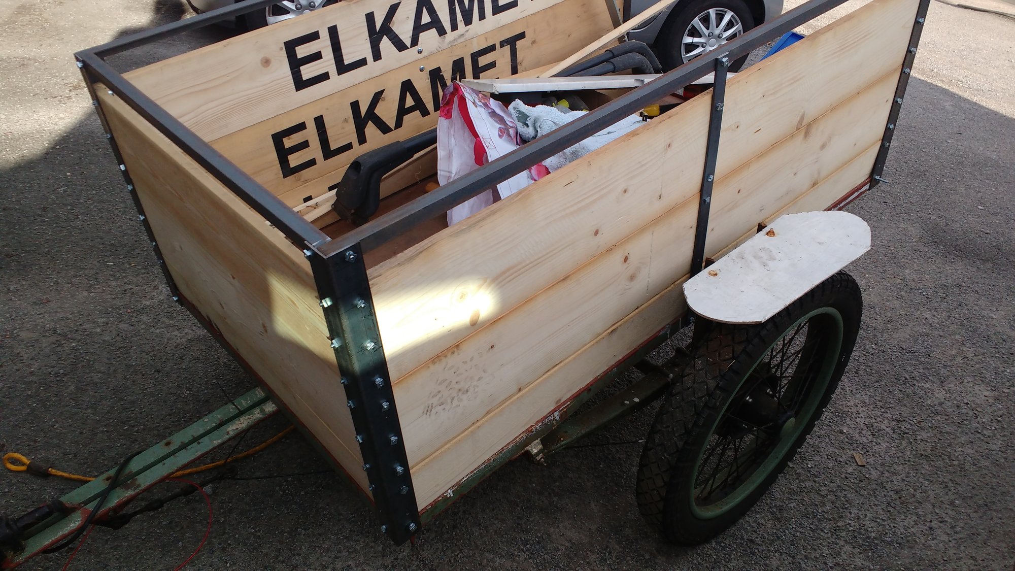

same here. nuts on the inside it looks messy and there not all in lineCan't you get the wheels re-spoked?
I would have thought the bolts would have had the heads on the outside?
they want turning and painting
spoils a good job
