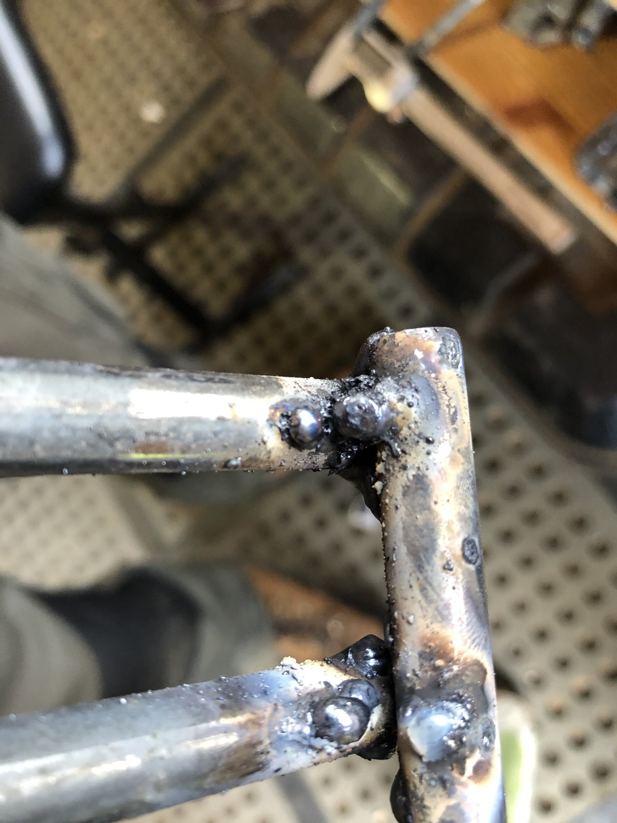

    Hi,
    I just bought my son a Clarke 115N Easi-Arc Welder to get him started and all was going well unil he tried to make a grate for the BBQ with 10mm round stock. The problem he is having is that when he is welding there is far more slag than weld when he breaks off the slag there is very little weld the electrode also keeps getting stuck. He has had no problem with straight welds but this is really getting him stressed.
    Any help you could give would be very much appreciated.
    Thank you
    Tim

  4. TimSchofield New Member
    Messages:
    3
    Location:
    Somerset UK

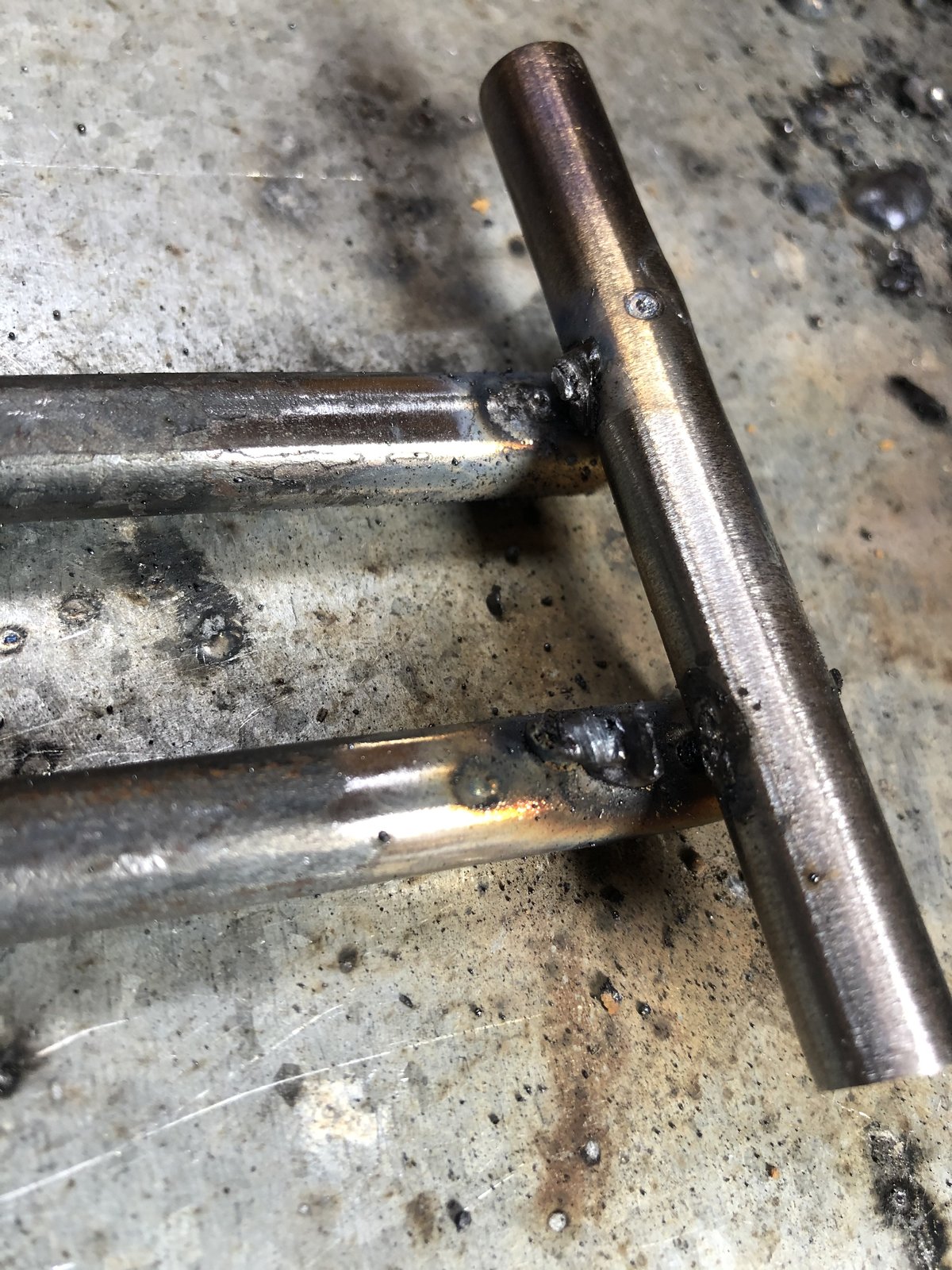

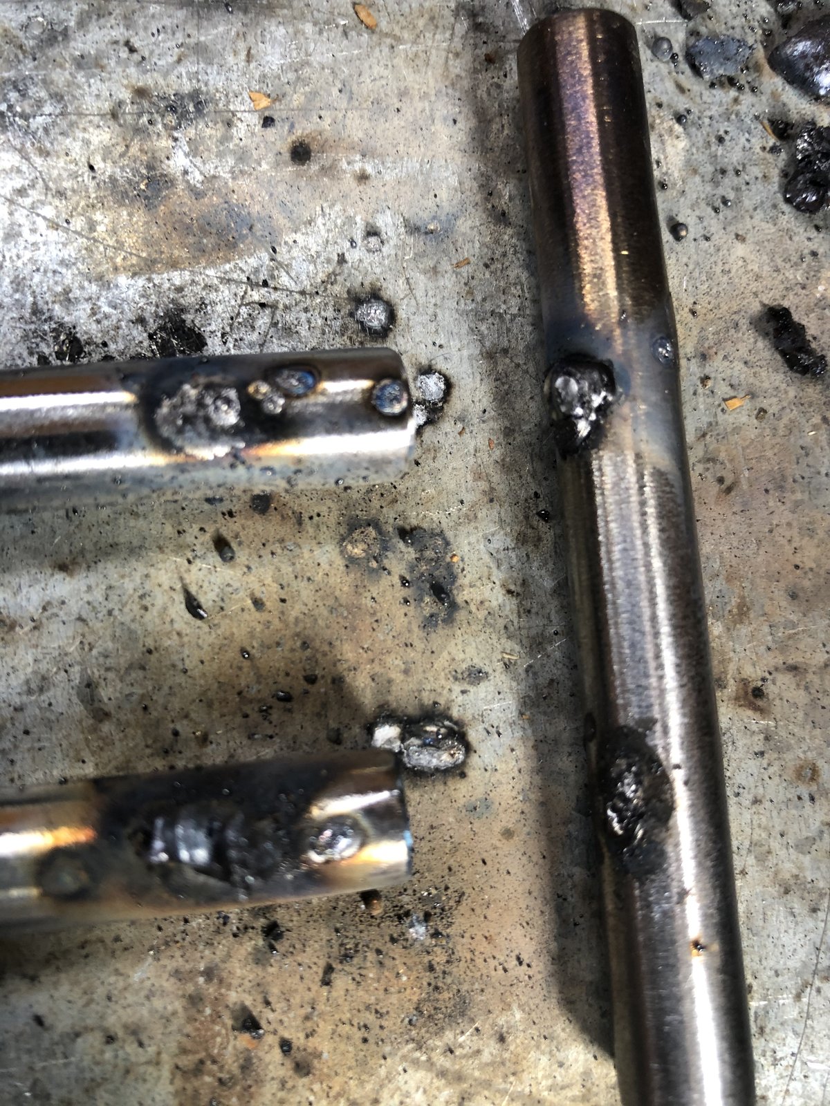

    Thank you he has ben striking on some scrap steel, would you say a sideways weave would be just moving the electrode from left to right? Why does it keep sticking? Some photos uploaded!!

    Current is too low, a joint like that needs a short hot tack, with a 2.5 electrode I would hit that at around 110 -120 amps, strike on a piece of scrap to warm the electrode, break the arc then move straight onto the job, the higher amps will let you keep a tight arc and get into the corner,
    metalmelt, 8ob, Liam567 and 5 others like this.

    Stick welding is more difficult when the fit up is poor. As the joint is two round bars meeting at a single point the fit up is naturally poor. I’m no expert but I’d do as Paul says and if that doesn’t work try grinding the bars flat where they meet to lengthen the joint and close up the gaps.
    metalmelt and jimbo84 like this.

    Definitely mild steel and not stainless, he has E6013 rods I will get him some E6011 but turning the amps right up has really made a big difference his temper is now cooler than the welder!!!
    Thank you all so much, we can now get back to an slightly easier life in lock down :)
