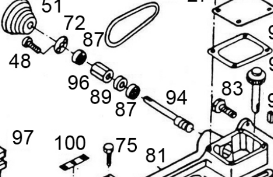

Yes, I'm pretty sure this is the function of the retaining plate as I said earlier - item 72 in this drawing (item 94 is the shaft with the worm on the end):
The forces on the worm shaft from cutting will be trying to push the worm shaft out of the gear box, i.e. pushing on the retaining plate.

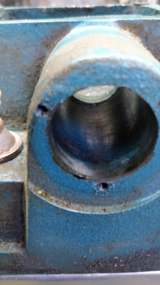

I haven't tried pushing it in, but it might be worth a punt. It doesn't look like there's a lip on the inside, but I can't be absolutely sure. I'll get some more photos from different angles this evening.

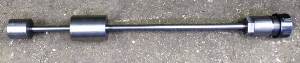

I've got some ER collets and collet blocks, so I might try gripping the shaft with one of those (they hold all the way round, are very firm and shouldn't damage the shaft). That might give me something to work with.

I'll take some more photos tonight. I'm pretty sure the bearings are 6202 size: 15 × 35 × 11 mm. The reason I mention this is that there's only a 6.1 mm gap from the end of the worm shaft and the boss on the casting, so I won't be able to drive it in far enough to get full access to the bearing to cut it.
Not necessarily.
As it's a bandsaw, it should only ever run the one way, so it could simply be relying on the force pulling everything against a boss.

got any more photos?
