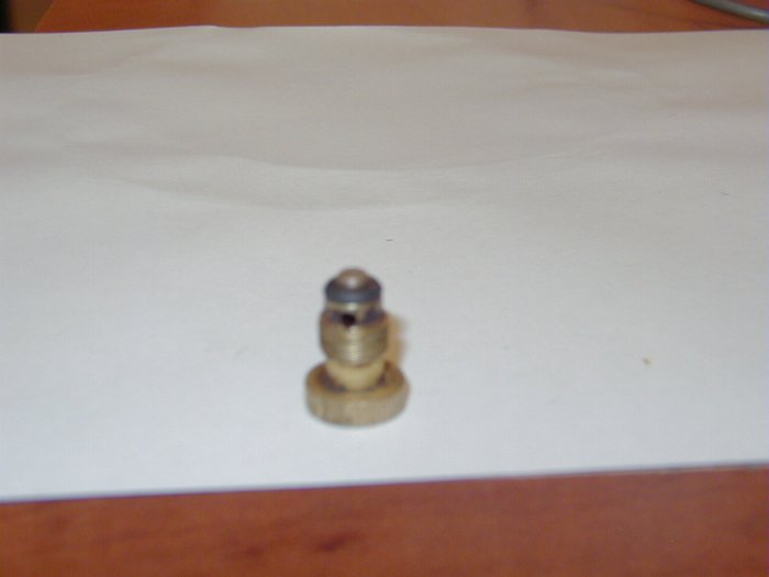

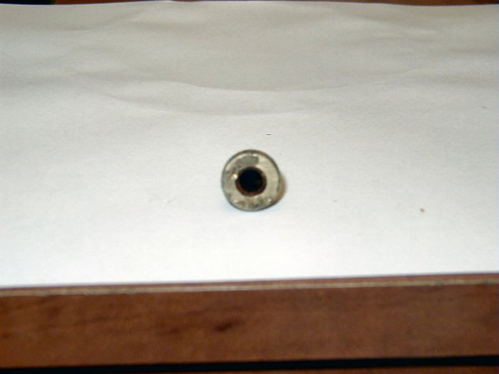

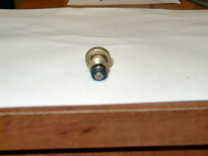

When you run the one that works , when it gets up to cut out pressure does the switch hiss when it cuts out, as its then that the pressure switch is supposed to unload the pressure from the compressor discharge pipe.
