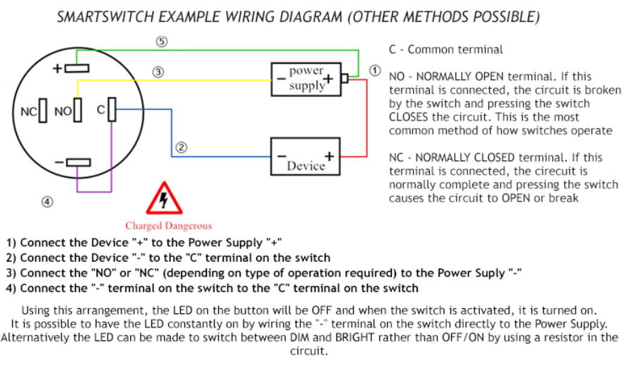

As part of a small project, I need to wire this switch which will be fed 9V DC.
https://www.ebay.co.uk/itm/SmartSwi...var=422821608796&_trksid=p2057872.m2749.l2649
The battery will have just the two wires, but as you can see, the switch has 5 x connectors on the back. Presumably I'll need to bridge some of the terminals...but which ones?
