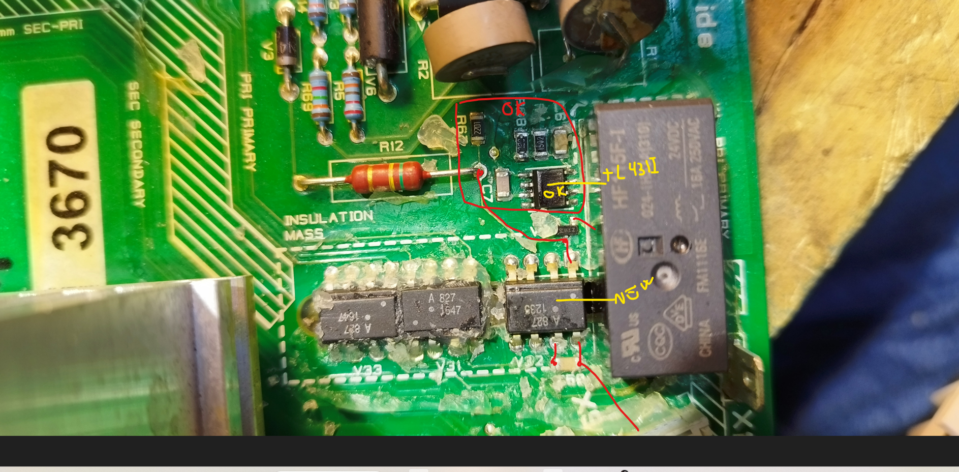

Hello everyone, I am writing for help with my Kemppi evo 200 MPLS, it is presenting error E 3 according to the manual, it is Network voltage too high, but the network voltage is 219 volts. stable,
1- When the machine is turned on, it is immediately in that state
2- If I turn it off and turn it on again, it keeps giving error E 3 and then it turns off.
3- It remains in that state without the possibility of unlocking.
4- It does not let you enter the Setup since they keep the error E 3.
5- Detect that the problem is in the Z001 main circuit card and rule out the problem with another main.
6- I have another similar machine and it works without problems, with which I detected the faulty card.
I'm stuck, I don't know where to attack the problem, if you could help in the repair I would appreciate it.
