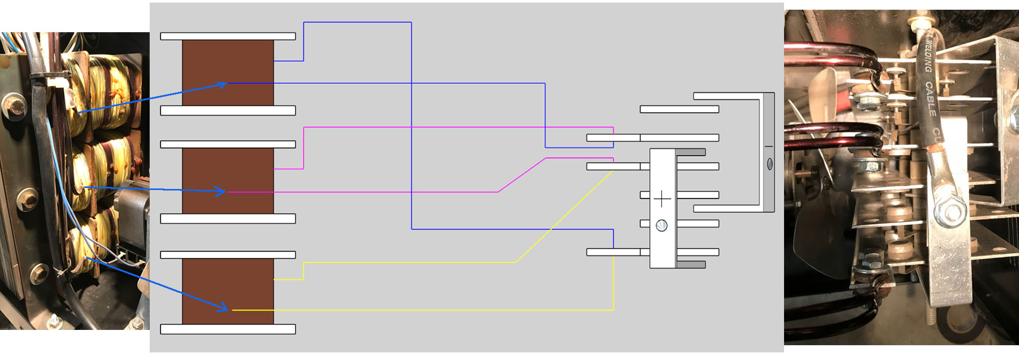

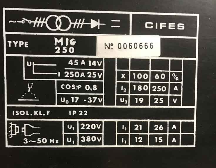

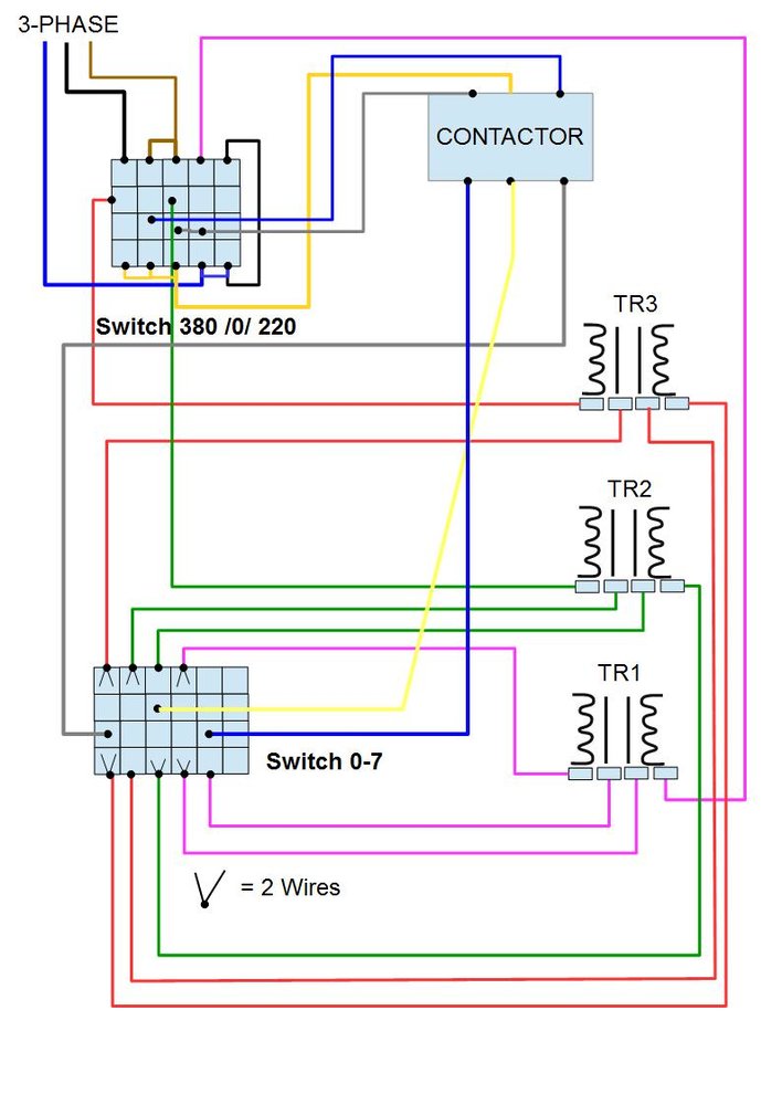

Your open-circuit voltages are very high - about twice what I would expect, and the drop when actually welding is also large ( especially for a 3-phase machine where three secondary windings are sharing the current load ).

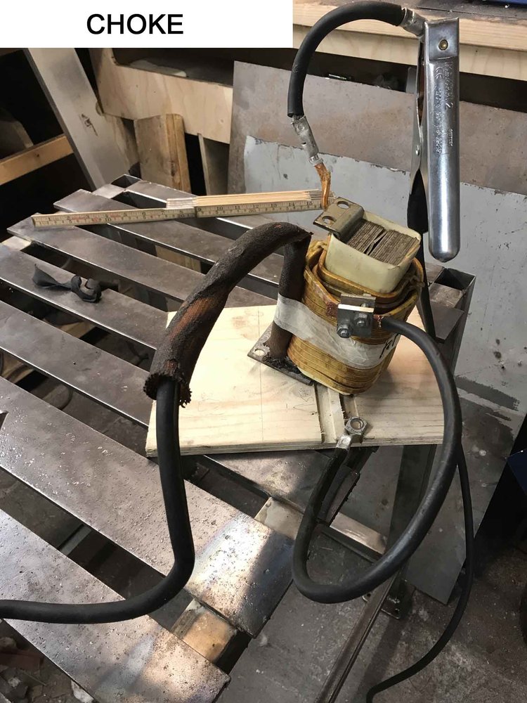

I have no experience of taking MIG inductors out of the circuit, they are just "there", and I don't have large welders that offer a choice of inductor taps. I would have said that a "machine-gun" effect is caused by voltage that is too high or wirespeed that is too low. Often wirespeed is turned up until the wire is pushing the torch back from the workpiece, then down a little from that.
Another thread about a homemade inductor - this time using the core of a microwave oven transformer ( "MOT" ), and winding it with 16mm2 welding cable:
