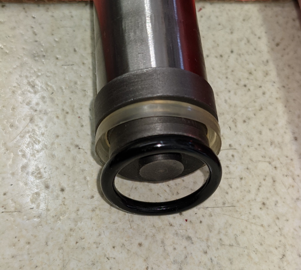

Hydraulics is not really my forte, can anybody help?
The ram from my Clarke engine crane has decided to pack a sad - replacement seal kits are no longer available.
I know I should just buy a complete ram as they are not that expensive, but that seems pretty wasteful - and i suspect it probably won't be much better made than the one I have.
This one hasn't had much use, but in typical Chinese fashion was full of swarf and ****e, which probably contributed to its premature demise.
I've tried a seal specialist who told me "none of them were available and they must all be made special".

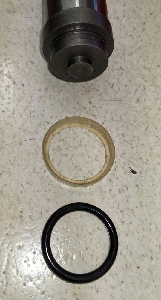

I've since managed to identify a source for most of them as they seem pretty standard.

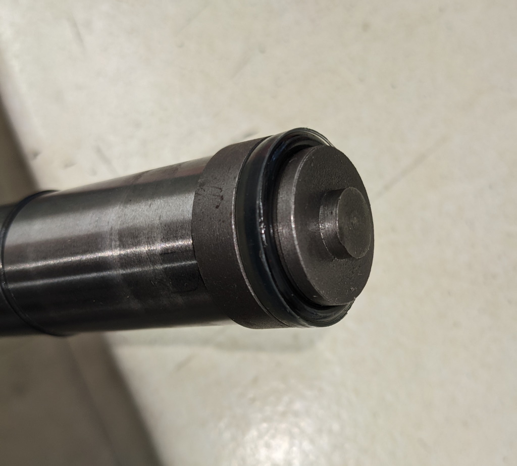

However, this one has me stuck. It looked like a loaded U-cup to start with - but as I took it off it wasn’t. Are these a common style?
If not I was contemplating replacing it with a standard U-cup style.
The problem with that is the shaft measures 23mm. Cylinder bore is ~ 30mm. U cup seals seem to be 22x30 or 24x30.
I have found a 22.34 by 30 but only from china, could be made of PU or cheese, Who knows. I guess 22x30 would be better but not sure if it would "stretch" that much
This one doesn't actually seem that bad, but I figure I might as well replace it while I'm into it.
