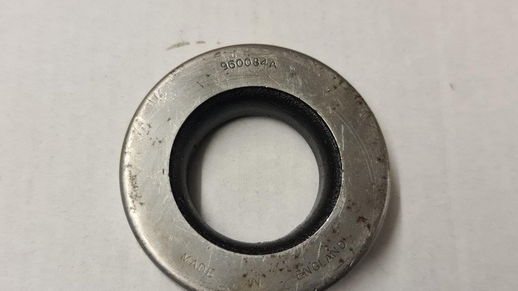

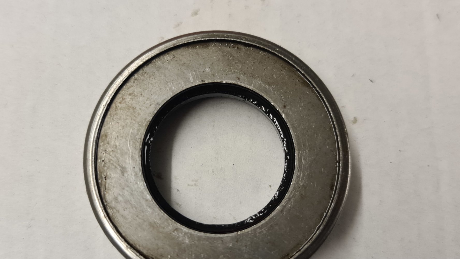

Ring 'em up and describe what you need - OD, ID and depth/thickness and what you are trying to do - keep oil/grease in, dirt out etc. If they haven't got one of the right OD - well you have at least one lathe - make a spacer.
Seals, like bearings, O-rings, circlips, c-rings, nuts, bolts, screws, etc are made to international standards, so there is likely to be a suitable seal of the right size on a shelf somewhere.
