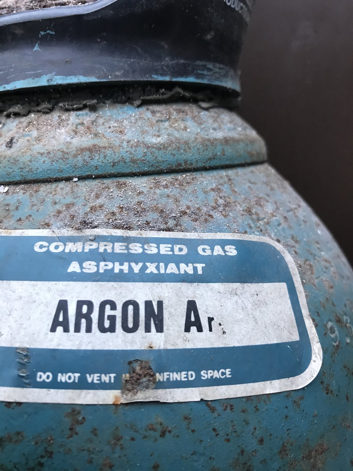

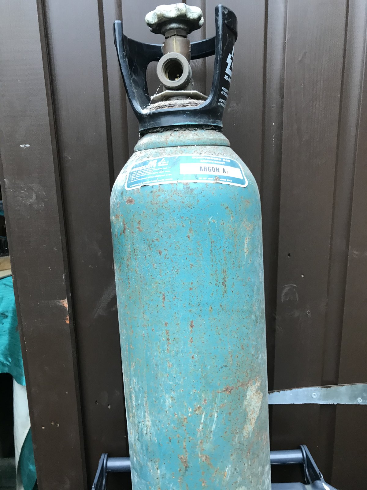

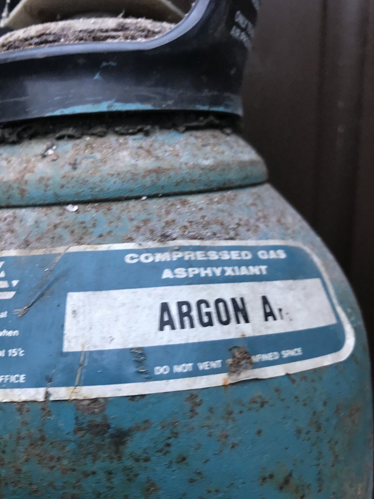

    just went and took pictures of the bottle 4FBBBB7E-0C1C-4653-86A2-FACB0A2A6EAD.jpeg 8E7784A0-7A26-4C05-880A-9A49B687CDDD.jpeg 8E7784A0-7A26-4C05-880A-9A49B687CDDD.jpeg
  8. Wozzaaah
    Wozzaaah The wizard of woz Staff Member
    Messages:
    14,388
    Wiltshire, UK
    That's pure argon, no good at all for mig welding.
    You need either CO2 or Argon/CO2 mix.

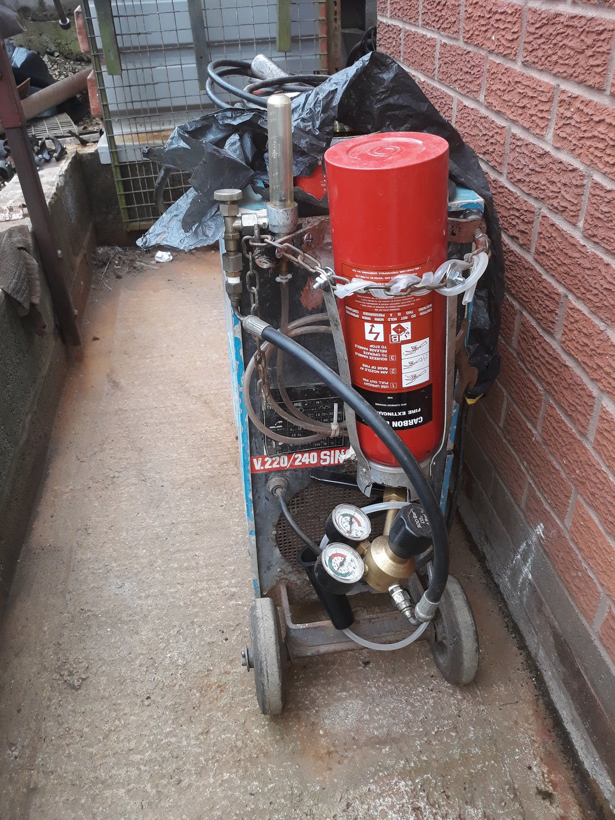

    Another option would be to use straight CO2 only. This will require a different connection on the regulator (that has come with your welder?) You could then use pub gas (make sure it's straight CO2 and not a beer mix) or a CO2 fire extinguisher turned up side down works as well. See pic (bit crude but cheep).

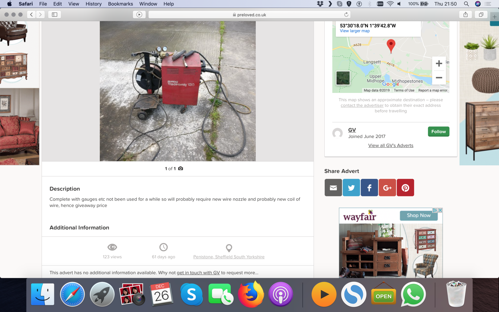

    hi mate its a old mig welder as its my 1st one i got it extremely cheap this is the picture mate Screenshot 2019-12-26 at 21.50.24.png
  18. mike 109444
    mike 109444 Member
    Messages:
    4,127
    uk Bristol
    Nice sturdy unit. So long as works then should be a work horse. Main thing to watch for is having the spool of weld wire "external" it will tend t rust if condensation settles on it or grinding dust gets on it. Use an old bead sheet over the machine (and wire) to protect even if kept in a garage/shed. Once you get use to using it you will be able to whip the spool off and keep it bagged (and in the dry) between welding jobs.
