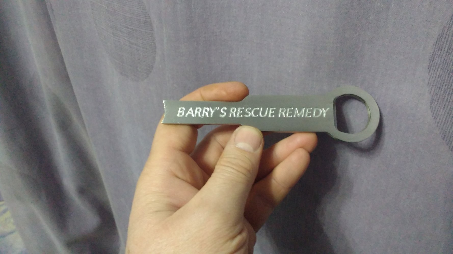

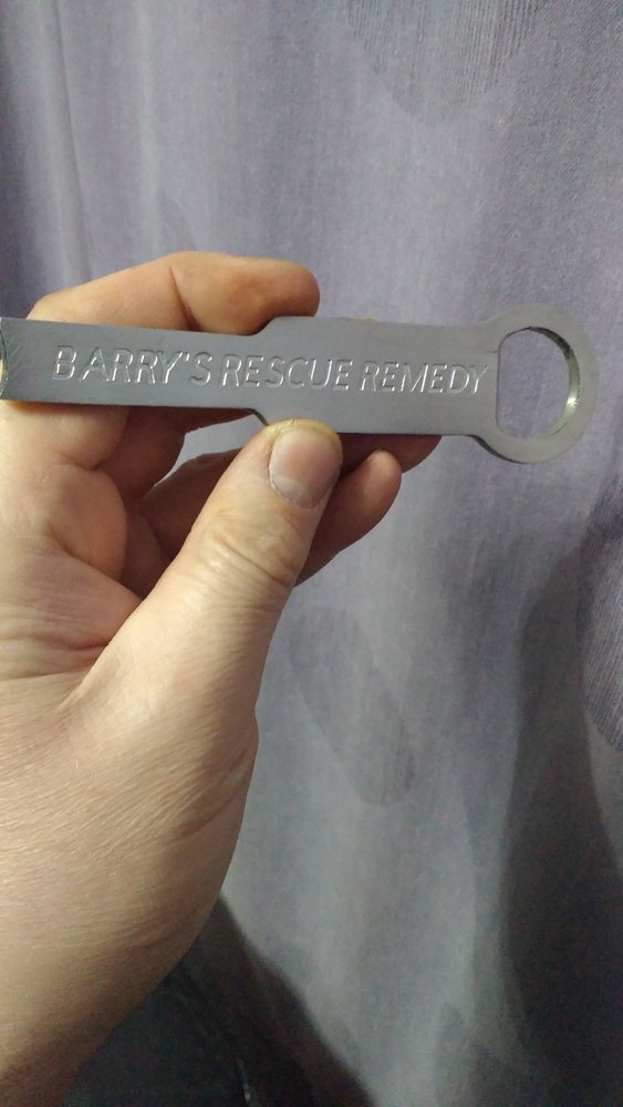

Here it is in all it's unfinished glory with a 3D print of the missing helical grooved element. Thanks to all those who helped, couldn't have done it without you.

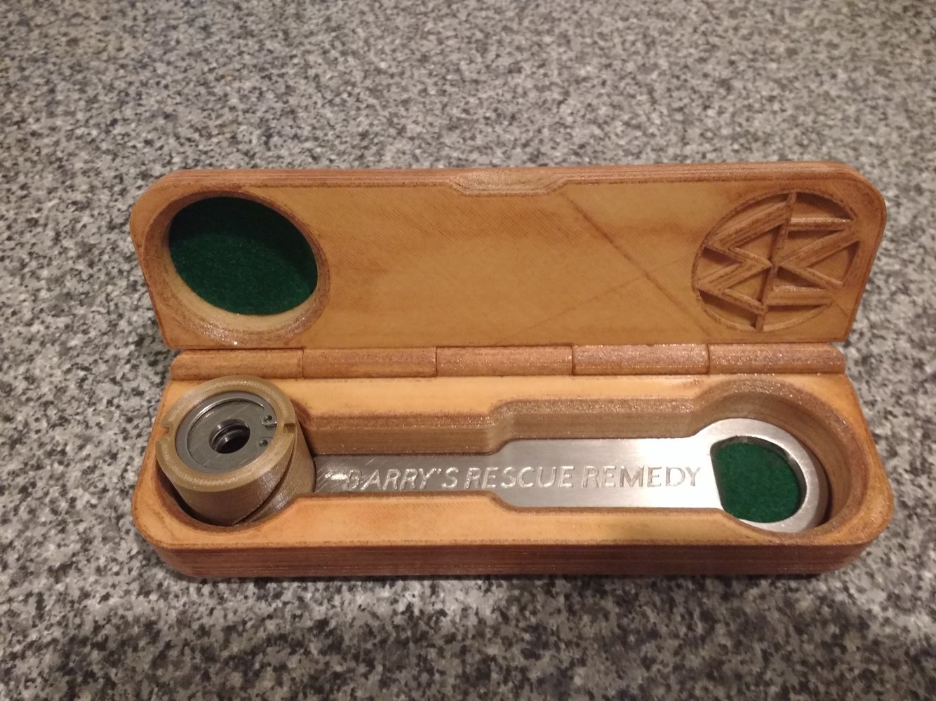

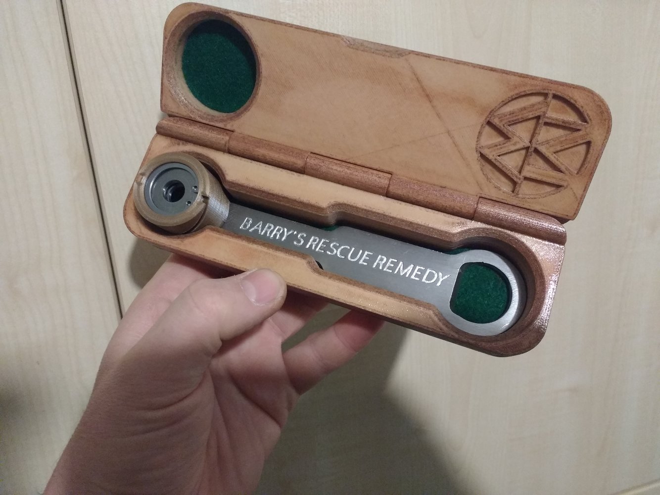

3D printed case, embedded neodymium magnets. This done by my lad:

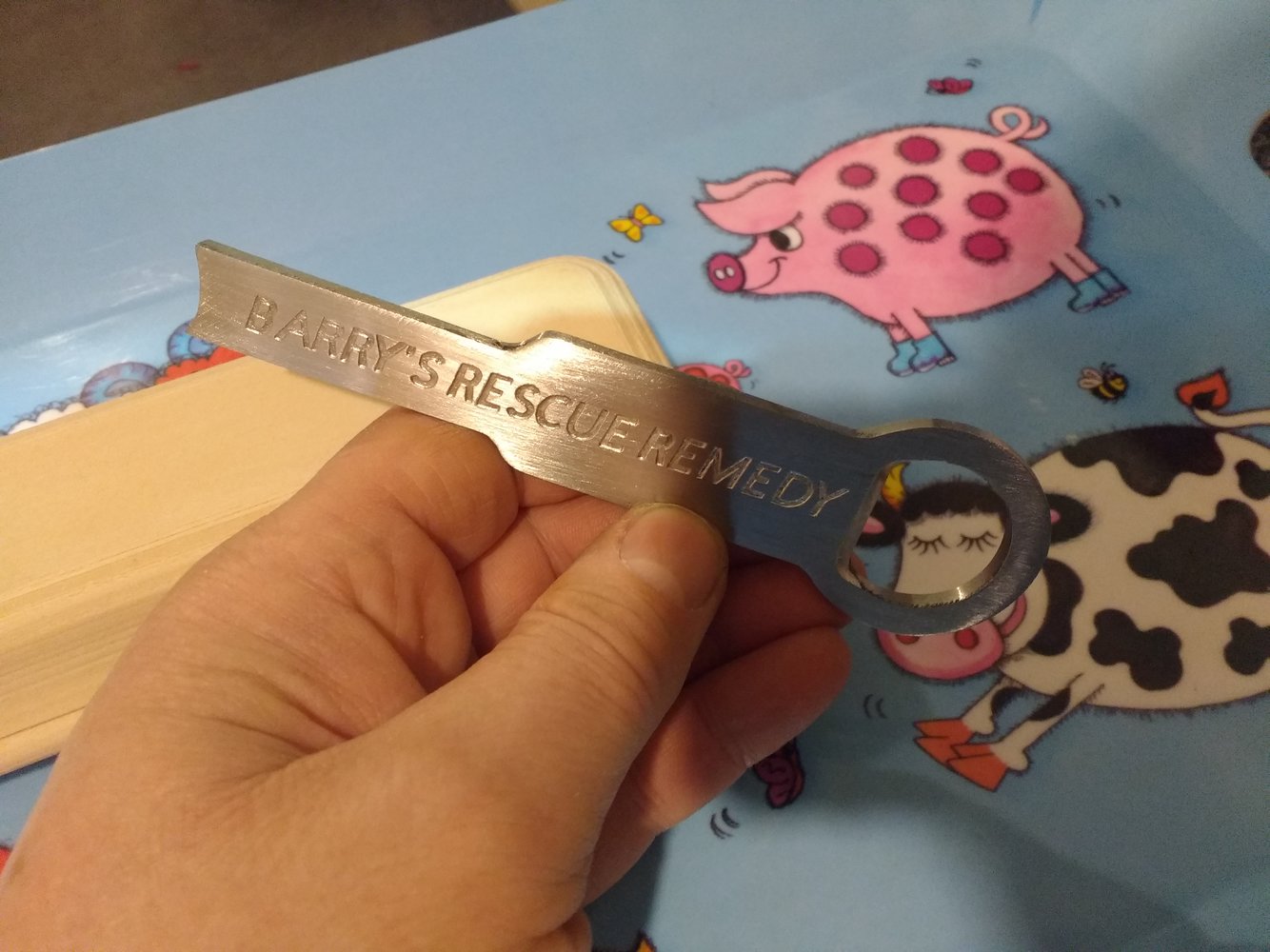

Salt water etching on 316. Approx 90 seconds per letter with a cotton bud and a 5Ah Makita battery:
