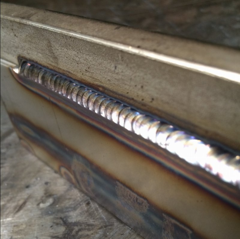

Ok, yeah, I'm new to ss, still learning the balance between amps and speed speacialy when freehanding. Btw no offence taken, it realy is an ugly weld! That being said, its getting better but I dont like to settle for less than great. I pulled my tungsten out 10-15 mm, upped the gas to 18ish. Theres no way I can get a good angle in there, so should I melt through the flang edge and push lots of filler? Any advice along with amps and speed would be very great.With a long stickout I would probably nail it without too much difficultly, however (and with no disrespect intended) looking at the existing welding I would say that the op is going to struggle,
3 mm. I'm working with a 5 ceramic.With not knowing what that cap does if it was a butchering type of job I'd cut a hole in the bottom like the others say before hacking at the cap hole. Incase there is a rubber seal or something in the cap that sits flush on the top surface . You might create a bigger problem if it doesn't seal properly when finished. I'd like to know the distance he's got between the two items in the tightest spot. I could replicate the joint at work and share some advice. It really doesn't look that tight to me.
SS tig is difficult and unless you've got the time in can be a battle to get the desired finish. It doesn't wet like MS. Too low a current and it forces slow travel on your hand which in turn causes bad distortion. To high a current and you end up burning the chromium out of the weld and parent causing a grey dull weld that's about as weather resistant as steel. I do bits and peices which is enough to keep my hand in and achieve acceptable results. Tig Paul does it day in day out and his ss tig is nothing less that admirable. Check out stainless steel projects on here to see some of it.Ok, yeah, I'm new to ss, still learning the balance between amps and speed speacialy when freehanding. Btw no offence taken, it realy is an ugly weld! That being said, its getting better but I dont like to settle for less than great. I pulled my tungsten out 10-15 mm, upped the gas to 18ish. Theres no way I can get a good angle in there, so should I melt through the flang edge and push lots of filler? Any advice along with amps and speed would be very great.

Tighter than it looks. What's the height of the round part.The flange is 60mm around, the wall is 3mm and the distance between the flange and the back is 2.5mm.
