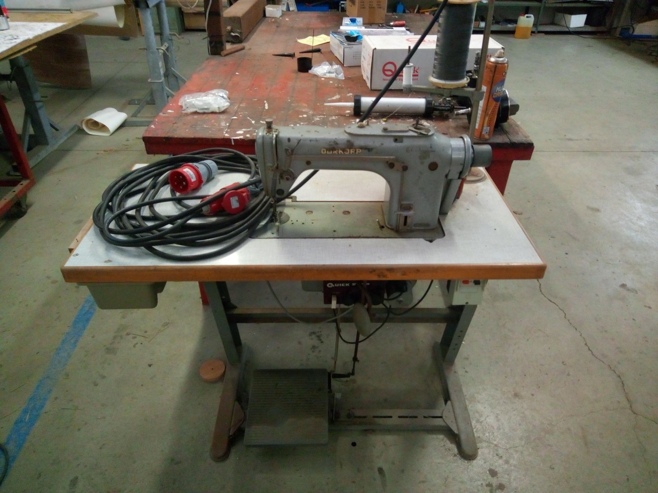

Sorry, took some photos this morning, been busy.View attachment 273910View attachment 273912
That's a beast
Bloke got rid of it as he lost his 3ph supply (moved premises).That's a beast![]()

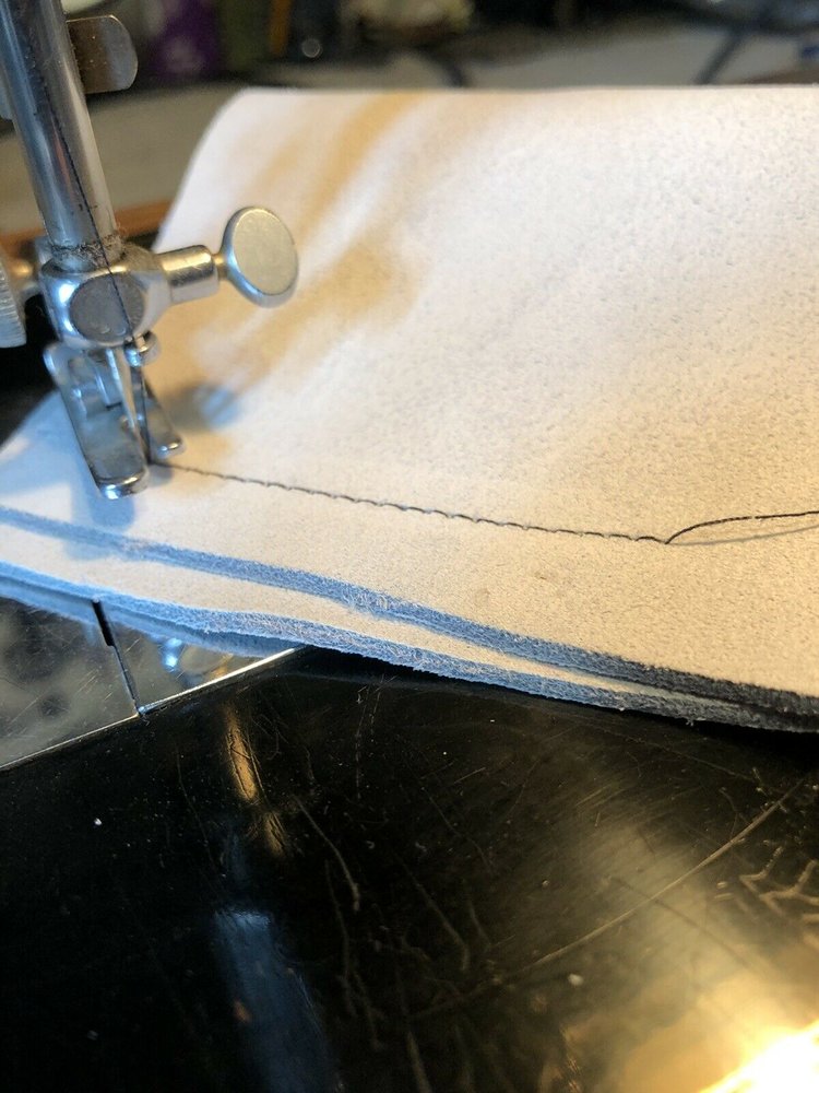

The 201 will however stitch 6 layers of denim, or leather as shown below (with a leather needle) but there's no zig zag:
